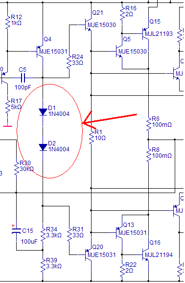

THIS output stage. For your consideration.
Disabled Account
Joined 2007
Playing around with difference output stages, I tried this.
Comments? POS or worth trying?

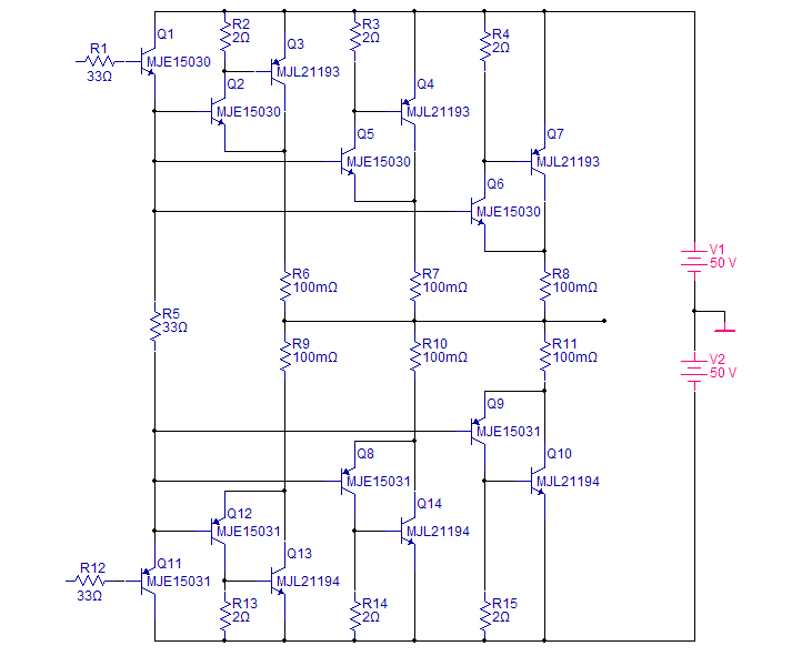

You seem to be burning a lot of power in the drivers. Idle alone appears to be around 70 watts total in Q2,5,6,8,9,&12 for a standard AB output condition. Can’t tell were you want to idle the actual outputs at from the schematic given, that would make for additional heat as well. Better have some big heatsinks if you try it.
Disabled Account
Joined 2007
It was actually for a class B amp.
My idea was (probably silly) to have these driver transistors share about 10% (or more) of the load.
It works fine in the simulation, but it's nice to have those who are more educated give an opinion.
Am I wrong in thinking it has some voltage gain? Seems so in the sim.
Disabled Account
Joined 2007
These bias generator diodes (circled in pic) will track if mounted on the drivers heat sink, right? Should the drivers be mounted on a separate heatsink from these CFP outputs?
It's a little confusing, since I'm using driver transistors as outputs, but I'm referring to the actual drivers.

look at the first CFP pair, Q2, Q3 & R2.
The Vbe of Q3 is about 600mV.
R2 sees all this voltage and tries to pass 300mA. That's your problem!
Change R2 and all the others from 2r0 to between 100r to 200r.
If you want to run the drivers hard, to keep up their speed, then maybe try as low as 30r.

It is my idea here to use these "drivers" as outputs, that they would share a substantial part of the output current. That's the reason for the low value collector resistors.
Simulation says..(that sounds Richard Dawson from Family feud "survey says..") that it will work. Simulation actually says it will work very well.
You know the simulator is my new best friend. ;)
I attach the full schematic to put things in context. This would be a subwoofer amp. Maximum 280 watts into 8 ohms.

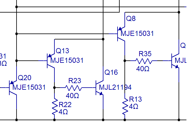

Going back to the simulator and changing the collector resistors to 4 ohms works a bit better. I am now seeing ~78mA through these drivers at max output.
The interesting thing is these drivers maintain a near constant current as the output power drops. The outputs (MLJ21193/94 will drop below these at low level.
This is what I see from the sim.

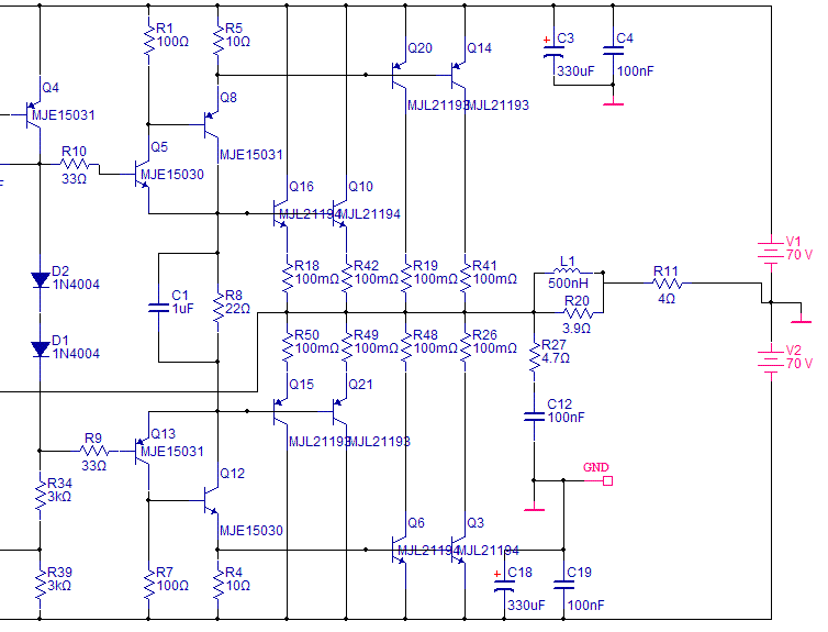

Dear MJL21193,
I know it's a while ago, but just stumbled over this thread and felt a comment coming on...
The first of Ur outlined topologies looks the best to me, providing you add some say ntc's for temperature compensation in order to prevent thermal run away.
The second topology compared to Bryston to me looks like having all possibilities of instability both thermal, current hugging and stability wise.:eek: On the second pair's of MJL's the resistor's should at lest move to the emitter side of the transistors in order to prevent some current hugging.:flame: Some base resistor on all MJL's would probably also help with linearisation.:cool:
Just some 'food for thought for U' with the best intentions and regards:)
