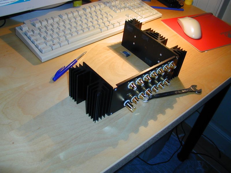

2Bak said:I'm building a three channel CG for cinema add-on. LM3875T. I've got all the parts. I use this circuit except no pots. Same case for PSU and amps.
My initial plan was to use one toroid 300VA 25+25 I have to power two channels and a then buy another 160VA 25+25 to power the third channel. I use two bridges per channel.
But what would happen (output power, performance) if I used only the 300 VA toroid for all three channels in our opinion? Would that not be adviceable?
My room is very small, speakers are efficient and I don't play loud when I do cinema, so I was thinking about this...
What's your opinion ?

Looks good, I was thinking of doing something similar, but wasn't sure how to manufacture the front, back, top and bottom... Plus, I wanted "raw" heatsinks and aliminium pannels, how can I remove the black from a heatsink? I really want to make one of these.... I can use the metal working tools at school.. Yeah, yours looks great..

Skinnyboy[/i] [B]Looks good said:Skinnyboy,
black is better than "naked" metall as the heat conductivity is greater when the sink is blak
/Peter
The heat conductivity should be the same or very close. There is a slight difference in heat emmission and absorbtion but it is so small that it doesn't matter. You should go for the look you want and not worry about the colour of the sinks, IMHO. Usually the GC will not produce that much heat anyway so the slight performance edge of the black anodized sinks will not matter that much. If you decide to strip of the black from your sinks than the surface smoothness is far more important. It should be smooth.
I am not sure what a "slight difference" means here, but the actual difference is about 11%, for anyone who would like to know, with the black finish being more effective.
Also, it is incorrect to suggest that a 'smooth' finish is better for heat transference with heat-exchangers.
With a rough surface, the surface area exposed to the air is slightly greater as a result of all the small 'hills and valleys' (with say a sand-blasted finish, it could be almost doubled), and this will tend to marginally improve heat transference, especially with 'forced' cooling by fan.
However, far more importantly, any 'polished' metal surface will reflect heat both ways, outwards from external sources, *and inwards* from within the metal sink, which results in the surface temperature of the sink being lower, and consequently reduces the heat being transferred to the air surrounding it.
The problem I see here is in effectively removing a 'hard anodised' finish, which most heatsinks are, unless the fins or whatever are few, and not very deep.
The anodising, whilst being quite shallow, is very much harder than the substrate, and any abrasion or acid etching attempted, is not likely to be very effective.
In practice, once the hard surface is broken through (and this occurs unevenly with highly-contoured heat-sinks) the exposed substrate is so relatively soft that it is then eroded at a vastly quicker rate than any remaining anodised finish, and the end result is usually a mess!
Sandblasting some sinks which are not highly-contoured, can be effective, but from my experiences, I would leave well alone if you care about the appearance of equipment. It is too easy to erode the thin heatsink fins away and destroy their otherwise 'uniform' appearance.

I am sorry to appear pedantic here, but you seem to be rather misinterpreting what Alpha say in this quote, and for the sake of others, I will clear this up.
They clearly state "When air velocity is low" (i.e. non-forced air by fan, for example) "black anodised is *better*."
As I said above, it is generally 11% better, I can assure you. Whether or not this is significantly different, I haven't passed any opinion on.
What they also go on to say agrees entirely with what I have indicated, in that the black sinks *transfer* heat better *both ways* i.e. they 'get rid' of heat, but also 'pick up' heat from any external source better, as do rough finished sinks, compared with polished ones.
In the usual cases we are concerned with in audio, and certainly with these 'external to air heatsinks' on the outside of equipment, the ambient temperature will (should be!) much lower than that of the sink, so the heat will be transferred away from the amp better with black sinks than with silver.
What Alpha are referring to here is a situation (perhaps inside an amp) where a closely-located heatsink running at a much higher temperature, is *giving off* heat which is then picked up by the heatsink we are concerned with, and in such a case (because of the higher heat transfer of black sinks) the heatsink under discussion will pick up *more* heat than otherwise.
As they say, "the choice must be made depending on the environment" i.e whether the ambient temperature is lower (normally) or higher, but it has nothing to do with the *efficiency* of heat transfer, either way, which is related to whether the sink is black or plain silver, and to some extent its surface finish, as I said.

Thanks for the 11% number. I have never been able to find that number. As far as I understand that would be for a flat surface and the difference in radiation. That is not the same as heatsink with fins and the difference AFAIK (numbers given to me by two different heatsink engineers - I tend to believe them) is in the region of 3-5 % which in this case, IMHO, as well as a possible 11 % is to small to worry about.
As for the smooth surface I would say that there is a big difference for convection compared to forced cooling. Generally the uneven surface benefit is true but only for large surface variations. When we are talking, as you mentioned, sand-blasted surfaces the contrary happens and molecules of air get stuck in the uneven surface and effectively act as insulation. That is why turbulence in forced cooling increases efficiency a lot as that breaks up the insulating layer (laminar as mentioned earlier).
For the purpose of this example and DIY amplifiers in general I still maintain that the colour is not that important.
