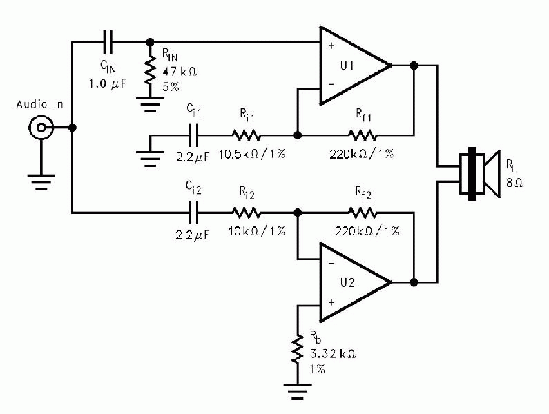

Adjusting gain
OK. Using the "bridge formula" and the 220K/10K gain as references, the values I got to were the following:

Output offset voltage.
Carlos,
I see that you have recalculated for Av=22, however you negelected to consider recalculating Rb for proper compensation. There exists the possibility for DC to be present on the output even with the input capacitors because the op-amp's input stage biasing current flowing through external resistors produces a DC input voltage causing DC to appear on the output. I will admit that this is probably going to be a small value (mVs) and with the bridge configuration the effect will be negligible to the load, but I think the key thing here is to minimize the DC on the output so that only the "music" signal remains. Feedback also effects the output offset voltage.
Build it, measure the DC values of the circuit and adjust the components as necessary. I would even consider potentiometers for experimentation until I found values that worked best for your particular application. This would make it easy to balance the gains and to eliminate any "unwanted" DC from the output.

Re: Output offset voltage.
stadams said:
Carlos,
Well, that's exactly the point I raised on my previous mail. If there might be a way to get that value with some formula.
In the meantime a multiturn trimpot will have to do. Though I don't know if other adjustments will be necessary.
My guess is the inverted side should be DC zeroed first and then get going with the bridge.

Carlos,
I think that you have the right idea. By my calculations, the value for Rb should be ~9.5 kOhm. I would go with a 15-turn 20-kOhm potentiometer. And just for fun I would also use potentiometers for both Rf's to see what the effect of balancing the gain precisely would have on the circuit.
Of course this all sounds like overkill, doesn't it? Just point-to-point wire the design and play around with it. That is what I think the beauty of DIY is.

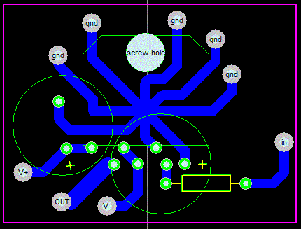

Oh, and speaking of pcbs, I threw together a board for the inverted lm3875 a week or two ago.. I've attached a picture of the design.. I'll post some pictures of the actual board a little later. The goal was to keep the wiring as short as possible. The chip mounts underneath the board, the pins have to be bent up. The caps sit on the top of the board.. The NFB resistor is the only point-to-point connection, underneath everything and resting just above the heatsink, soldered to 3 and 8.. I heard once that thermal tracking of components is a good thing--anyone know anything about this? I ask because I could have made it so the resistor was actually resting on the heatsink. There is a star ground for each channel.. I don't know if that's a good thing or not.
Anyhow, I'm still messing around with these chip amps.. I'm just reserving final judgement until I've done more testing.
