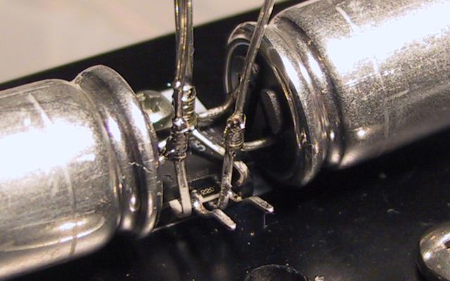

Has anyone here messed around with the LM1875 yet? Will the chip work with the same schematic as the LM3875? I got some today, and started putting together. It sure is nice to be able to use a SMD resistor for the NFB.
Any suggestions for the LM1875? I am just going to try it with the same circuit first.
Brian
(as for the photo, I wired the pins backward... pin 1 and 5 are reversed, and am in the process of redoing it now. I just like this picture, because you can see the SMD resistor.)

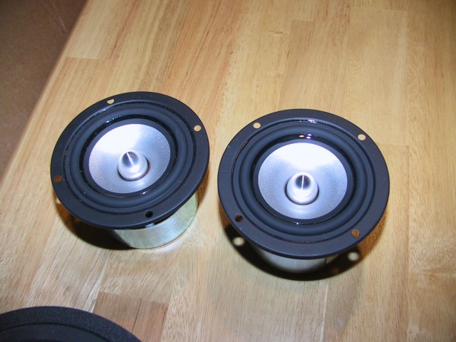

Stabist said:Hmm - any sugestion for small and economical DiY speakers - very very welcomed ...
Best start a thread over in the loudspeakers forum... how economical? Tangband 871 economical (~$50) or Jordan JX92 economical (~220)?
dave
Stabist said:Hmm - thanks Peter for sugestion - but I need a bit more portable ones ..
Oh - how economical - the GC will be under 50$ project - so also speakers would be very welcomed to cost around 50/75$ ...
Tangband w3-871s drivers are $12 each, and a good starting point. These should match your budget. I am building some speakers with these now, based on Jim Griffin's ELF 1.5 design. It uses 2 of these per speaker, with the bottom one cutoff above 1khz with a 1.5mH inductor in series with a 4 ohm resistor. The speaker size is 10.5" (H) X 6.5" (W) X 9.25" (D), and has a

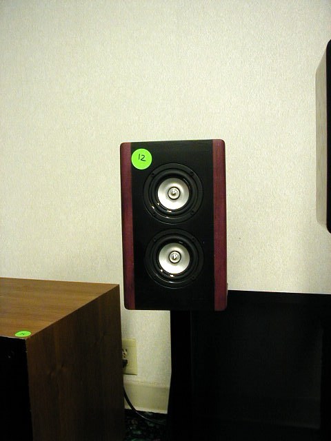

Bricolo said:what are the speakers you're working on, brian?
Here is the original thread talking about the TB speakers of Jim Griffin's.
IMHO the simple expedient of rear mounting the 0.5 driver could make these noticeable better speakers for a couple reasons.
