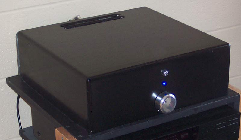

Here it is, my finished gainclone.
500VA 25-0-25 transformer
5300uF per rail
Nothing special as far as components go
MDF Box
Least number of components possible
24-step stepped attenuator

-Sheilding-
No, I havent encountered any issue with sheilding. At least nothing audible.
-heatsink-
The HS is inside, just below the openings. There are openings on the bottom to let the air flow through. I will add feet later, this will improve the airflow more.
