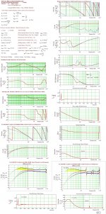

Here is a few easy calculations (cut and paste pictures') to ponder on, added here in order to clarifying the usefulness of the driver.. or not, if you disagree...
b :)

Thanks for taking the time to put all of that together, I appreciate it.
WinISD is fully capable of graphing cone excursion. I suggest you look around the menus on the charts. It is there.
I didn't see it in a cursory look through WinISD Pro alpha the other day; I've never done a simulation with it (just looked around a bit) so I'm not that familiar with it.
I did manage to find the cone excursion graph in it when I went back and looked more closely last night, though. Annoyingly, WinISD Pro does not work well on this machine; it crashes out with a memory access violation whenever I try to exit it. Not sure if it's the machine or the program, WinISD beta hasn't exactly been bug-free for as long as I've been playing with it (years...) either, so...
I did go back and recheck *every* menu in WinISD beta as well: WinISD Beta tour - YouTube I don't see that capability anywhere.
I'll have to familiarize myself with WinISD Pro.

Its a Windows 7 thing. Works fine on XP, but I've since upgraded.
You can use task manager to shut it down. A little inconvenient, I know, but IMHO its a decent enough program to give it 2 seconds of your time to close it.
