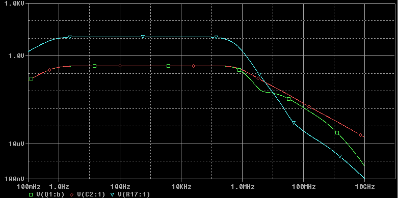

MikeB said:Hi carlos !
No, i haven't posted this one yet, but i do now...
It's a "simple" straight complementary design, using my standard
tripledarlingtonout, simple bjt-diffamp and cascoded vas. You can
replace the 3 diodes by a green led (matched upper/lower).
I think it sounds very nice, it has a warm but detailed sound,
thd at 20khz is ~0.003%. Openloopbw is about -3db@33khz,
openloopgain 1:5000.
Mike

Hi sajti !
I have built once a version without cascoded vas, but i must say:
cascoded vas rocks ! With cascoded vas you have 2 big advantages:
1, low openloopdistortion, means low thd with moderate feedback
2, a very detailed sounding amp, reproducing trebles without any effort
As i posted in another thread, i have no idea how to calculate RC-nets,
i get values by trying and checking with acsweep in sims...
My experience with RC-nets: They simply sound better !
Mike

Hi mike,
I have some experiences with RC nets. The RC makes stepdown in the frequency range. With the C You can set the frequency where the stepdown starting. And the R set how big the stepdown will be. It works well if You set the R to reduce the gain from the amount of the open loop gain, to the amount of closed loop gain (this reduces the gain only in necessary amount). The RC network set the dominant pole, but makes less phase shift than the common VAS capacitor.
When I tried to use cascode stages, I found, that it makes the highs sharp
sajti
sajti
Have you compensated for the "sligthly" increased vas-gain ?
Without resistors to gnd inside the cascoded vas you get incredible
high gains ! My amp boosted up to OLG of 1:400.000, with max below
100hz. This generates lot of tim. I had another circuit where cascoding
boosted the gain to 1:8.000.000 ! It does not get unstable because
the gainbandwidthproduct keeps nearly the same.
If i remove the 100k in the vas, trebles get exaggerated.
About RC, i think i need to study them a lot more !

I always use that resistors to the GND. Because I like the well defined OLG. So the gain was not much higher with cascode VAS.
I check the TIM with closed loop every time.
sajti
MikeB said:Sajti, i had similar problems before i changed feedbackcompensating,
but after changing i got a warm sound. Maybe cascoded vas needs
different compensating ?
Mike
This is true. Due the cascode connected VAS results different frequency response, You have to change the compensation too.
After my experience, I searched the net, and found one article which discussed this problem...
sajti
MikeB said:And what did the article say ?
It also discuss the sharp high frequency sound. And the owner think that this sound caused by the low input impedance of the upper device (common base connected). This low impedance results overload for the lower transistor (common emitter connected). The overload makes distortion.
They made some tests with series base resistors for the upper device. This reduce the gain, and increase the input impedance of this stage. They found sweeter highs, as they increase the value of the resistor. But as the gain reduced, they finally remove all the cascode parts, and keep the common emitter stage only.
So I never tried this. It's more simple to forget all the cascode, and use VAS transistor with low BC capacitance, and local feedback.
