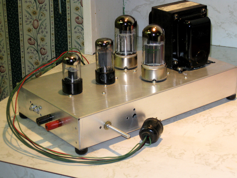

Thinking Outside the Box - A Different Kind of Triode Audio Amplifier
I built only the power amp & driver section for 'Proof of Concept'. Power provided by lab power supplies. The iron is Hammond, similar to their 1650N, but one-half the primary impedance.
Too many other projects finished here on the shelf, don't need another I may never use.:). Especially at this age. Time to goof off.
I posted an old schematic but just as easily could have changed the tube designators to the octals. Main point is that the cct works either way. Best part it doesn't oscillate.:)
For comparative measurements of D%, Etc check the Table A in 'Out of the Box' Part lll. The BQ7 family looks very good. Much better than audiophools would want us to believe!
