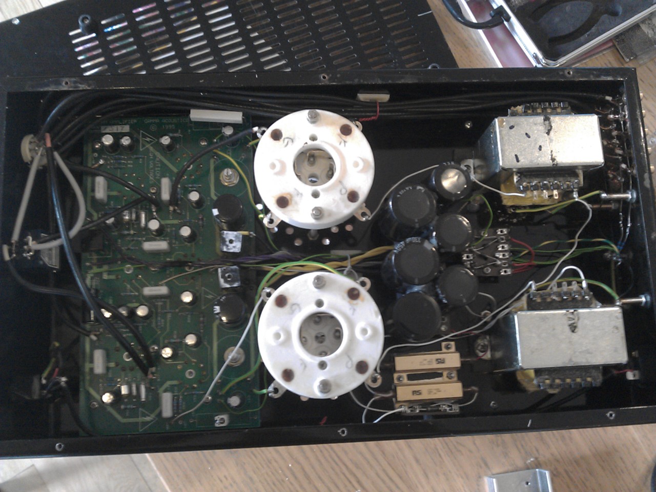

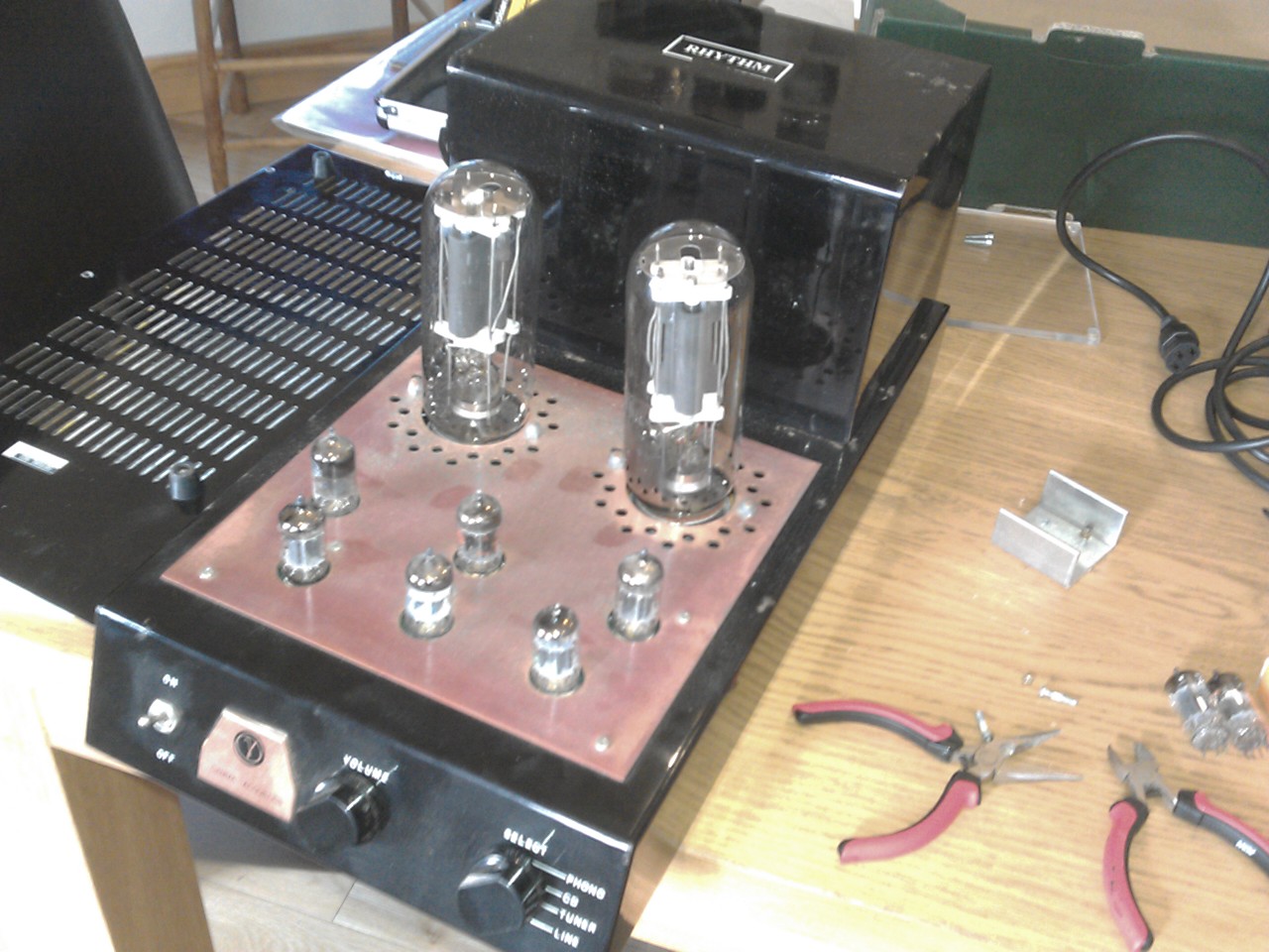

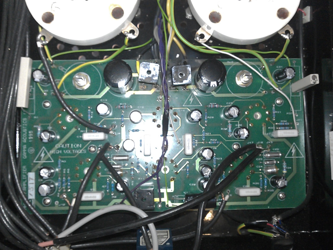

Well, I picked up the amp today. Substantial piece of kit alright. The amp is not working, some of the heaters aren't working, and there is a good bit of burning around the restifiers used for the heaters.It looks like the bridges are undersized or underheatsinked for what they were asked to do - you can see them in one of the pics below with the heatsink removed. The driver circuit is on a PCB and all the passives there look OK (except those heater rectifiers).
The driver circuit uses 2 x 12ax7, 3 x 12at7 and a 5681 I think. Those 211 valves are frickin' huge!!! All the main bits of hardware appear OK, so at least it won't (hopefully) cost much to fix. I also got a spare pair of 211s as well.
I took a few pics, but haven't even started to trace a circuit yet......

I meant to say earlier that the amp is a Gamma Acoustics Rhythm amp. Theres so little out there about these amps - 1 or 2 mentions and thats it!
Anyway I did some more looking tonight and sorted some issues and found more. First off, the bridges for the heaters were cooked. There was 1 bridge for each 211 and then 1 for all the 12''7 valves. The 5687 runs off AC heaters. So I replaced all those and at least now all the heaters were working. So then I decided to check the B+. I get 1050V at the plates of the 211s (which seems correct). But I had only a couple of volts going to the PCB you see in the pic above which holds all the input and drivers. So anyway long story short, the 1050V B+ is filtered down using a massive 50K 50W resistor and it had gone open circuit. You can see a the big resistor in the middle pic above (theres 2 similar sized ones together in the pic).
What the hell could cause a 50W resistor like that to go open??!? Its a worry!!!
Also, I've carefully (visually) checked all the components on the PCB and other than the rectifiers, there's no sign at all of anything overheated.
So I'm guessing that the input/driver circuits are looking for about 300V or so. That would mean that if a 50K resistor provided a drop of ~700V, the resistor is throwing off ~11W or so.
Any comments? To quote pink floyd "is there anybody out there?" :)
Fran
I don't know the order of failure, but with heaters of the 211 off B+ could have been well above 1050V, so the power dissipation of the dropping resistor inadequate. When you replace it resize it to cover a short, three 150K 20 watters ought to do. Before you build something “better” try to get that amp working and see what you think. Sounds like you are close.

I don't know what the original design point was for this amp, but seems similar to the airtight one that also uses 12ax7 and 211. I think there's a phonostage in this amp - that's probably why the extra valves are in there. Anyway next up is to get one of those resistors and try it out. It just seems strange that someone would design and build a monster amp like this but use such undersized rectifiers.
Anyway, let's see how it works out. It hasn't cost me anything so very little to lose!
Fran
I have a Gamma Acoustics 300B amp( I think it is called "space" but it is buried at the bottom of a cupboard) stored at my home belonging to a friend of mine. It was giving trouble so I had a look at it for him. Build is rather weird; all small component are covered in heatshrink and are simply strapped between rather crude rails and the valve sockets themselves; totally different from the pictures posted.I get the impression that Gamma acoustic,whoever they are, tried a different construction technique every time they built something. It ate 300B's at a fantastic rate. It has a very smart case and this plus the ironmongery are the only thing I would bother keeping. If and when I have time, I will completely rebuild it; 2 new 300B's every few months is too expensive. The valve lineup is 5U4G, 6AS7, 6 X 6SN7 and a pair of 300B's. Output xformers are also peculiar and look as if they have been made from some sort of kit.
Well I found a few 5w 150k resistors in the parts box and stuck them in for a quick check. I now get a b+ of 400v for the drivers which would seem about right. Those dropping resistors are cooking though. They're not good enough for long term but it has allowed me to have a quick listen - sounds good alright (workshop system, but it's clean and deep).
I ordered parts today so should have better information when I get those in.
On the build quality: physically it looks good enough, but those rectifiers are the weak point. Also, there must be a more elegant way of producing 400v from 1100v. Dealing with heat is what has affected this amp I think. No wonder it was unreliable.
