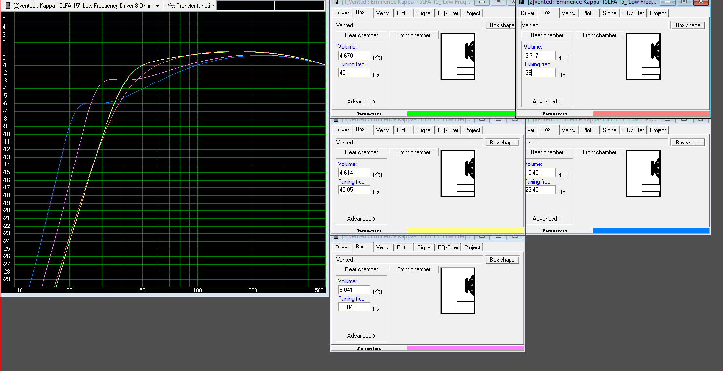

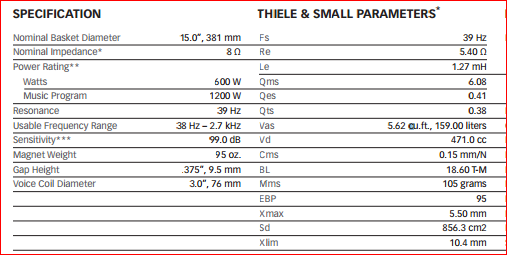

Looking into woofers. Love to go with something James Bee Lansing-esque but too much $$. I'm looking at the Eminence Kappa 15 LFA. This is the stamped steel cheapy, but I like how it models better than the 'pro' version, and i personally am not bothered by the basket material. 4 to 5 cu-ft is probably my limit size wise.
Let me know what you think. At first the 99dB rating scared me, but it looks like that's the average including that nastiness that will get filtered out. More like 96-97dB. These are all the alignments (QB3, BB4, etc) from winisd pro with just the software spitting it out - no manual intervention. I am NOT looking for 'subwoofer' performance. Just 'cracking' music!
I think it looks like a contender - you?

Even if you are not an eminence fan (I am), do you see any issue with how the Kappa LFA models for domestic non-sub use?

They are more sensitive, but they don't quite go as low. There actually seem to be more choices for a higher performer, with the same frequency response, in the same size box as the 15LFA - if you go to an 18.
The only thing "wrong" with the 15LFA is the 10mm x-mech. Would be nice to have a bit more headroom before hitting the stops. If you're using under a 200 watt amp that probably won't be an issue.

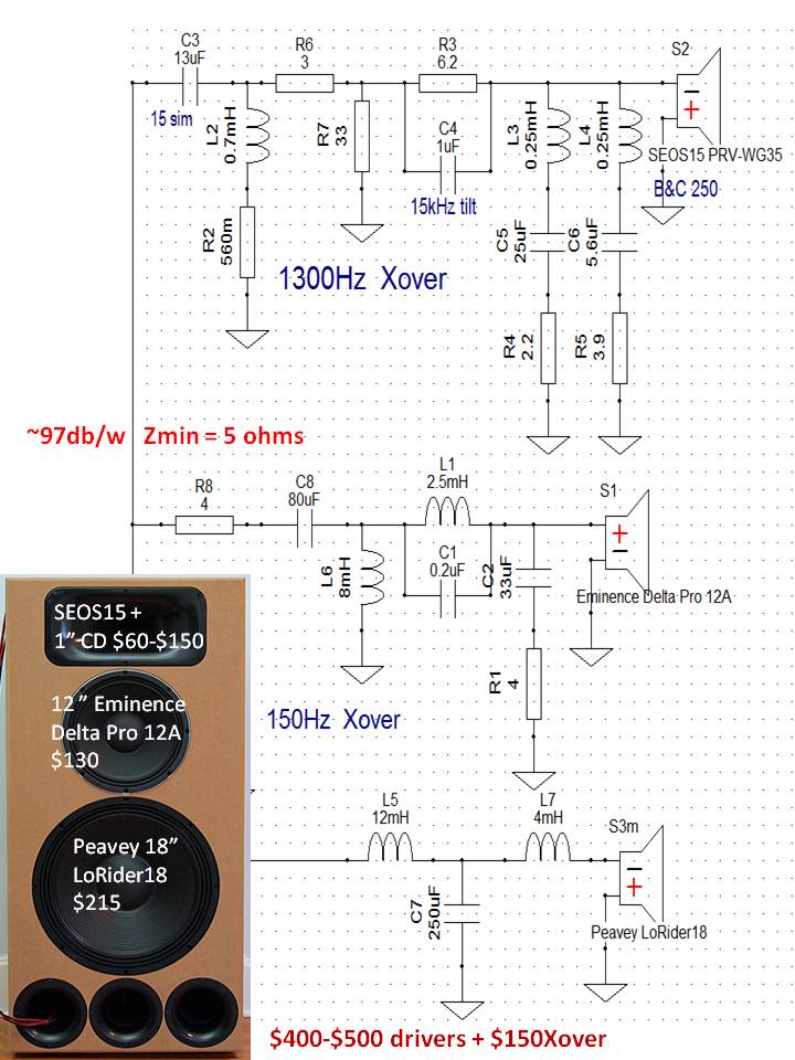

1) You can spend more money on better drivers by selecting a proven combination of drivers and proven(measured) crossovers. Crossovers cost ~$150-$250/speaker
2) Successful size and efficiency combinations:
**18" woofer + 12" midrange + 1" compression driver + 15" or wider horn ~ 1300Hz crossover
**15" woofer + 10" midrange + 1" compression driver + 12" or wider horn ~ 1500Hz crossover
3) Start at 20kHz: Study and leverage the extensive Econowave engineering by using a proven:
- horn + compression driver + 10" midbass + crossover.
OR
- horn + compression driver + 12" midbass + crossover.
4) Cabinet designs with baffle diffraction control are still important with horn speakers
5) Room placement and room effects should be modeled from the start

JBL uses 18" woofers in speakers with 10" and 12" midrange drivers. The large cone area of an 18" woofer provides high 97db efficiency bass with modest distortion generating displacement. The $210 Peavey 18" LoRider woofer models well in 8cuft ported, or sealed with room equalization. Spend more of your budget on the important midrange and compression driver tweeter+horn.

you are suggesting a much bigger system than I care to handle.
But I see an argument buried in there for a 2 X 12" + horn 2 way <or> 2 1/2 way.
and again - thx to all for the posts
With the right 18, it wouldn't necessarily be any larger than a 15. Something that will do 40 hz f3 at 96 dB/w will be about 5 cubes, regardless of woofer size. Even if it's two 12's.
12 inch midrange probably overkill, unless you're crossing to the woofer under 150 hz. Which would be silly with a passive crossover. An 8 or 10 would do fine, and let the CD cross where it would be happier.
