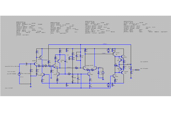

Probably best to ask a question like this in the Yahoo LTSpice user's group at https://groups.yahoo.com/neo/groups/LTspice/info Upload your circuit file to the "Temp" folder in the "Files" section. (Attachments aren't allowed in the "Messages" section.)I have been modelling a circuit using some of the Cordell transistor models, but all of a sudden the program tells me it cant open any of them, has anybody else found such a thing happening?
rcw
I haven't done anything with LTSpice for a couple of weeks, but I see there was a new version released on Monday of this week. If there was a problem with that version, it probably would have been mentioned in the user's group, and almost certainly corrected by now (3 days after release).
Your symptom sounds like a problem defining search paths. Years ago I tried to do elegant and impressive things with the LTSpice search paths, ".lib" command, etc, but decided the results weren't worth the effort. I have added quite a few models - including Bob Cordell's transistor models - to the components libraries ("standard.bjt", "standard.dio", etc) so I could easily specify them while composing a schematic. For seldom-used models, models of uncertain accuracy, and models that have been tweaked for a particular investigation (e.g., "best case" or "worst case" device behavior) the often-repeated advice in the user's group is to paste the model directly into the schematic as a SPICE directive. That guarantees LTSpice will find it, and give it precedence over any other model of the same name in the search path.
(Yeah, that really clutters up the schematic. Would be nice if LTSpice had a separate "Models" tab where you could park the models you want to use, without having them eat up so much acreage on the schematic itself.)
Dale

Not working for me now either. Opening a schematic using the Cordell model zooms in on the text include statement with nothing else displayableI have been modelling a circuit using some of the Cordell transistor models, but all of a sudden the program tells me it cant open any of them, has anybody else found such a thing happening?
rcw
