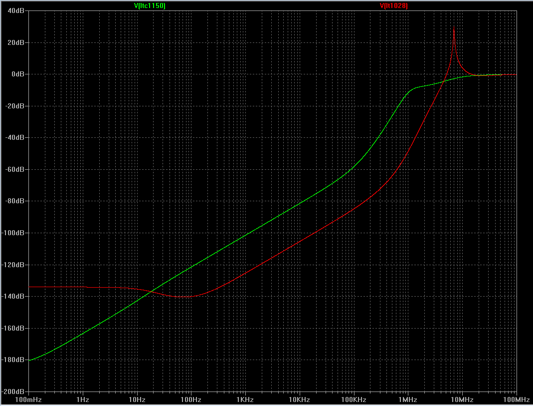

The reason why the LM2941 low dropout regulator IC only manages -75dB rejection at DC, is because its error amplifier has finite gain. What happens instead if you drop in the highest gain opamp natively supplied by LTSPICE, namely, the LTC1150? You get -180dB of rejection at DC, that's what happens. Parts count also goes up, from 5 parts to 10 parts, but maybe you've got the room so it's not a big deal.

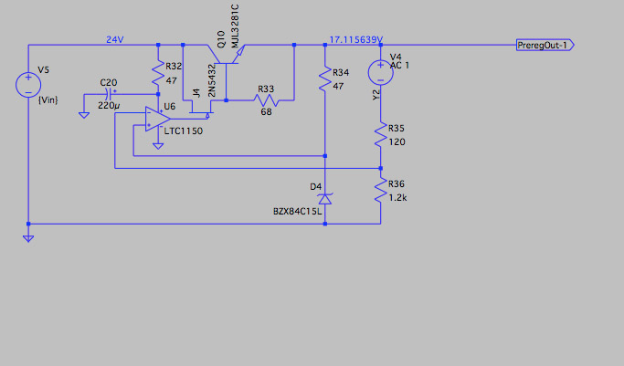

Notice that the large negative pinchoff voltage of the JFET means: no level shifter is required. Also notice that the voltage reference is pretty large: 15V zener, not 6.9V IC. This means we don't throw away precious gain, overcoming the R4-R5 attenuator.

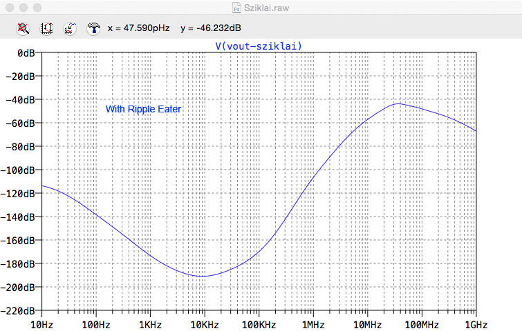

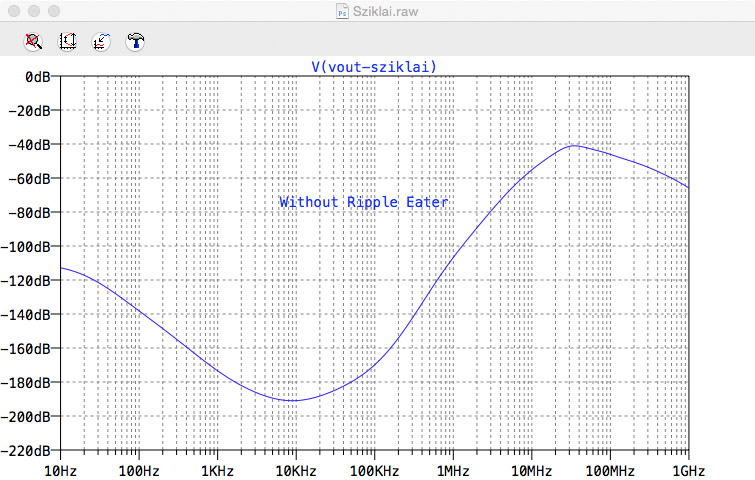

And yet if I drop this circuit into the Sziklai circuit outlined here - after C5 and ahead of the current source - the difference in modelled line rejection is pretty much immaterial... Seems counterintuitive to me.
Of course the quantity of interest is the quantity not plotted.
Plotting (V(Node_Y) / V(Node_X)) will show the line rejection of the Sziklai Super Regulator itself
Your plots in #122 suggest that one or the other of them has no line rejection at all, in simulation.
It almost sounds like LTSPICE is using less stringent accuracy requirements (e.g. bigger GMIN, bigger ABSTOL, bigger VNTOL, etc) in your simulations than in mine. Double check this and/or include an explicit directive
- Node_X = output of (LTC1150+MJL3281 ripple filter)
- Node_Y = output of Sziklai Super Regulator
- .OPTIONS GMIN=1E-12 ABSTOL=1E-12 VNTOL=1E-6
I found my problem. I had not adjusted your FB voltage divider ratio - or my input voltage - to accommodate the fact that I have two 2.2R resistors in series ahead of the "ripple eater". Voltage input to the ripple eater was too low for its set output voltage.

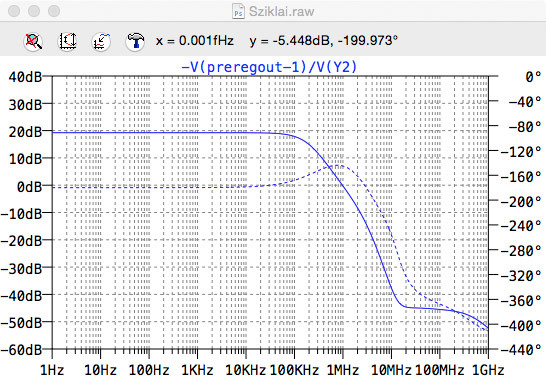

Did you by chance look at the stability of the circuit in post 121? Perhaps I am doing something wrong, but my analysis thus far suggests it is far from having suitable phase and gain margin. In fact, the phase profile is rather peculiar. It doesn't seem easily cured with an output cap/ESR combination either.
No it was a quick and dirty test to find out "what happens when you throw massive gain at the problem?" I figured that the phase shift introduced by the output stage (running at high current!) would be teeny tiny at the unity gain frequency of the opamp. When you use a faster opamp with a higher unity gain frequency (red curve) you do start to see some peaking that looks dangerous.
Maybe it was all too good to be true? Maybe the smart thing to do with a budget of ten parts, is to build two cascaded stages of LM2941s instead of one LTC1150 filter. Let the guys from TI worry about stability as indeed they already have. All you gotta do is guarantee that the net ESR of your bank of output capacitors, is right in the center of their Fig.13 safety zone. Which for my eyeballs is ESR=sqrt(0.1R * 1.0R) = 0.31 ohms. Three big mama capacitors, each one with a 1.0 ohm resistor between cap_minus and GND, boom done.

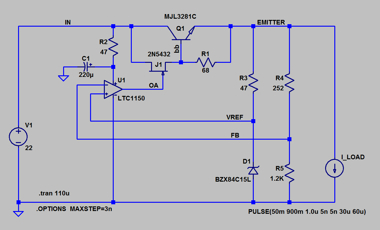

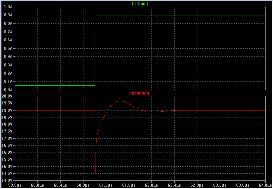

It's not that important to me so I didn't invest huge amounts of time, but I am mildly curious about it. So I invested tiny amounts of time. Instead of breaking the feedback loop and measuring the open loop gain and phase -- which would have taken Real Effort -- I just ran a transient analysis with a fast risetime square wave load. If the thing is definitely, certainly unstable, it will fail badly in a transient test.
Schematic and simulation results below. When the load current jumps up, from 50mA to 900mA, the output rings a little bit but doesn't oscillate. My best estimate is that this waveform's damping factor is Zeta=0.45 or therabouts. Which corresponds to a phase margin of 46 degrees (figure below). Not disastrous.

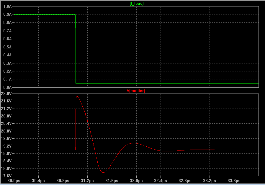

When the load current jumps down, from 900mA to 50mA, the output rings slightly more but still doesn't oscillate. My best estimate is that this waveform's damping factor is Zeta=0.38 or so. Which corresponds to a phase margin of 41 degreees. A tad more underdamped but still, not disastrous.

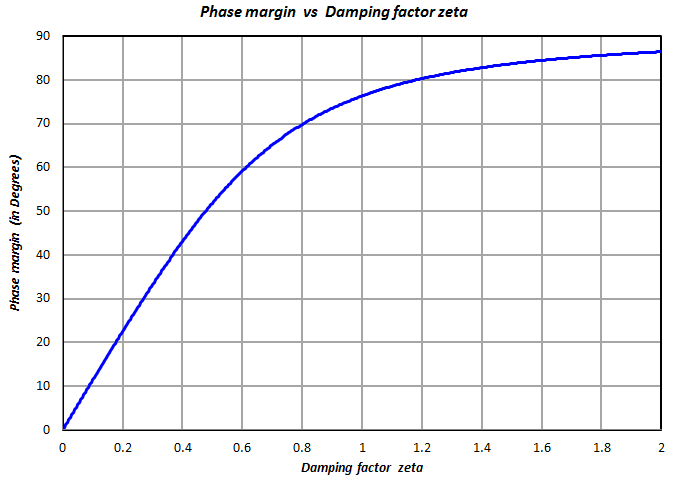

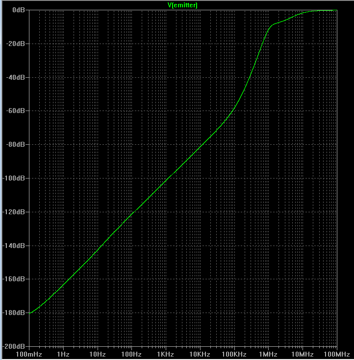

I've copied a couple figures that I originally posted on 18 Aug 2014, showing the relationship between phase margin and damping factor Zeta for a second order linear system.

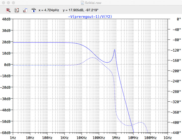

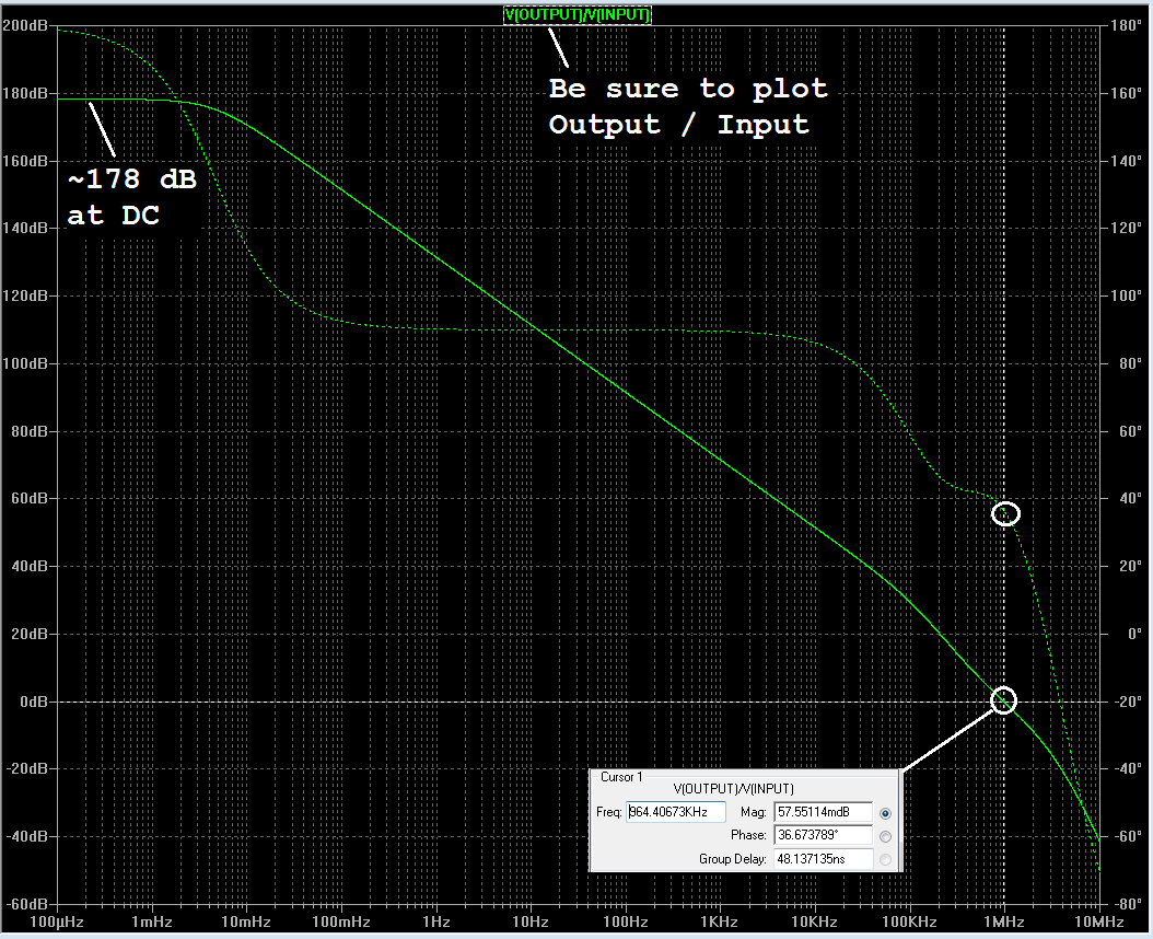

Ok. FWIW I've attached a screen grab of what I get when I model phase and gain of that circuit.

EDIT: our posts crossed. Yes, I too noticed it survived a transient analysis but then I played around a little more. Adding a bypass cap on the op amp supply threw it into haywire. So the circuit as is seems to make it through the transient test by the skin of its chin. And it's got a whole additional regulator circuit to follow it.

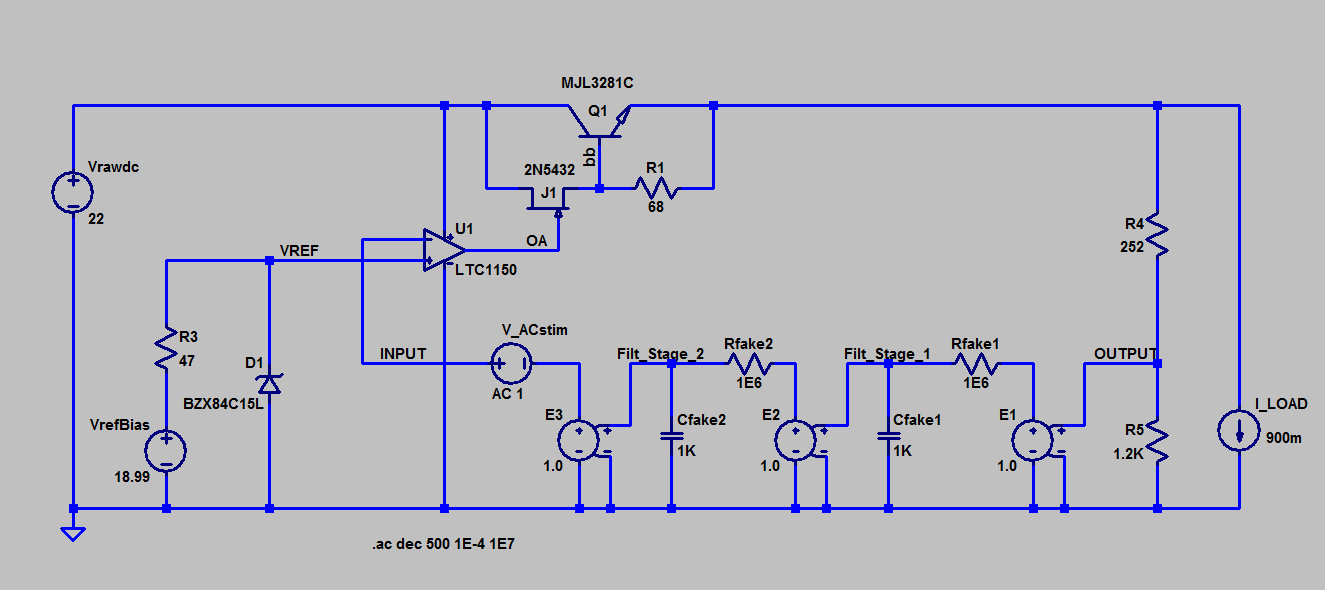

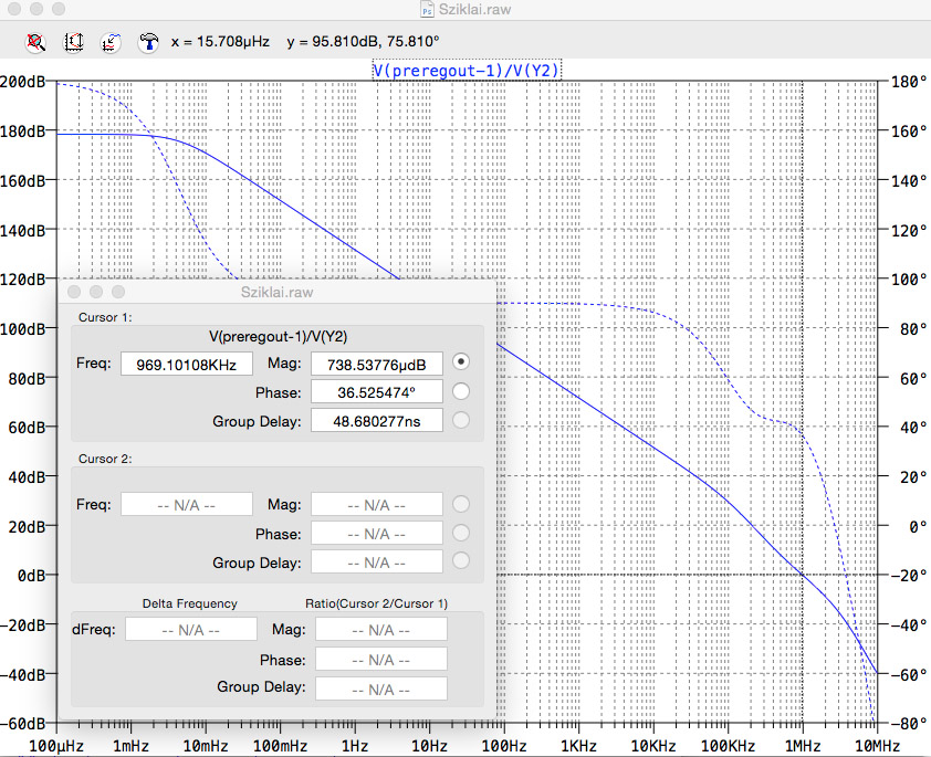

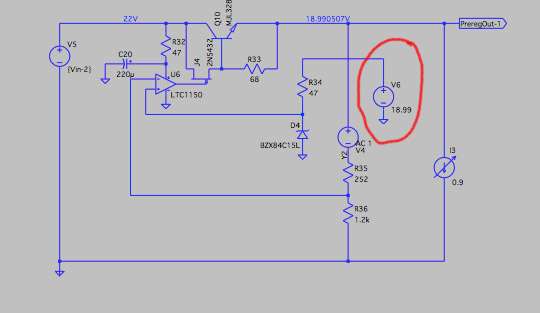

Ok I'm struggling to see the error. I'm breaking the loop ahead of the upper feedback resistor and injecting a small signal AC. Attached are pics of the circuit and output. (The output differs from above as the circuit above inadvertently included an output capacitor I was playing around with.) I've used the 'Linear Tech tutorial method' of breaking the loop. If I break the loop with a 1GH inductor and inject a small signal AC via a 1GF cap immediately after it a la Cordell I get the same answer below 10MHz.
That was an interesting exercise. I took my circuit and modified it to follow yours, checking the output as I went. I shifted the injection point to after the upper feedback resistor, but this made very little impact. (I have been told that it is better to pick the highest impedance point for the injection and this is why I placed it where I had.)
The voltage dependent voltage sources and the fake resistors and caps made no discernible difference and perhaps omitting them can make the analysis easier to perform.
I inverted the AC stimulus as per yours and change the plot from -Output/Input to Output/Input which saved some addition. So far no real change. (Note I had changed your R4 from 252 to 120 to yield a lower output voltage.)
The change of significance was the supply to the Vref Zener which I had left connected to the output and which you shifted to a perfect voltage source. Change that and boom goes the gain! I'm still trying to get my head around why.
Phase margin remained c30 degrees throughout.

I had been modelling none. (I was more focused on the large difference in gain profile.) If I add 900mA of load I get a phase margin of 33.8 degrees using your method (which I can simplify for the same result by removing all the E sources etc) but one difference between your model in post 135 and mine is that I have left the RC filter on the V+ to the LTC1150.
With no load current the NPN transistor is completely off and the JFET supplies the miniscule currents for the feedback divider and for the zener bias. That's why Teddy Pardo connected his JFET source resistor differently: he foresaw that boneheads might run his regulator with negligible load current.
