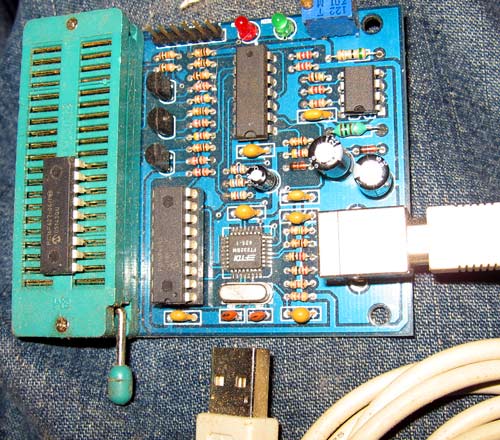

Sorry I don't have knowledge of those chips.... I do have a PIC programmer though
