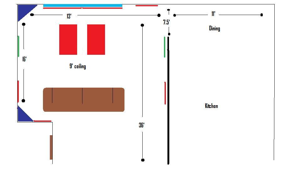

I am thinking of building a subwoofer/seat riser and I have a few questions:
The riser's dimensions will roughly be:
6' wide
4-5' long
6-8" inches high
I was thinking of using (2) 15" subwoofers or alternately using (14) 6.5" Dayton DC160-8. What would sound better of these two options? It's 30 square inches versus 91 in term of possible air movement, obviously. The 14 drivers would be placed along 3 of the 4 sides whereas the 15's would be facing up towards the seats.
How much damping fill should be used?
How much bracing would be required?
This would most likely be a vented design right?
Here's a copy of my room layout:
Thanks in advance!

You've got about 20 cubic feet to work with, so a large ported design is feasible.
You have between 15 and 20 cubic feet in your room, just for for subs. No fair!!! I am sooo jealous....
With this much space, it is all about the cabinet. There is no reason not to consider horns or tapped horns.

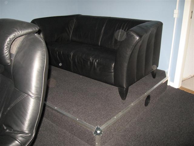

I did a similar project for my HT, using 2 x 12" JBL from a JBH HT1 surround set.
Thay are loaded in 2 x 120 l bass reflex ... using same allignment as the originals, but using larger ports.
I would defenetly go for the 2 x 15" instead of a lot of small cones ... the larger sones normally have better Thile-Small parameters for subwoofer use.
I only use 2 x 100 W for the subs, but I really don't need more, and don't get med wrong, I like the room to shake. But the beauty of the seat raiser is the large volume you have for the speakers, which means high effeciency.
Yes a horn would probably also be just great, but it's just much easier to make a reflex enclosure.
I have a 2 pers. sofa on my raiser, and the internal bracing I used is more than enough ... (but I wouldn't go for less either).
The braising needed also depend highly on the topplate thichness. I used 22 mm chipwood.

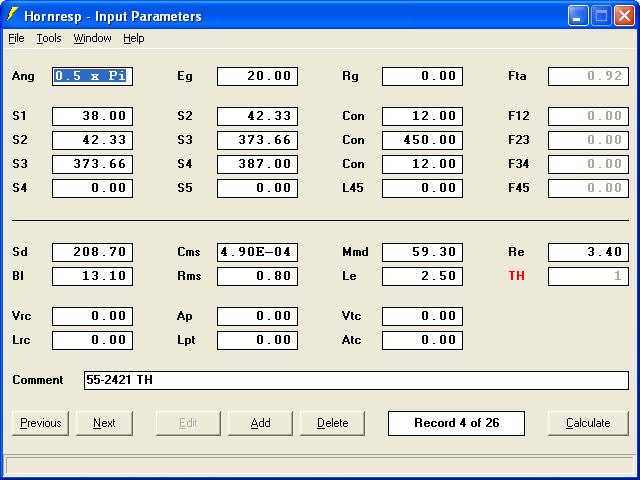

Seriously, I think a 7 1/2" tall riser is possible with simple up and back TH's in a dirt simple to build cabinet.
A 4x8 sheet of 3/4" ply top and 1/2" bottom, a 8' long by 6" tall 1/2" thick divider every 12" so there is room for 4 drivers/cabinets that are 8' up and 8' back. Put a 1/2" thick 'up and back' baffle, so there is 1/2" of space at the beginning, and an even 2 3/4" all the way around at the far end. The MCM should just squeak in there at 4.5" mounting depth. Attached is the hornresp for this. (I used .5pi to sim 4 cabinets)
Total height should be 7 1/4" plus carpet, for a finished height of 7.5"
Depending on the room acoustics, you could decide to have 2 firing left, and 2 right. Series-parallel would give a nice 4 ohm load, and a bash amp or equivalent would power it nicely.
This far exceeds THX specs (and you are right on top of the subs) Take into account a little room gain, and this is not bad at all... and can almost be built faster than checking email........ And while not a 'super spud' it should be good enough for the typical couch potato...
