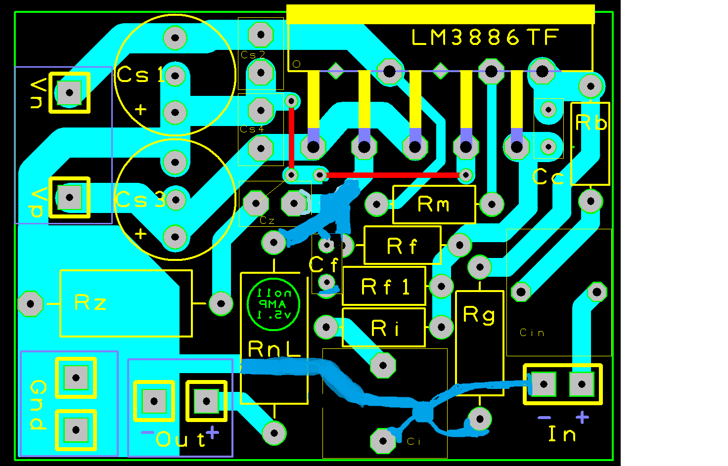

As I posted earlier I'm still trying to get the hang of all the parts and I think the "maximum" configuration is not that bad a start since I can build the amp, omitting these parts and have a direct comparison.
so the only parts that are missing from "maximum" are Ci and Rf2/Cf which act as RF-filters, but thats true for every part I guess... To ask a totally ignorant question (since I really have no imagination what they are for) is it useful to include these?

Thanks for the quick reply, now with "maximum" parts, since my Rg is 22k 4.7uF is the cap of choice.
L is now wound around R, 13 to 14 turns should give an inductance a bit above 0.5uH
Added diamond pads for pin 2 & 6.
Size: 30 * 40mm

Thanks for the link marce, I've looked through it and the diagram for the current flow on double sided PCB's was very interesting. But most of it is just a league to high for me (for now )
I hope that the size of my PCB will make up for the imperfections in wiring but now with star-grounding I don't think there's too much left to do better, considering the size.

Tried to edit my post, but stupid 30 min rule so i deleted it again and here is the edited version: Re schematic, i drew it myself. looks good.
Further, i would have just simply connected the ground leg of Rg to in-. (smaller ground loop)
Holes of Rf can be small size, move Cf down, and connect Rf to that trace spot.
connect Cf to the branch Rf was connected to.
OK, i had a look at the datasheet of lm4780. place Rin after Rb. This is better for DC offset. (both in+ and in- should have same impedance to ground)
The polarity of Cs1 is wrong.
fyi ive built this amp but without the (Rf + Cf)//Rfi because i only use a gain of 11 anyway. The purpose of this network is to bring the gain down to 10 for high AC freq. Dont go below 10 as it will oscilate.
i get 3.4mv dc offset input shorted. This is very good. The way to do this is match Ri and Rb, and Rg to Rf. ( same story as above, in+ and in- should have same impedance to gnd.)
excuse my comment "Further, i would have just simply connected the ground leg of Rg to in-. (smaller ground loop)".
Better is to seperate the power gnd star from the signal gnd star. Easiest way to do this is make the GND of Ci cap the signal gnd star, so just connect In- and Rg- to that point

You mean like this?
This I don't quite get, you are saying, that the upper pin of Cf should be closer to Cz, and the left pin of Rf behind Cz?
Because this is one of the few possible arrangements of Rf/Rf1/Cf.
Thanks for your explanations btw!
AMP: v5.1

I mean like in the attatchment below. I realize i wasnt clear enough, sorry.
Not sure if Cf will fit like that. It might take some fidling around. Probably rotating a bit to the left and moving RnL lower will work.
Also, let traces cross at right angles.
Additionally add a C of ~15pf directly at the signal input (p22 fig 7 of lm4780 datasheet).

Ok, I've included your suggestions.
AMP: v5.2

Is this a rule of esthetics or electricity?
Its to not have inductive coupling.
I think its starting to look pretty good now.
Few more places i would let paths cross at 90 degrees are the Rm and jumper, RnL and the ground trace below it.
The signal input traces can be a little smaller. The spacing is tight over there, and they dont carry current anyway.
Make the GND star more of a star. Look at p23 of lm4780.
Can you make the Vn, Vp, and Out traces fatter?
Check, increased the power traces from 2mm to 2.5mm. (where possible)
AMP: v5.3
AMP: v5.3
You can keep the copper pad enclosing the two Gnd points. Saves etching solution. Also make a circle in the cross of the signal gnd. Make Out- fatter, and the path RnL to the chip pin.
Move Cz down so you can make more clearance with the jumper island.
Can the Rb to Rg trace be made a tiny bit thinner?

Rb to Rg from 1.1 to 0.9mm.
Out-/+ now 2.5mm
RnL to Chip 2mm
Board is exactly 40 * 30mm
AMP: v5.4
