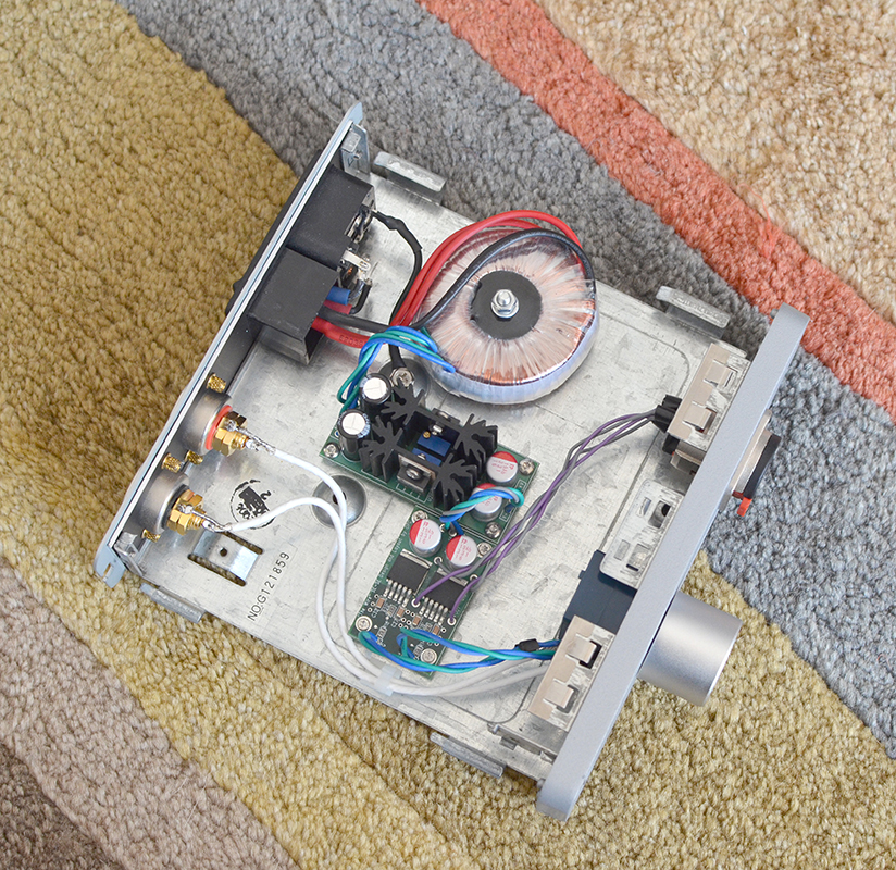

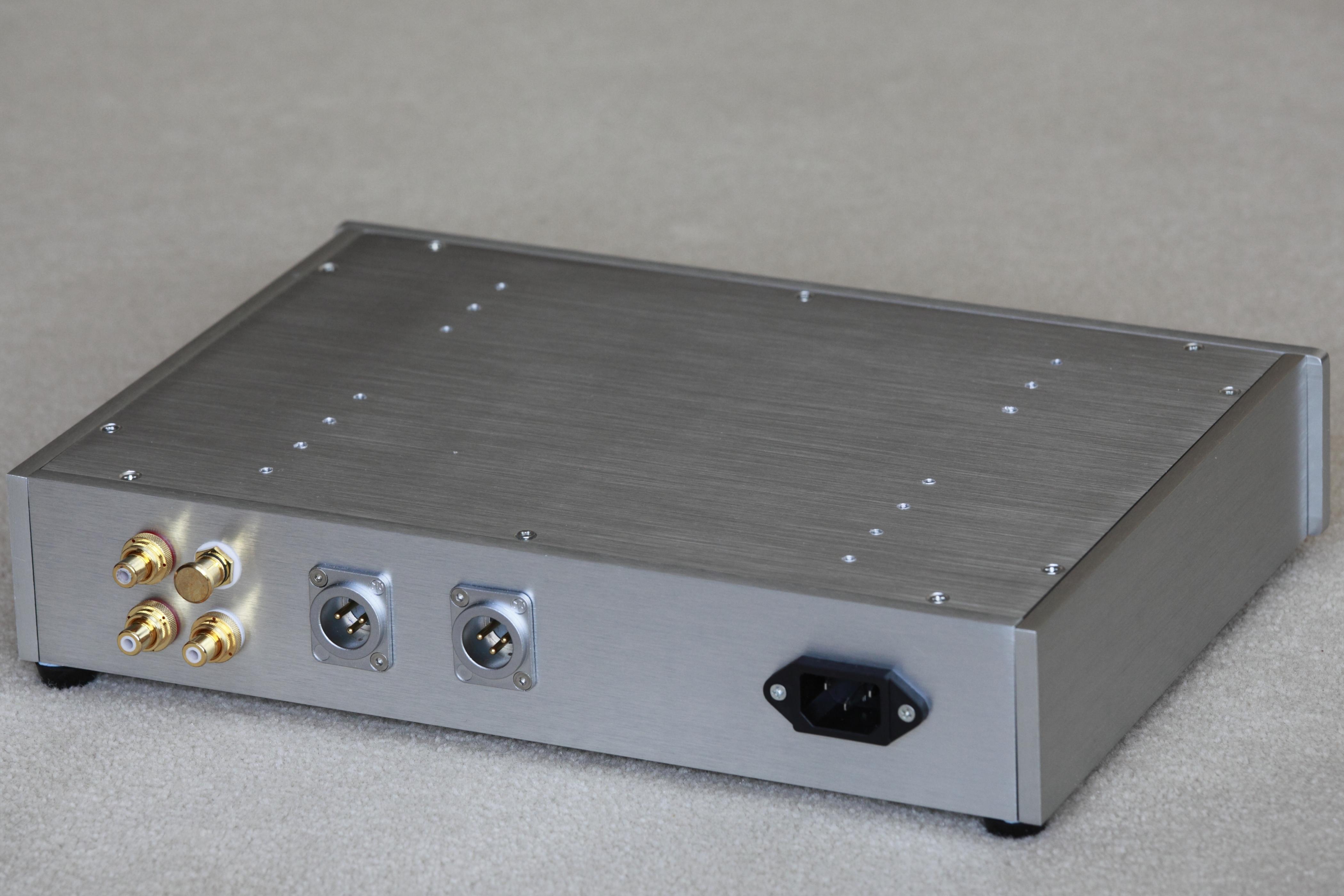

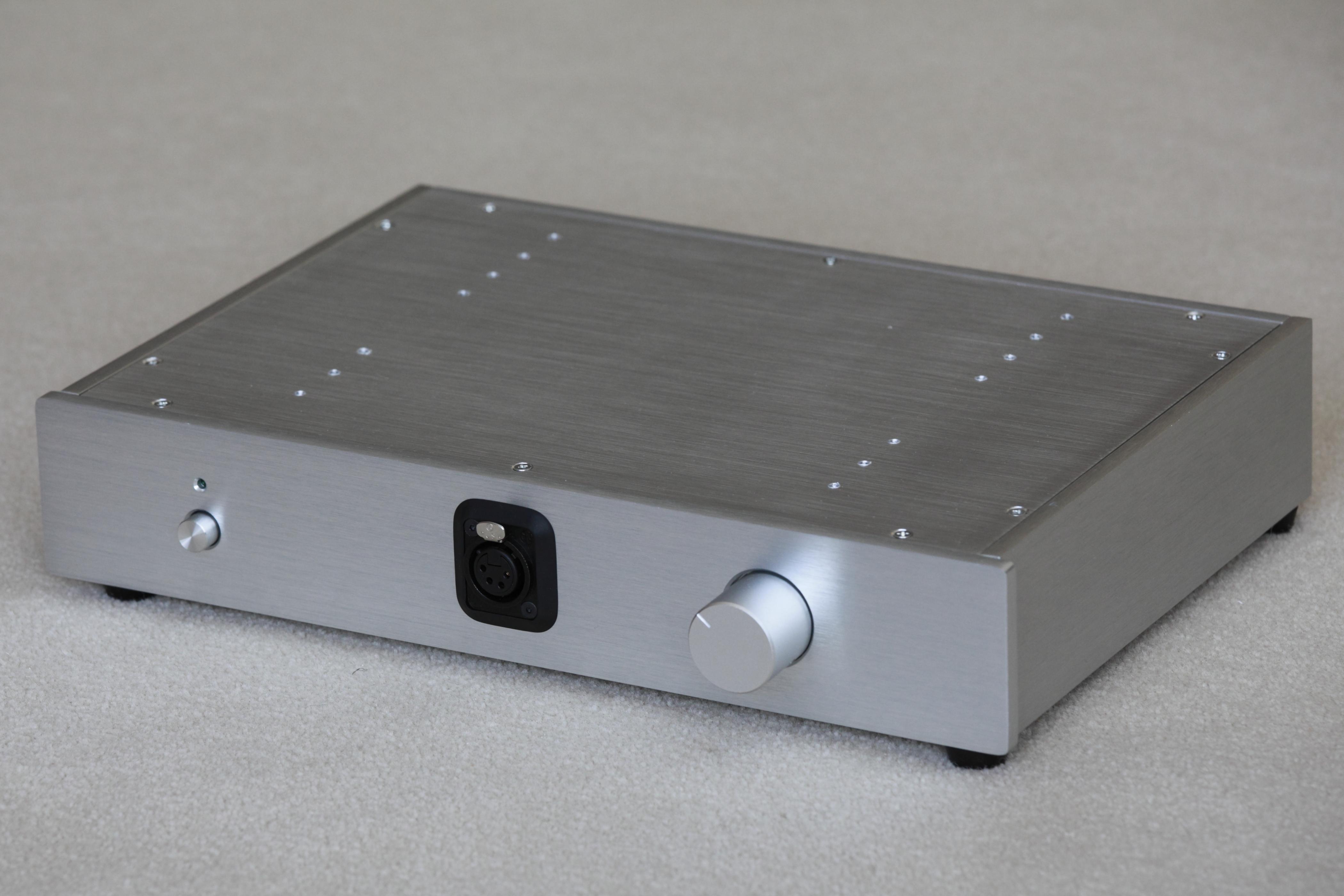

Thanks Owen!
Here are a few photos of the finished product as promised. Due to the lack of skill, patience and chassis space, the wiring is a bit messy and the metal work left much to be desired as well.
The WIRE may not be quite break-in yet, I only have maybe 30 some hours of playing time on it. But one thing I can confirm now, which I noticed within the first song I played through the WIRE, is that this amp does bass like no other headphone amp I've heard, it's deep and well controlled. The WIRE gives the HD650 bass extension that I did not know it possesses. The WIRE also appears to be extremely revealing - I hear nuances in the music that I did not notice previously.
Thanks again for your help! Without you, gusp and DIYAUDIO this amp would not have been possible!

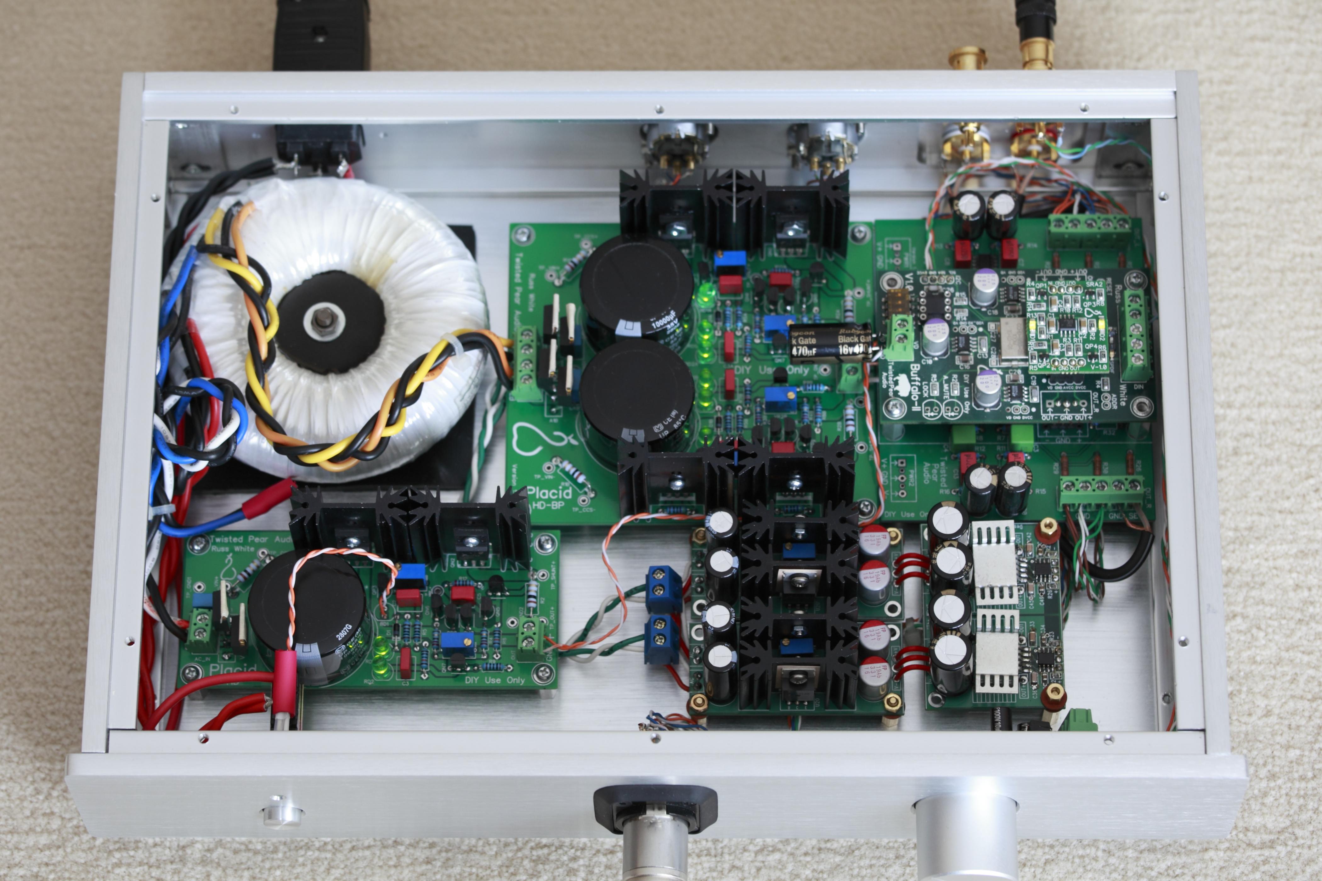

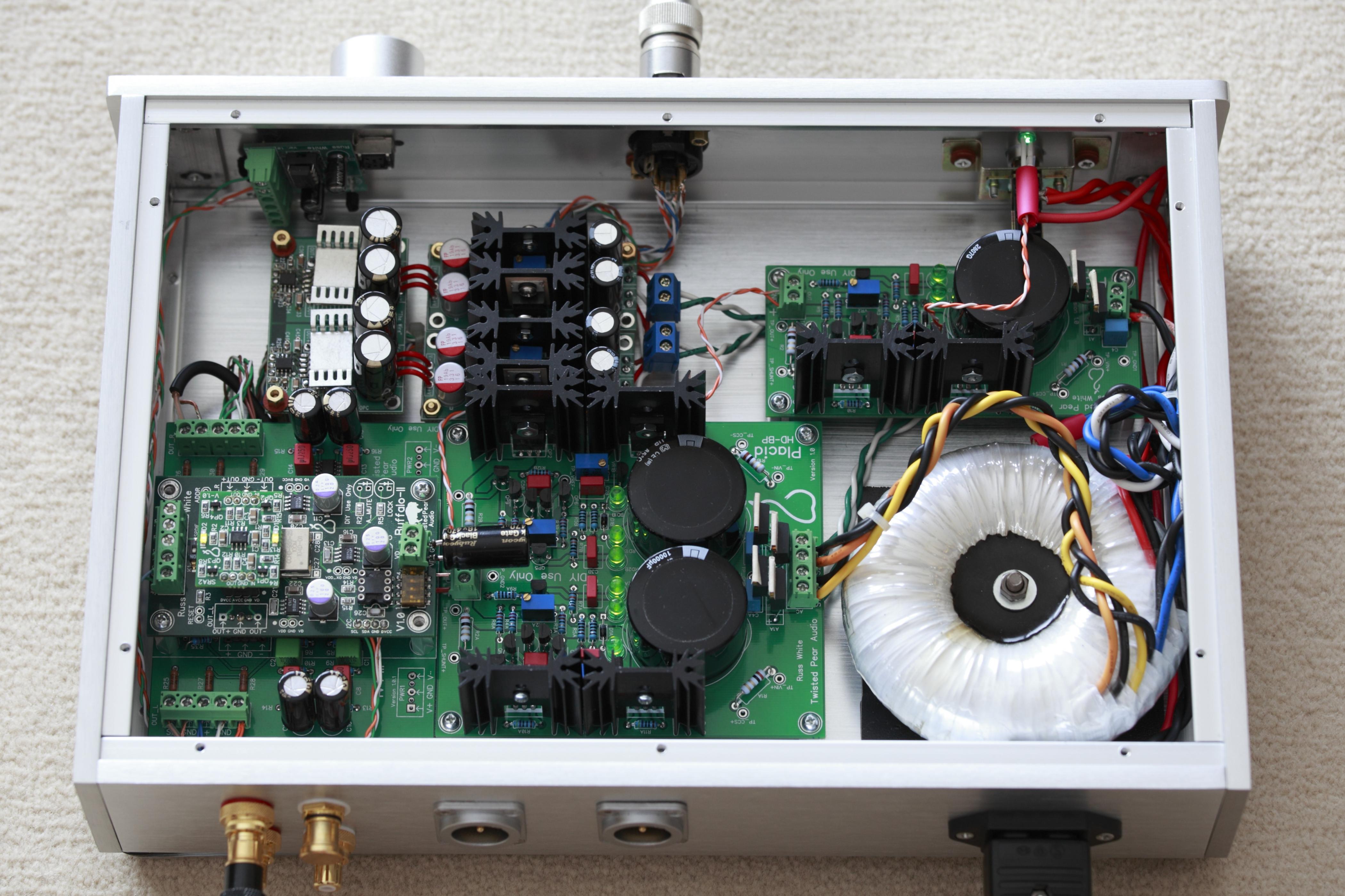

Very nice! I've struggled with casework/wiring myself - though I strive to improve it each project I take on. Overall, given the space constraints you have - I think you've done a good job (from one rookie to another :).
I've been working on my own casing for wire that rolls up my BIII, NTD1 IV and FIFO. I'm getting closer. I'm looking for 1/2 transformers that'll replace all these separates. Then, I'm putting together a UF.L/Otto II wiring harness that'll replace the current digital domain wiring. The NTD1 is known for throwing off serious heat, and this case design has finally put that issue to rest.

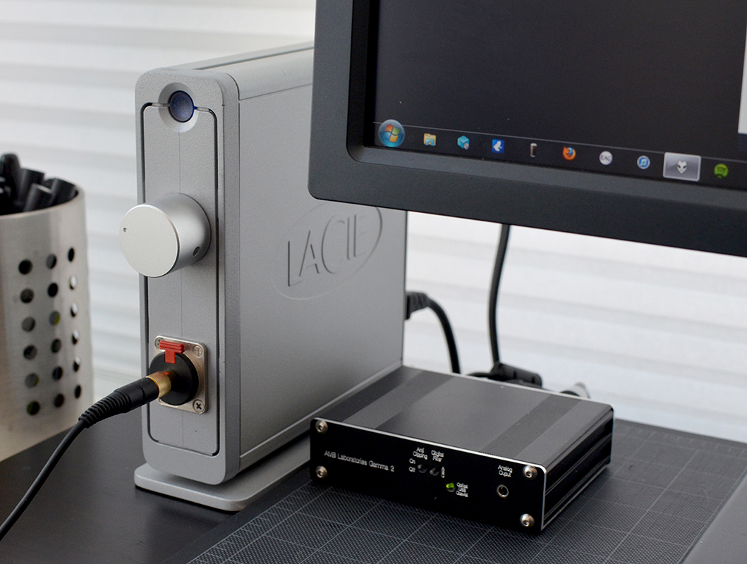

Finally got around to finishing this up. Thanks to Owen and everyone here for making this possible.
Housed in a re-purposed Lacie hard drive case. Plan on removing the Lacie logo, repainting and wiring an LED.

Hi Co60:
Nice work and creative. It looks great!
Hi MisterRogers:
That's quite a project you got going there! Great work! Hope you find the transformer that meets your needs.
The chassis I use was bought from China - the shipping costs nearly as much as the chassis itself. All I had to do was drilling the holes for the Neutrik connectors and top plate ventilation.
I originally used Mogami shielded balance cable between the IVY and the WIRE but it was too bulky for the space I have to work with. I ended up replacing them with braided Cat 6 wires hoping the balanced topology of the set up would be more tolerant. We'll see if interference becomes a problem. So far it seems to be working fine.
Interestingly, the whole set up sounds different after I put it in the chassis. I don't think the wiring change or break-in explains it. Very curious!
