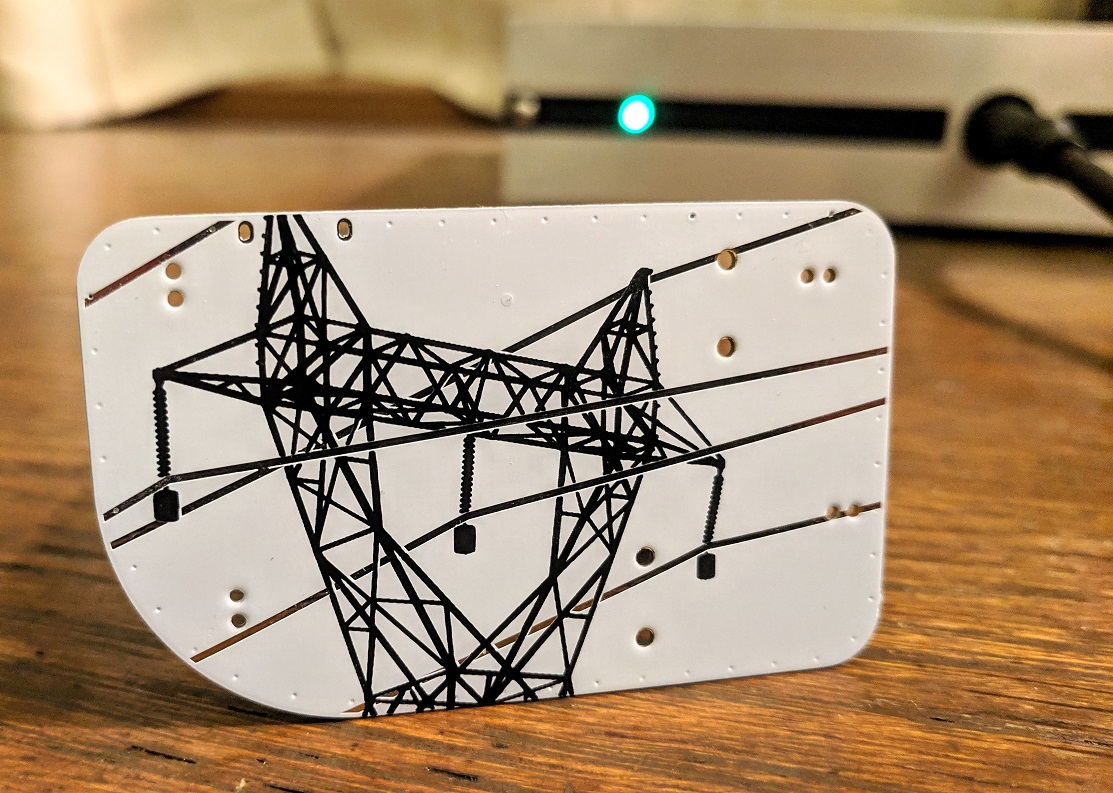

Something I've been working on, NanoWire
More information to follow.
Ooooh prettyyyy!

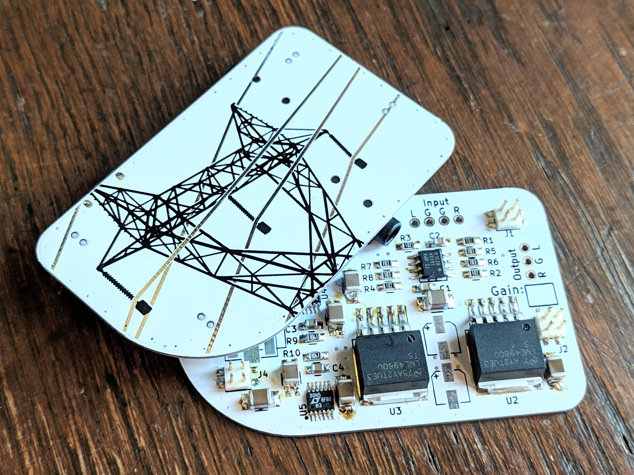

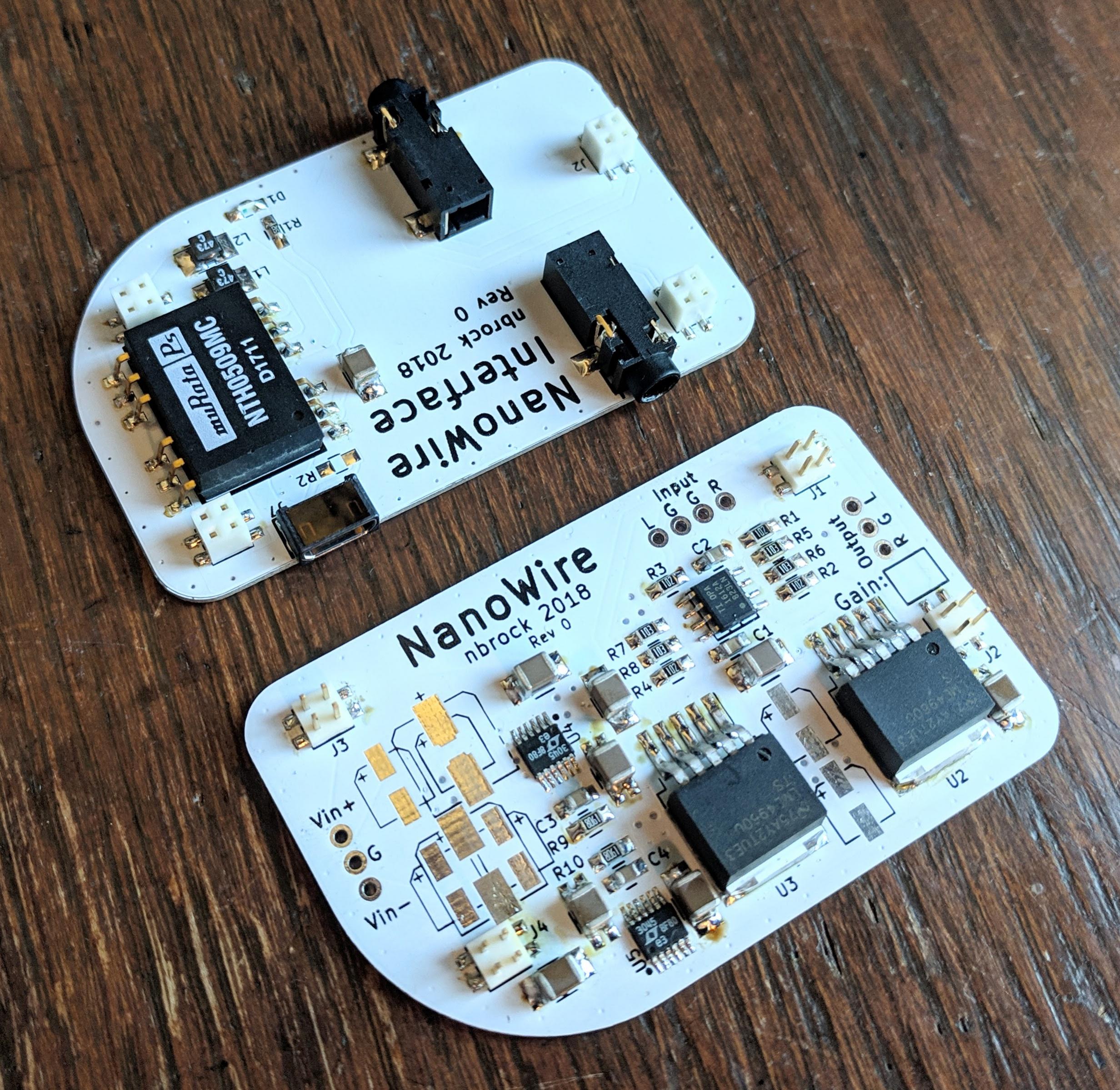

Okay, I populated one of my NanoWire boards and immediately found some errors. The linear regulators I used are not compatible with my DC-DC selection. At the moment I have it working with the regulators removed. There is also a lot of noise when power and audio are both supplied from the same device, probably a ground loop. I hope to fix this when I re-do the power supply section.
If there is interest I hope to offer these boards in a group buy or similar once all the issues are ironed out. Suggestions and comments are welcomed and I will consider them when making design revisions. Below I have copied a draft of my blog post that explains the thought process for this project.
Design Goals:
Single ended circuit
Shrink total size - As built: 65 x 40 x 8mm
Integrate power supply
Enclosure solution - hobbyists don't need to drill holes
The original circuit used LME49990 op amps which are now obsolete. I opted to sub in OPA1612, because of its comparably high performance. The dual package offers some layout benefits and a slightly reduced cost over using two OPA1611. TI claims "The dual version features completely independent circuitry for lowest crosstalk and freedom from interactions between channels, even when overdriven or overloaded." so hopefully there aren't too many complaints from the purists.
This design is USB powered. There's a DC-DC converter that will supply +/- 9V. Linear regulators make the final supply +/- 8V. Power output is limited by the supply. The converter I chose is 2 watts and there is approximately 100 mA drive current available. Theoretically the amp will deliver up to 80 mW / ch into 32 ohms, 282 mW /ch into 113 ohms, and 53 mW / ch into 600 ohms. Below 113 ohms it's current limited, above 113 ohms it's voltage limited.
I do not have the equipment or experience to characterize this new variant the way opc did. Because some parts are different, the layout has changed, it's a two layer board, and I'm not an audio designer / electrical engineer, I have to assume that the measured performance will be worse. If anyone has the ability and desire to make measurements I'll send you some boards once they are working properly.

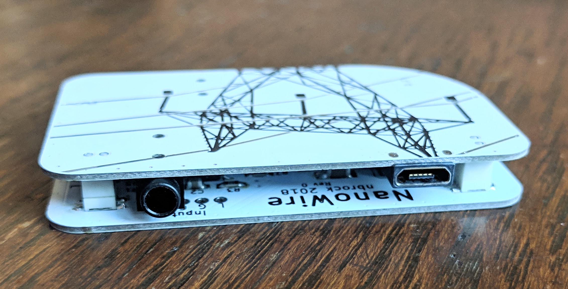

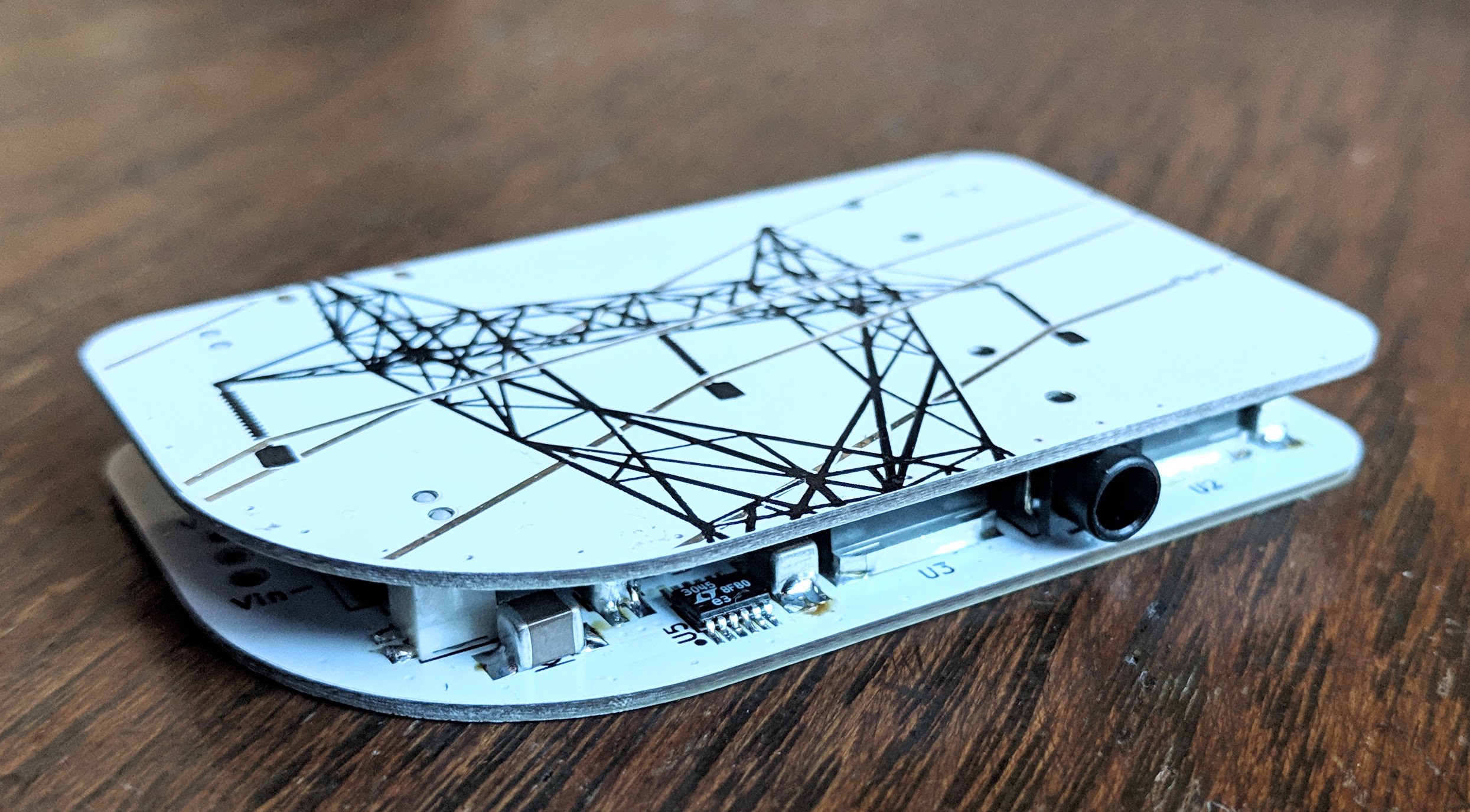

I had a discussion with another enthusiast at the 2018 Burning Amp festival about cases. In his experience the enclosure typically took more than half of a project's resources (money, time, mental effort). He often resorted to modifying "found" enclosures that were larger and uglier than he'd have liked.
I wanted to include an enclosure solution for the less mechanically inclined. I explored what it would take to supply an appropriately sized, inexpensive, attractive case with all the right holes in the right places. Aliexpress has a wide selection of cases available. Most of what I looked at were aluminum extrusions with a front and back plate. Nearly every listing offers customization of the case for an additional fee. The typical offering is custom extrusion length, color/finish, cut or punched holes, and silkscreen graphics.
As my layout continued to shrink I briefly considered a fully machined enclosure as well. I've used mfg.com in the past for job shop type work with good results and would feel comfortable using them again for a small amp case.
A few things put me off having custom cases made. Unknown demand was a major factor. The original boards made by opc haven't been available for over 5 years and as a result there isn't much recent discussion on the build thread. People may no longer be interested in the design and I might not have the quantity needed to make a custom order of cases worthwhile. On the other hand, there may be a back log of people waiting to build and the quantity could become more than I am prepared to handle. This leads into my next concern, capital. Ordering anything in large quantity requires a chunk of money to be set aside. Aliexpress offers reasonable prices but my experience with their sellers has been mixed which does not inspire confidence. Since this is a hobby for me and not a business it's hard to justify the risk, at least for a first run.
Kicking ideas around and fiddling with the layout eventually led me to a design that uses two PCBs stacked together with all components sandwiched between them. The main lower board has the audio circuitry and linear regulators on it and a number of different ways to connect to it. The upper board is an interface board. It's the same shape as the main board and sits directly over it, connected by a few headers. It has the 3.5mm input + output connectors, USB connector, and DC-DC PSU module. The outer most copper layers of the assembly are ground plane only. This should prevent any shorts if the amp rests on anything conductive. To make manual assembly a bit easier, all the parts that need mechanical alignment have board guides. The interface board is optional. Some builders will want to use their own connectors or power supply by wiring directly to the through holes provided on the main board. I plan to make at least one more interface board variant with a beefier power supply, RCA input, and 1/4" jack output. I think an integrated DAC board would be pretty slick, but that's a little outside my current abilities.
