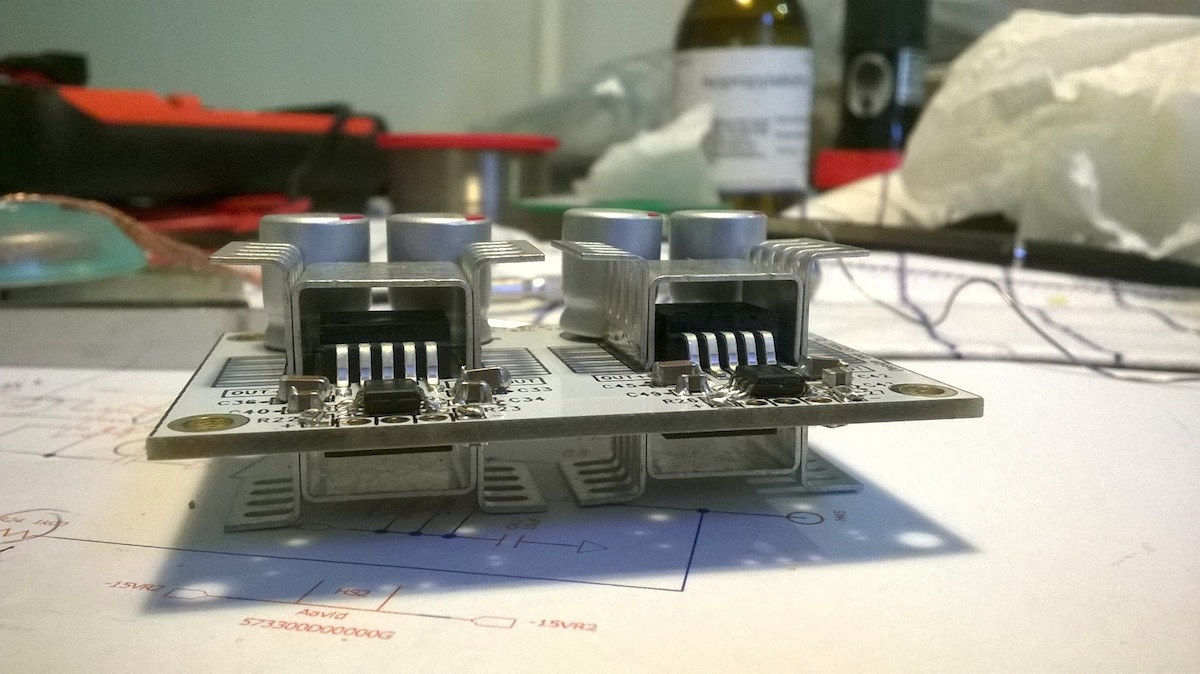

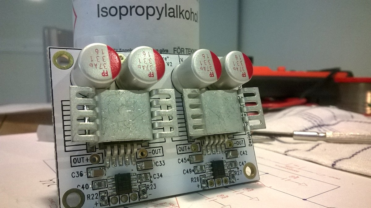

The hetsink has contact with the caps - problem?
yes... problem.
Sneak a piece of tape in there, or move the heatsink. The can of the caps will be at the same potential as the -pin of the cap and the heatsink will be at V- potential. Depending on which cap it's touching, this could be an issue.
Better safe than sorry.
It seems that the os-con and pans FP polymer caps cans are not conductive. I mean it looks like bare metal can but may have some coating on them. So I guess touching them would not be an issue, but may not apply to other aluminum caps.
