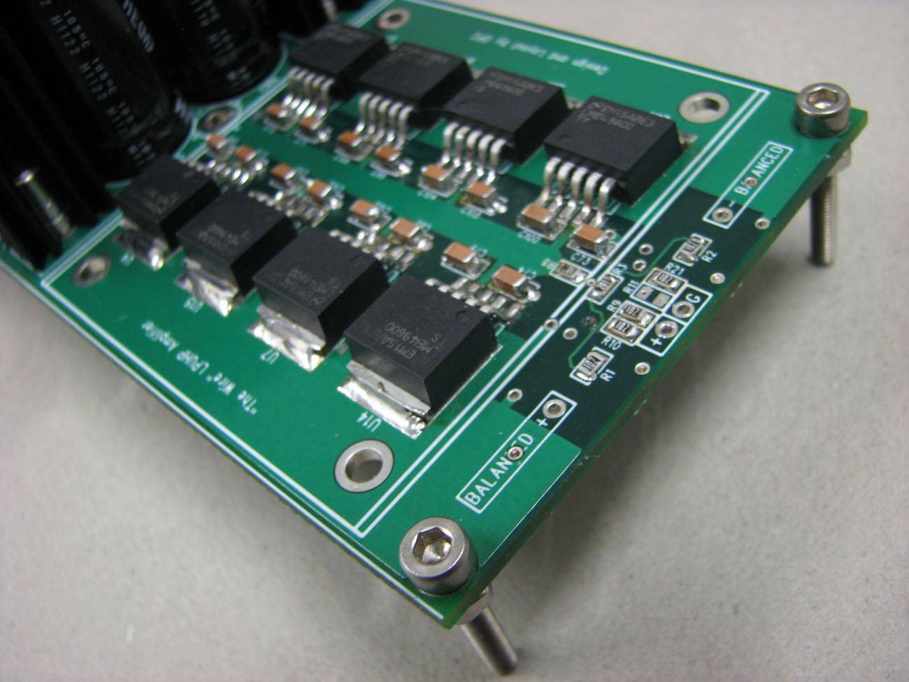

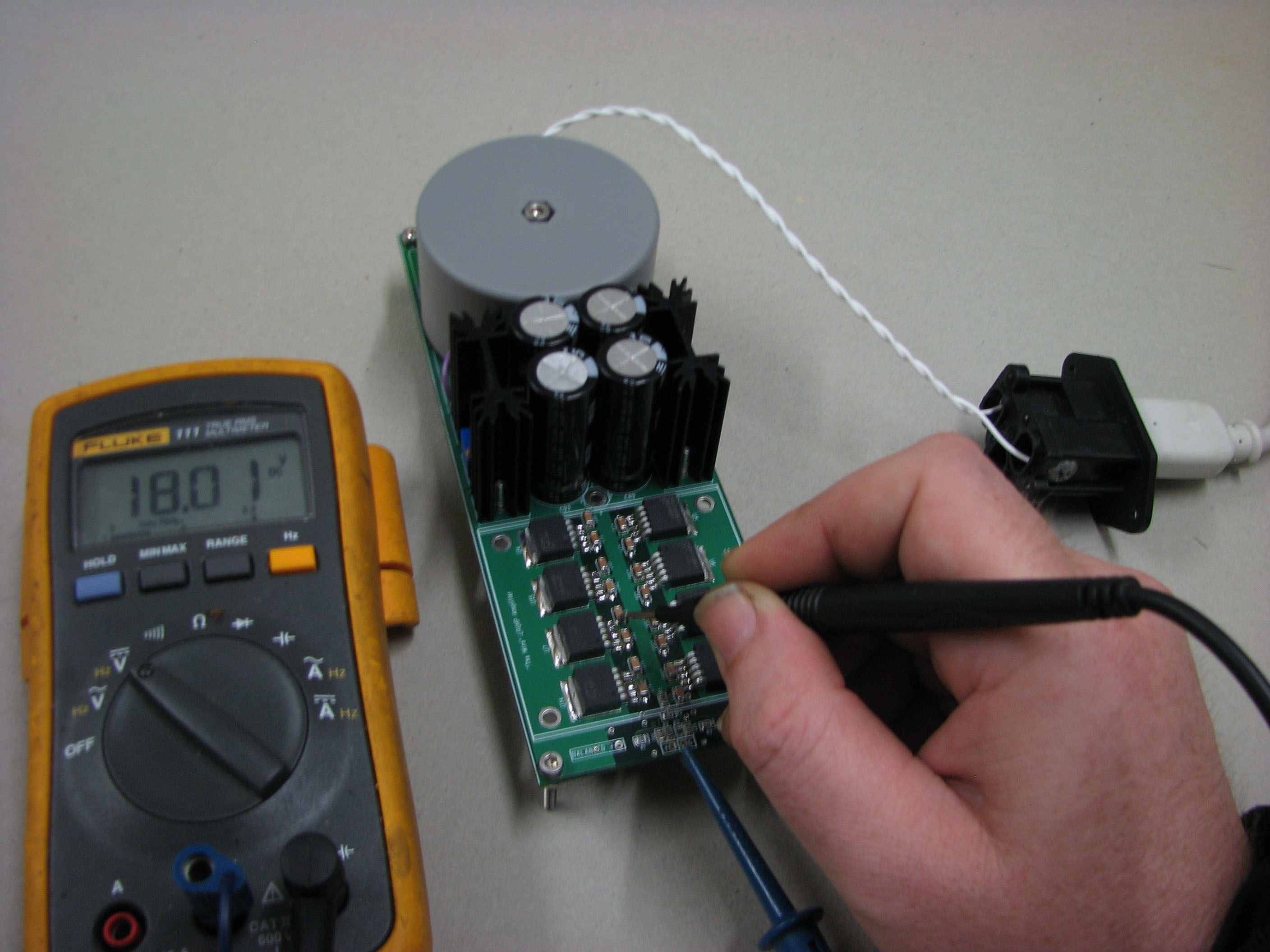

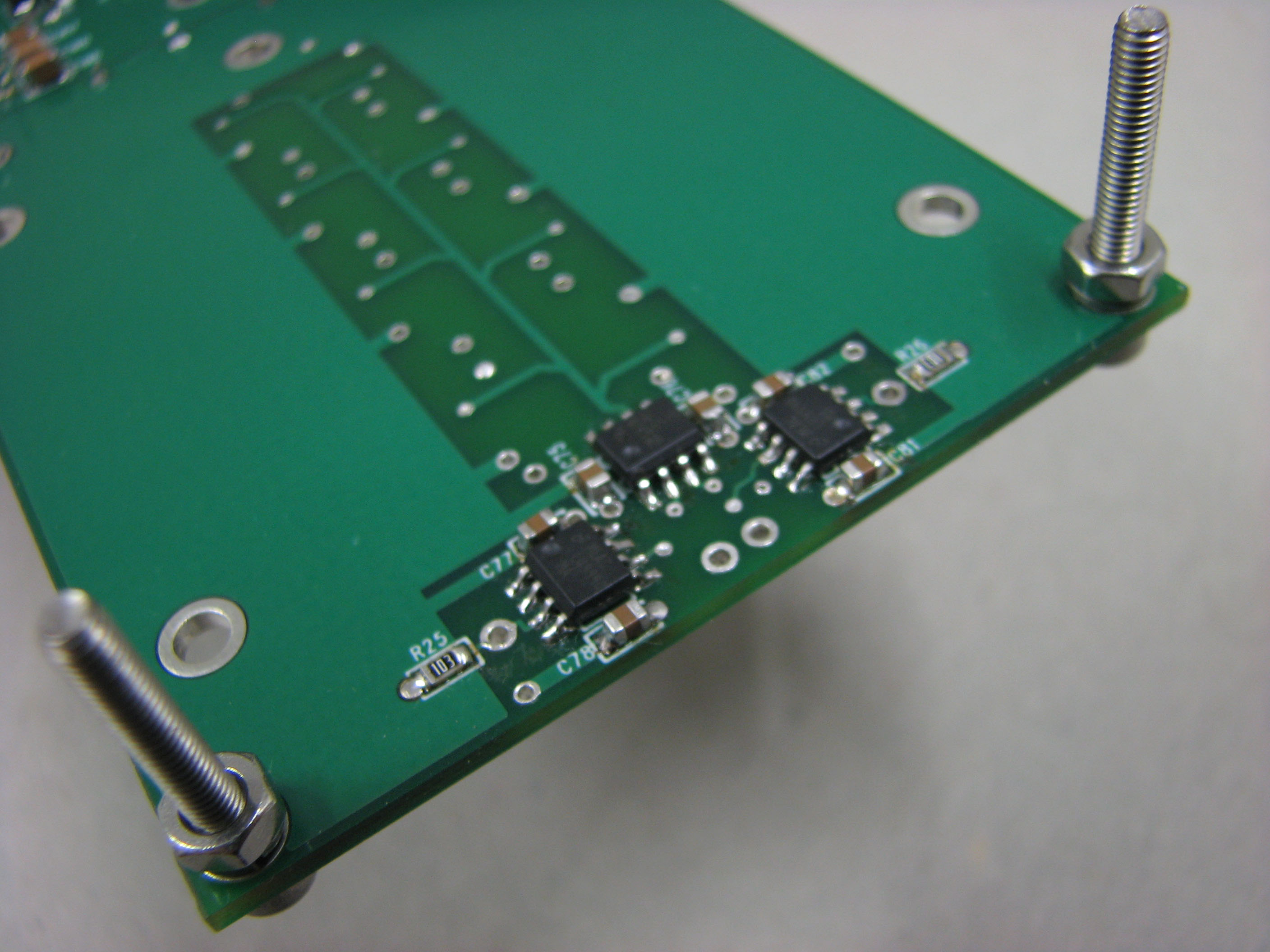

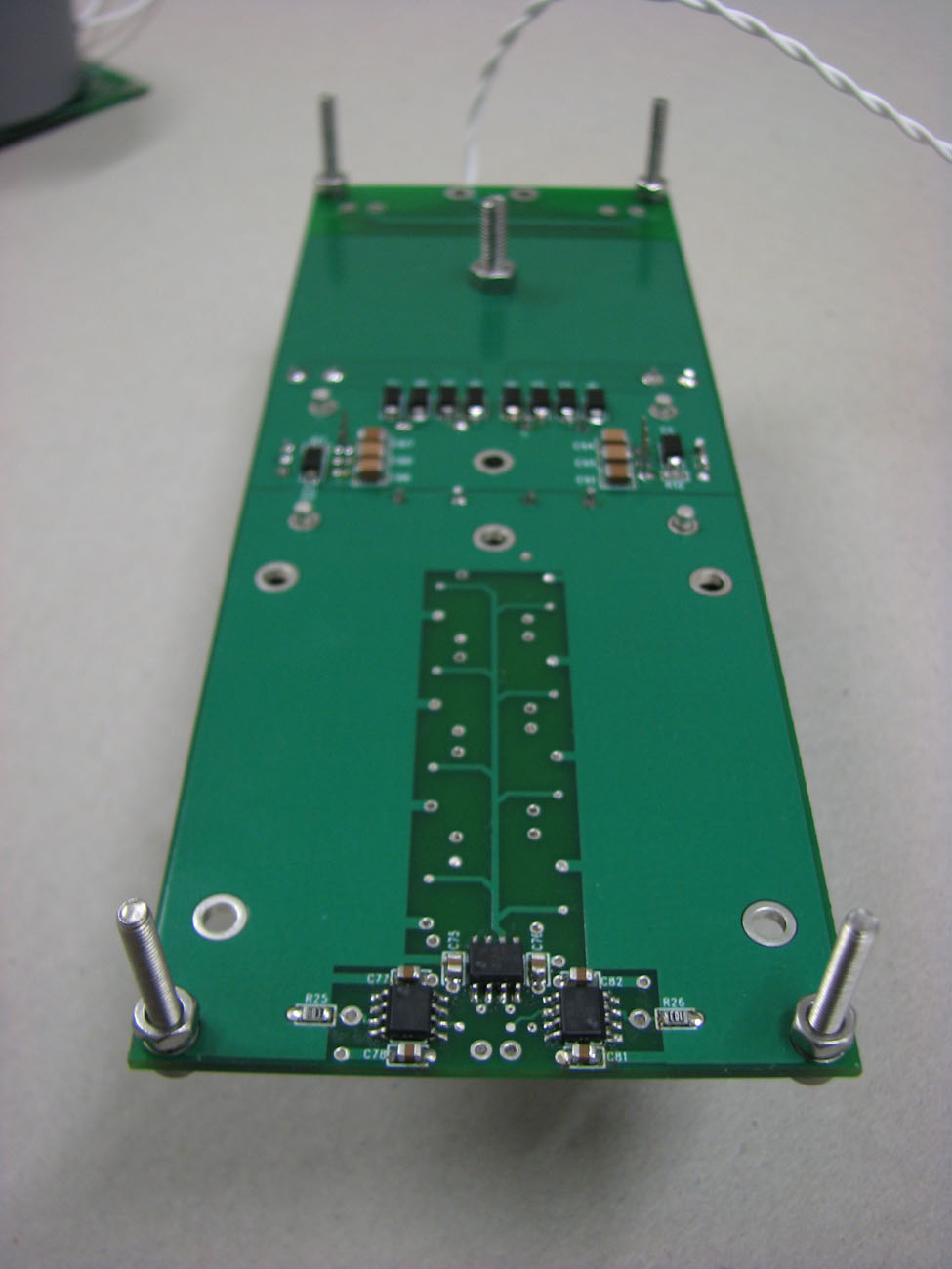

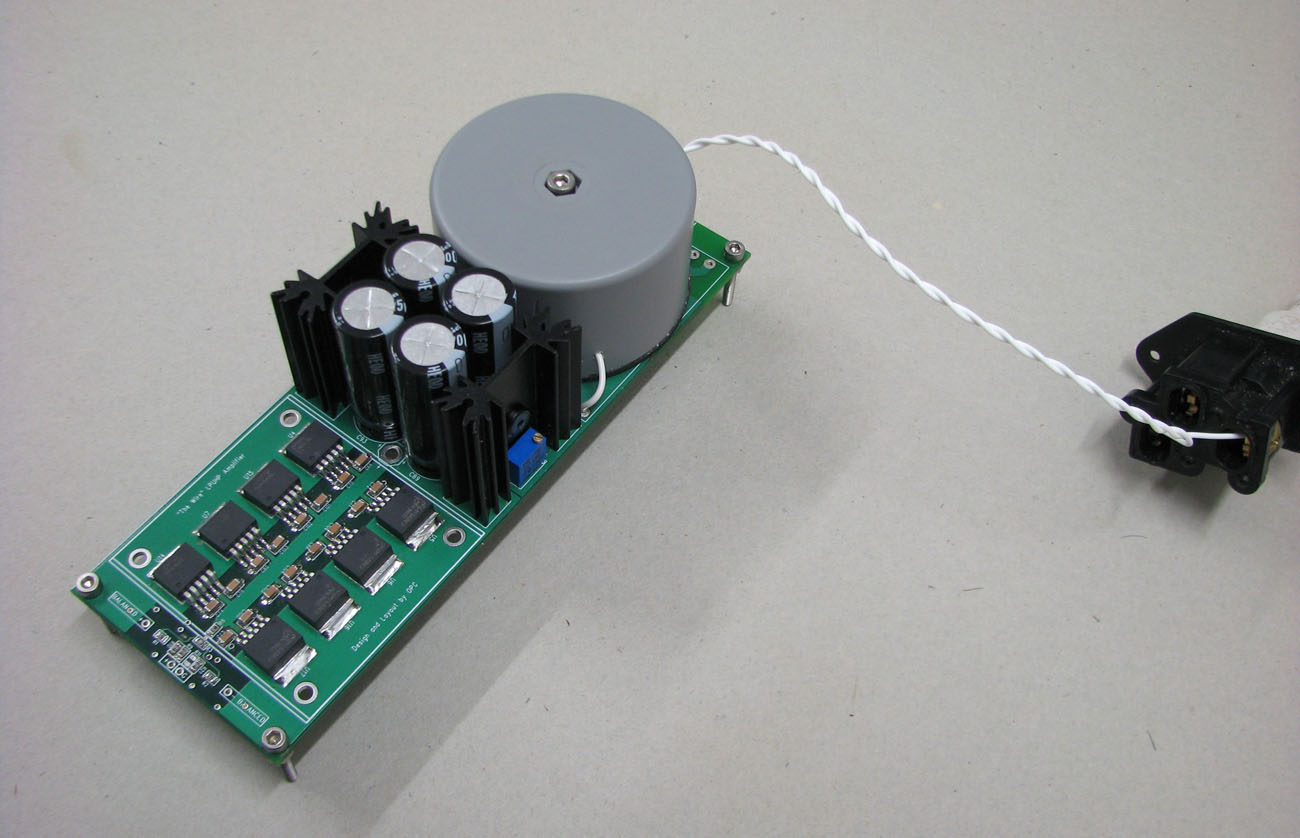

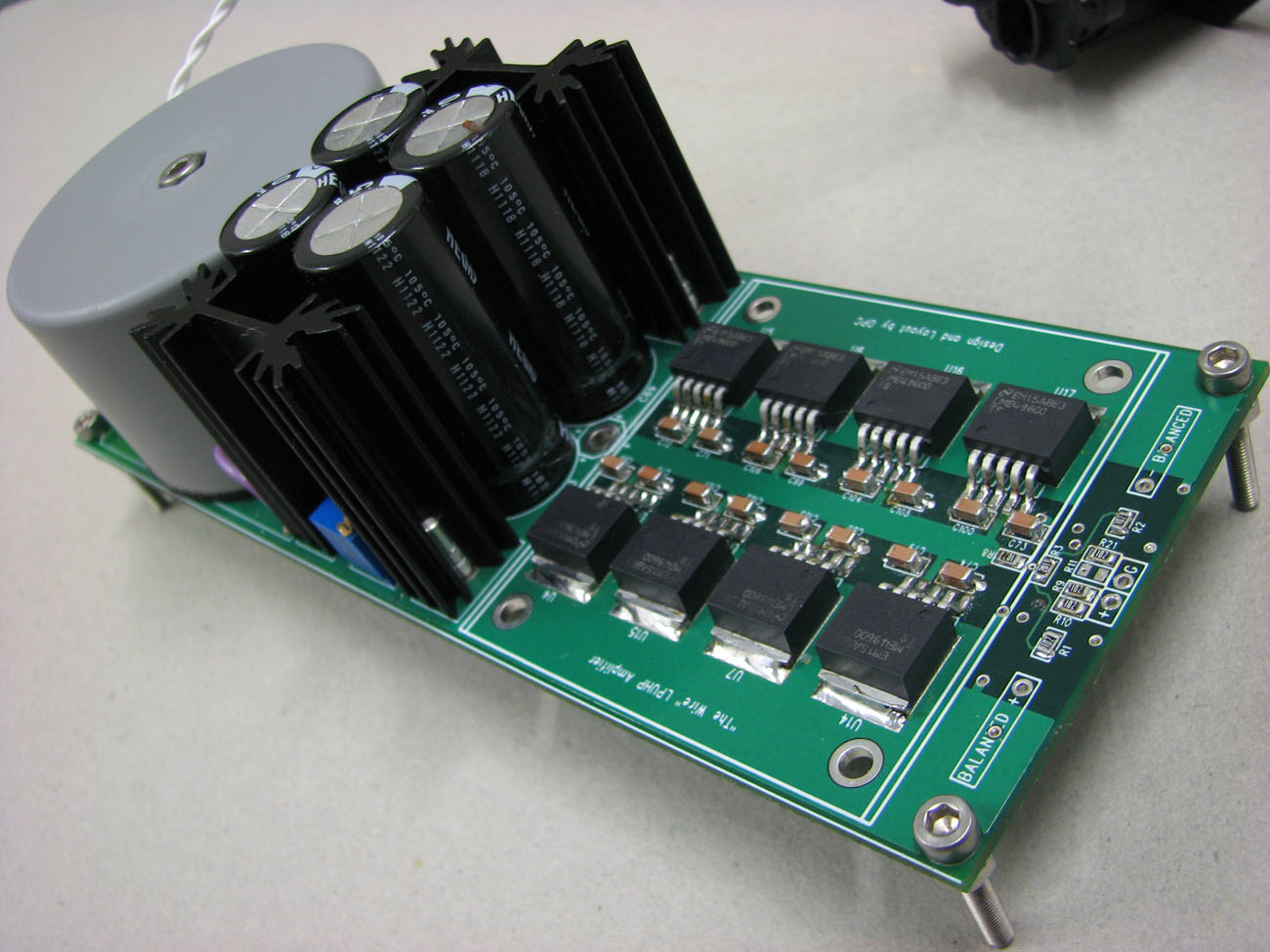

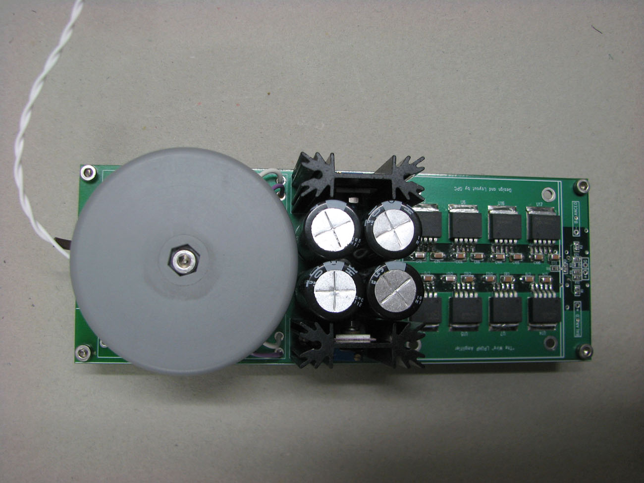

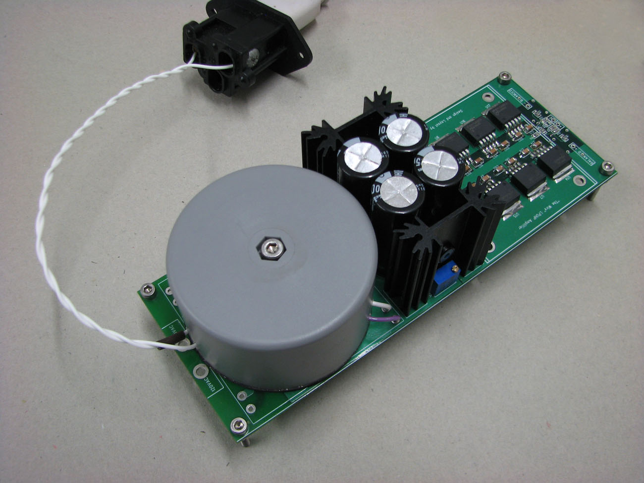

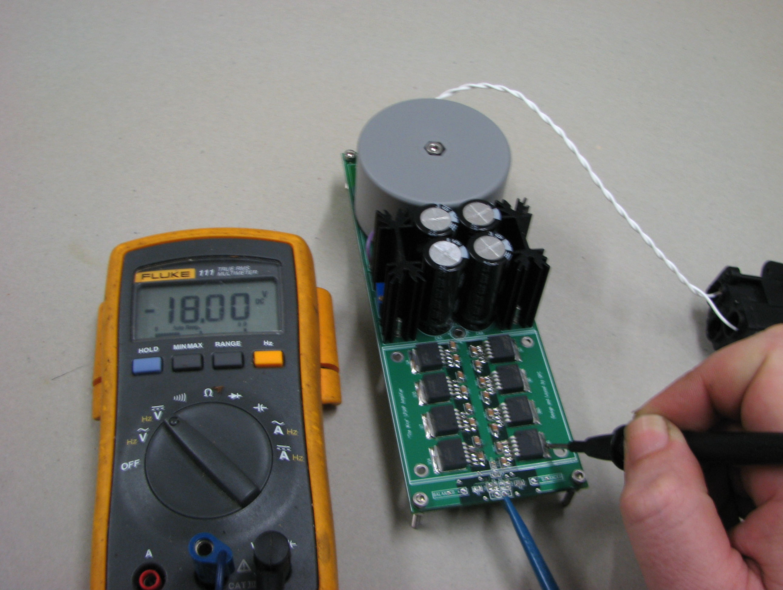

finished one channel, such a cute little amp! no issues with testing. i've got a few build tips i'll post to help others out with the process. havent tested with the output loaded as yet, will do that tomorrow. the transformer fits like a glove and performance is spot on.
i'm thinking of getting a little heatsink for the input instrumentation amp, should be able to find a nice little short one that will cover all 3, they get toasty as, hottest thing on the board in fact . but since i'm running them at max recommended voltage and they werent loaded, its hardly surprising
now that I see the pics I can see a couple less than ideal fillets on 1 or 2 the buffers, such a good tool the camera, I couldnt see them in the wee hours, plus they are shiny so its a bit more difficult, purely aesthetic though; will have to touch them up
TBH guys, if we are forced to look at other heatsink options, I would recommend we look towards heatsinking the underside, I reckon it gets hotter than the top and theres a fair bit more realestate there to pull it out from. can do both of course, the underside will need a bit of thinking. the 49990 are easy we can use adhesive backed little copper sinks there
I'm guessing when you say heatsinking the underside, you meant doing so for the purpose of cooling the LME49600's? Have you done any measurements of the temperature of the top heatsinking ground plane vs the bottom ground plane? I wonder about the efficiency of any cooling from the bottom, since the only direct path for heat to be transferred to the bottom would be from the through-plated vias and mounting holes.
both, the 49990 are the hottest thing temp wise, but the buffers will be putting more in as theres more of them and they are more firmly attached. nah my temp probe is pretty rooted, but there is no doubt the bottom is considerably hotter than the top, not a small amount at all and its far more accessible. the buffer bodies hardly have any heat at all, which is why Marks design was good because it had good contact with both. by itself, heatsinking the buffer bodies will take bugger all of the heat out IMO. have a look in the GB thread for other comments and suggestions, using an angle top and bottom, bolted through both and the PCB and if thats good enough just leave it, but otherwise bolt a heatsink to the vertical faces, perhaps even the sides of a case. they wont need to be huge fins if they need fins, the brackets will probably be enough if big enough
heat gets out however it can, if the vias are leading somewhere that isnt pulling heat out and you provide somewhere below clamped to the board where most of the heat is, its not going to choose the vias
besides, if it came to it, who cares if the amp is upside down inside the case.... I sure dont
alternatively of course if you dont need to be using +/-18vdc and can get away with 15-16 then that would save quite a bit too I imagine. and do remember this is unloaded other than the idle current, opc can probably say whether they cool down when driving speakers or heat up further as they are running more in class A than when in idle. I often have amps on when not playing music and this is almost winter here, it was 14 degrees when I did that test last night
they can probably handle it, it was just more heat than I was expecting
