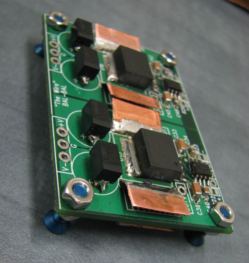

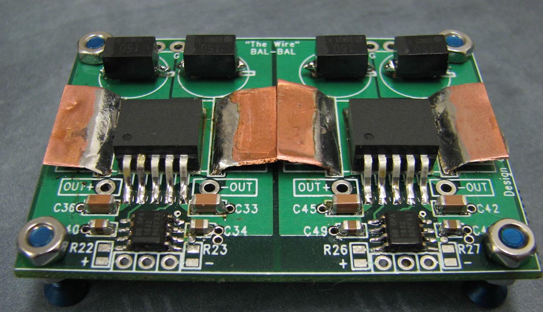

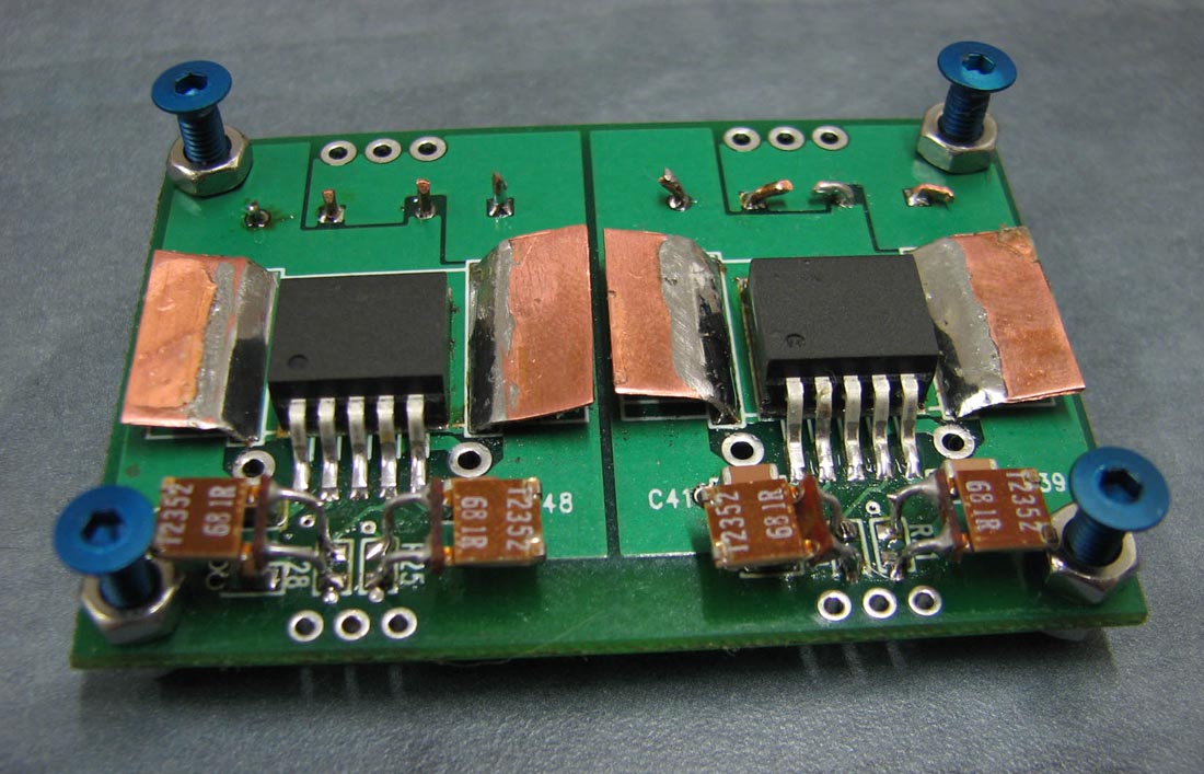

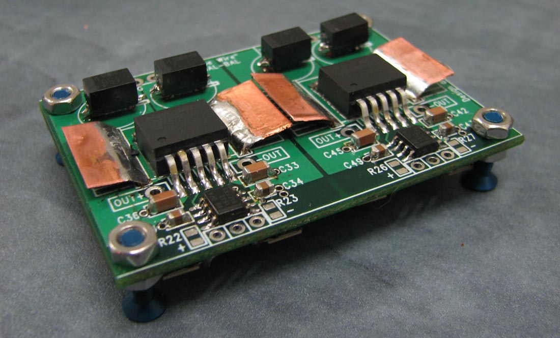

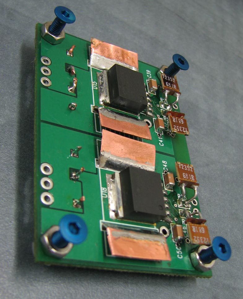

so heres my BAL-BAL, optimized for low profile and low impedance for battery operation. the TX2352 Zfoils are just till the ASMP SMD zfoils arrive, i have omitted the input resistors and will bridge them to keep the input lowZ, as this is also the IV stage for my portable sabre
I had to improvise with the heatsinks, i wont need all that much for this build and the BOM sinks are too large, so these are made with Goertz 8awg copper foil speaker cable bent into shape; the PCB alone might have been enough at the lower voltage i'm using and unity gain, but given the rather low impedance headphones I Favor, I thought it best to add some backup, plus it looks pretty sweet.
The panasonic SP polymer caps are used for low profile, never mind they are the lowest impedance caps i know of, but after the issues a couple of people had with the soldermask shorting through, I thought it best to elevate them a little bit on some 18awg copper 'leads'; they are still shorter than any lowz can type PTH cap i know of, so worked out well
the 2 middle heatsinks are not as close as they appear

Very nice! I love the low profile. How thin did you manage when it's all said and done? I'm guessing 0.5" but you might be able to do even better than that.
It does look like you've got a cold solder joint on the left side of C45 however. Might need to get the iron back out to touch that one up :)
What rail voltage will you get off the batteries? Anything below 10V should make for very minimal disspation, so heat shouldn't be an issue.

hehe i thought you might say something about that, but its actually fine, theres just a bit of black scum from the cardas flux in the middle, but now youve said something i wont be able to help it =D. edit: actually I just looked at the real thing and its a convex spot in the shiny mirror like reflection causing a black spot in the photo =D see below for better angle
as for the profile, nothing extends higher than the buffer top or bottom (~10mm thick all up), cant get any smaller than that unless I start lapping away at the epoxy down to the die ;) the screw standoffs are just temporary while i work with it on the bench
the voltage is lower than that, about +/-6.8-7.2vdc but all the current it can eat as i'm feeding this direct from the batteries; which are capable of 70A constant and 120A burst and have an output impedance of about 25mOhms. I'm thinking of trying the front end off the dual mono bipolar LDOs and only feeding the buffers direct from 600uf per rail of SP caps about 40mm away in the case, but whether this will be an improvement is dubious, it would just mean that it would be shutdown automatically with low battery like the rest of the unit.
voltage is a bit low for the buffers, but to get decent runtime of about 7hrs with the rest of the dac and PSU eating about 325ma, i couldnt fit more M1A cells into a usable chassis. going from previous impressions if this is better than it was already, its like nothing available commercially portable thats for sure (even the ibasso DX100 does not perform at this level, theyve the analogue stage must be limiting performance to get the performance they are getting with 9018 IMO. I expect the runtime to reduce down to about 5hrs with the added buffers, i'm pretty excited myself!!
