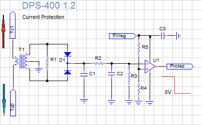

Sadly to report that the DPS-400 is not short circuit protected.
My DPS-400 arrived and I started to test it, but I was disappointed.
Results:-
1- While the SMPS is connected to the 220VAC line, MOSFETS heat sink reaches 48C, SMPS not loaded.
2- SMPS Loaded 480W voltage drops around 18V.
3- Keep the SMPS connected without load, and try to restart it, some times it starts, some times it refuse to start.
4- Over current works OK
5- Short the smps output, and connect it to the 220VAC line, it wont start ( protection active)
6- Start the SMPS, and SHORT the output, BLOOOOOOOOOM

dps-400 have shortcut protection, it use differential sensing of current as you can see with ring toroidal near power-unit.
maybe this unit have defect...not know.

this circuit is visible at rear of power unit, it use green or orange ring toroide in DPS-400
