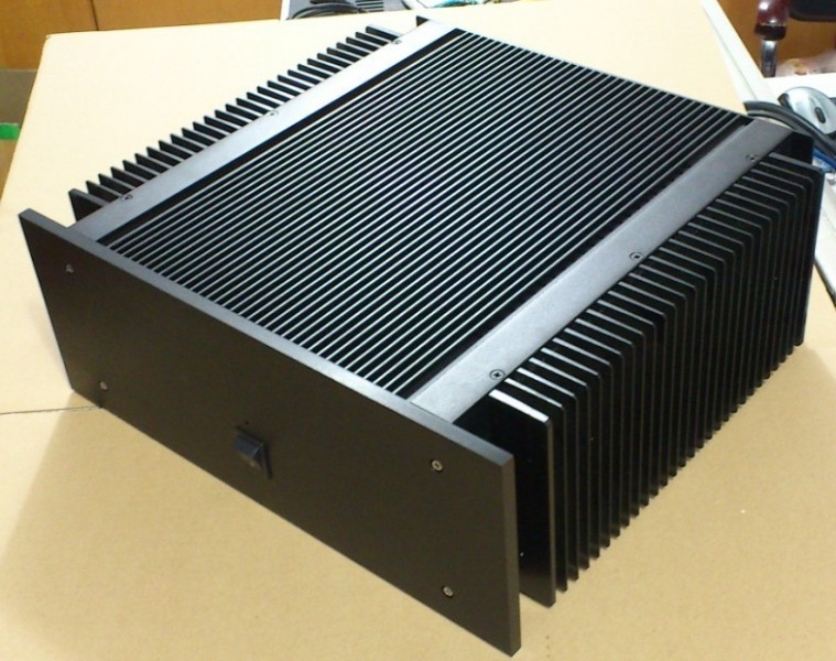

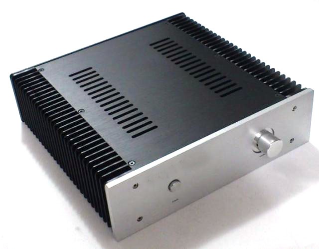

BuildMeSomething: check out the siliconray chassis, they look pretty decent
siliconray
some dont really have enough heatsinking for their size, but not too bad and the price is right. pity there is no thermal rating for them. all panels are substantially thick alloy which is nice and are CNC, the first one would look to be suitable for your rail voltage/wattage. another larger one and the largest which looks quite nice as well i'm sure you could negotiate getting them blank, or with different holes for hardware. disregard the last zero in the pricing, they manufacture them afaik so we could perhaps organize group pricing as they are for the N-Core guys. the shipping isnt great, but for the size its not too bad and a group shipment might be able to be organized.
I have no affiliation, i just spotted them a couple weeks ago and they are forum sponsors
