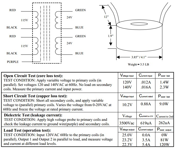

Hi Seb,
Perhaps the attached Antek datasheet will help clarify a few things. Generally speaking, the transformer manufacturer will specify a nominal secondary voltage at a current output that (in conjunction with the output voltage) is equivalent to the rated VA of the transformer. In your example, the manufacturer is likely stating that if you draw 2A from each secondary, the nominal expected AC voltage on each secondary will be 25V, and since there are two secondary windings, you get 100VA from the transformer. You should be able to draw this amount of power continuously without overheating the transformer.
Now, if you look at the datasheet for a similar Antek unit, you'll see that the secondary voltage will vary anywhere from 25V with no current draw on the secondary (0VA delivery) down to 22.3V with a 5.4A draw on the secondary (120VA delivery). Basically, as you draw more and more current from the secondary, the resistive losses increase, and the secondary voltage starts to decrease. This is not a linear relationship however, and the transformer will not just adhere to a 100VA envelope. It will continue to deliver more power until one of the following happens:
- The resistive losses in the copper cause the transformer to overheat and melt its insulation (causing a short)
- The internal fuse of the transformer trips (if it has one)
- The fuse before the transformer trips (if you added one)
- You draw enough power to either saturate the core significantly, or the copper losses become dominant.
I have never tested this, but I would imagine a 100VA transformer could easily deliver in excess of 200VA or more for a short duration (a few seconds) with no real negative side effects. The problem is that you need a way to make sure you don't draw that much on a continuous basis, or you risk causing a fire or permanently damaging the transformer.
You can get an idea of the resistive losses by looking at the same attached datasheet which shows that if you short the secondary completely, and increase the primary voltage until you're drawing the specified VA rating from the input of the transformer, then you have about 9W of losses, which is essentially the amount of power you would expect to be continuously dissipated in the transformer at its maximum rated VA.
The core losses can be seen in the open circuit test where the secondary winding is left completely open and no power is delivered to the load. Even under these conditions, the power dissipated in the transformer is about 1.4W which is a result of hysteresis and eddy current loss.

160VA:
In my particular case, part of the reason for my original query was if I could "get away" with the salvaged PSU parts then this project would be a goer, but if I had to buy new transformers it'd probably have to go on the back burner for a while. Also the 100VA (3.5" Dia) transformer fits nicely into my vertical, chimney cooled case. 160VA or even 120VA (over 4") wont fit, though of course this is not essential.
Seb
So the upshot is that if the amp is pushed close to it's limits (with this power supply) the first sign of trouble would still be clipping? as usual. As the load increases, the voltage drops, leading to clipping before the onset of melting insulation or blowing internal fuses. Hopefully I'd have the prescience to 'back off' at the first sign of this. But as a precaution, I thought I'd put a fuse in series with the primary coil (primaries connected in series for 230v mains here in the UK) but not sure what fuse rating to use? or if it would be better to have two fuses in the secondaries… or both?
You will absolutely need a fuse one way or another. I generally don't give advice when it comes to safety matters, but using a slow blow fuse at the transformer's rated power (figure out how much current it draws from the mains at 100VA) would be a decent place to start. The problem with clipping is that it doesn't actually reduce the power drawn, so even as the amp starts clipping it will continue to draw more power from the transformer.
Could I "fix" the gain so that it never reaches the destructive stage? As I have to have an I/V converter/LPF/buffer between the DAC and the Wire Amp, could I "set" the gain of this buffer so that the amp never clips…? Just thinking aloud here.
This would be ideal for many reasons, and you should absolutely optimize the overall system gain to only allow minimal clipping (or no clipping if you prefer).
Along with making sure you won't destroy the amp, you will also be minimizing noise, and maximizing the dynamic range of the system.
Regulation:
Didn't think I could regulate the Mosfet supply. I'm aware of the benefits of a separate, higher, regulated supply for the LME stage. Since so much effort has gone into the very good low noise credentials of this amp, it does seem a shame to undermine all that by putting it all back with a noisy, budget PSU. I'll look into a regulated supplies.
If your target is 25W of output power, then you certainly can regulate the output stage and the front end together. You will need a regulator capable of 3-5A which leaves you with a few options (I'd suggest the LT1185).
Try to build the supply up with what you have, but leave room for a few more filter caps, and possibly a pair of regulators and heatsinks. If you feel like trying it in the future, you'll have the space to do it.
