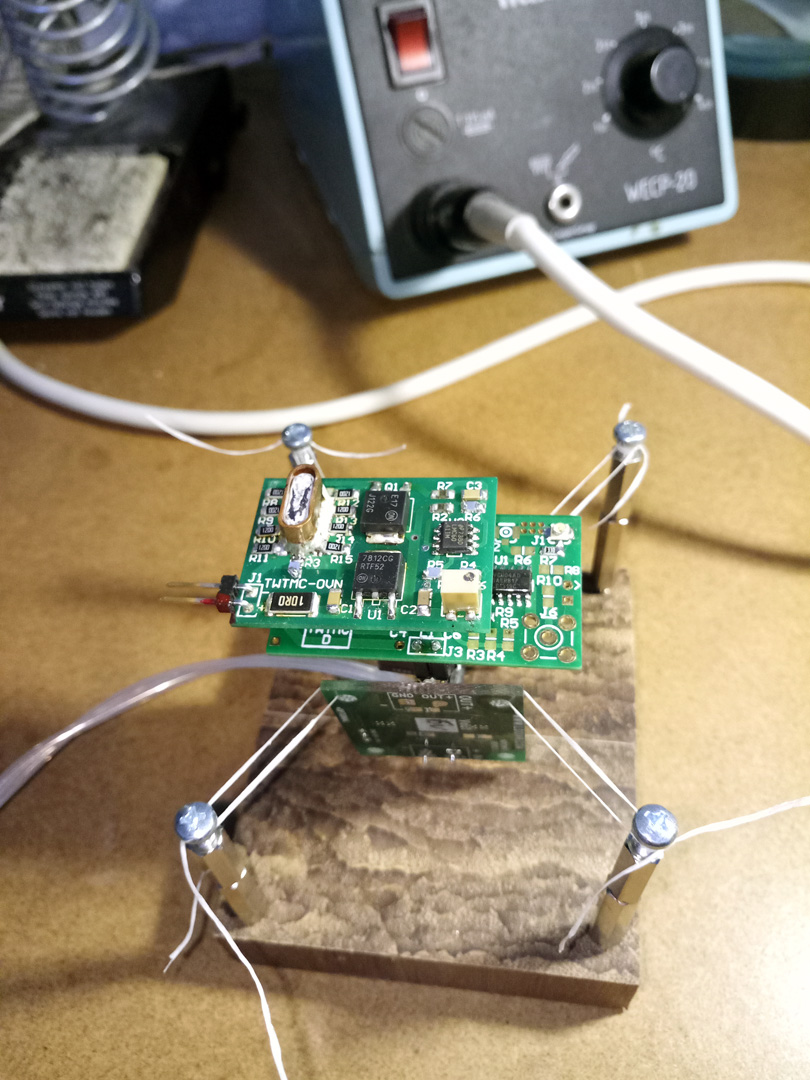

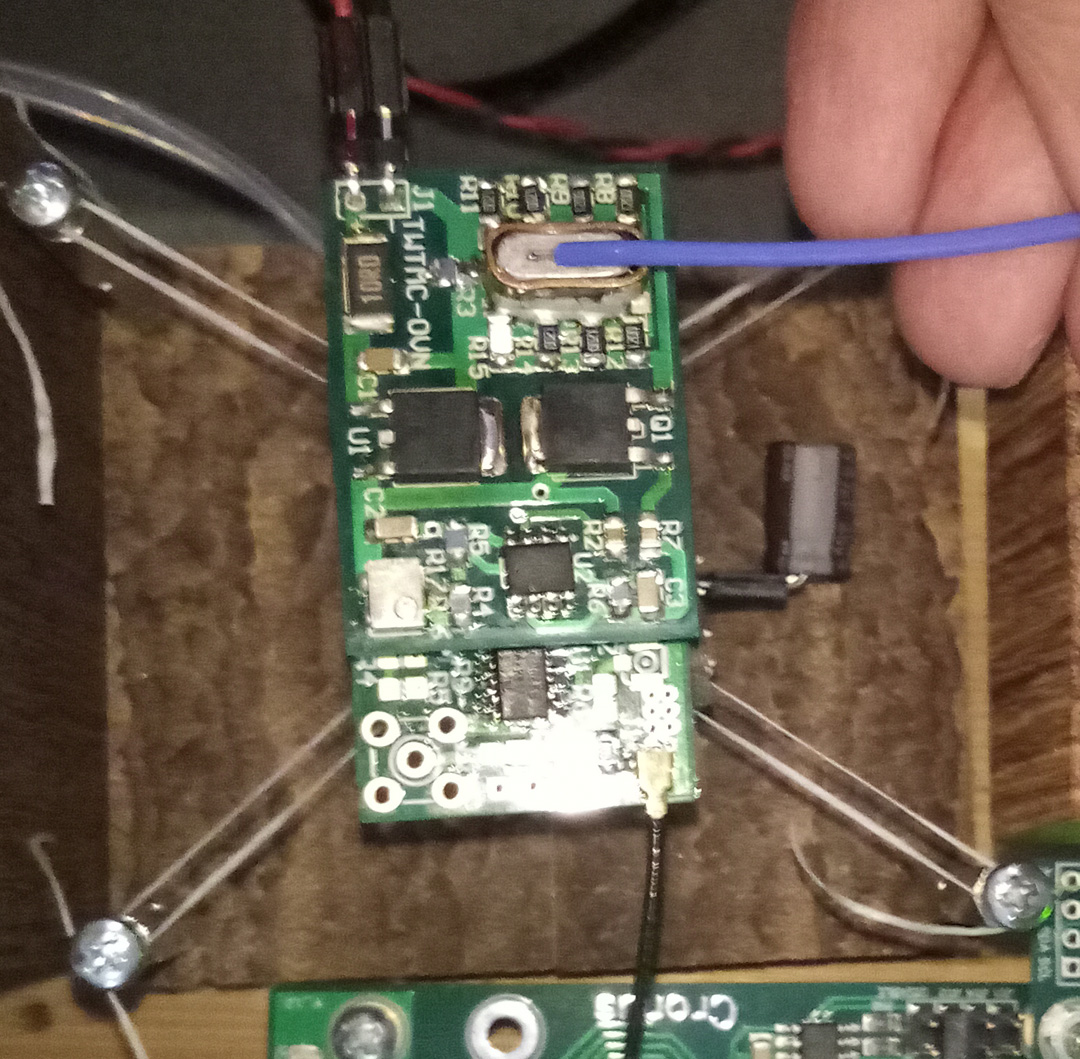

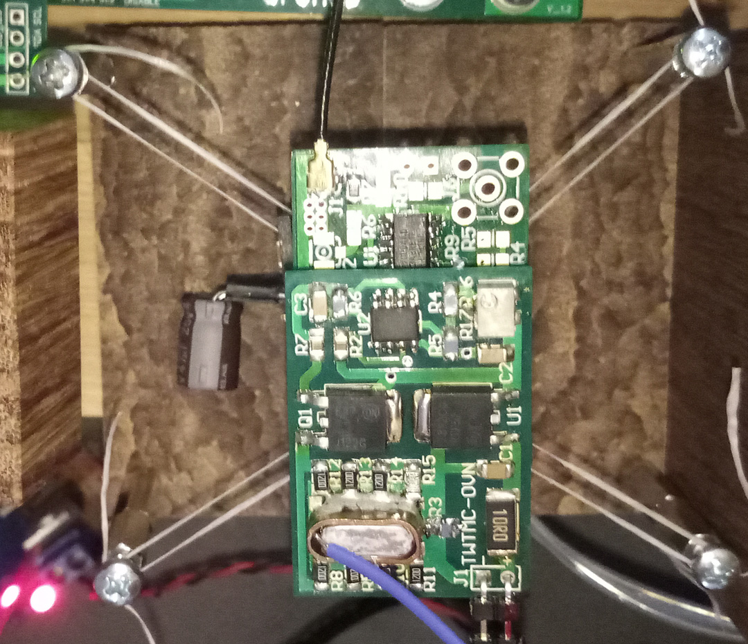

hi everybody,
i just want to give an update on my recent tests regarding the twtmc.
as reported before, isolating of the x-tal using rubber bands in a 4-point suspension revealed a more relaxed and natural sound , however, i found that the rubber bands lead to some kind of undesired resonance effects as well. to avoid that i got a tip from a friend to use tight "strings" instead of the rubber bands. so i replaced the rubber with "dental floss" (also a tip from a friend ;-) ) and the results ... wow! very spatial and very detailed sound without any undesired resonance/oscillations !

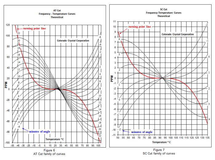

furthermore, i tested the influence of the oven temperature on the sound quality perception for 70°c - 100°c. the temperature was measured by a pt-100 probe and a dmm. i found this probe has advantages over the laser point infra-red, since the pt-100 has relatively small dimensions and you can almost scan the geometry at a resolution of 2mm x 2mm (or even less) whereas the ir-probe integrates the temperature over a bigger area and suffer from geometrical inaccuracy.
i measured the temperature at 2 points on the x-tal surface; one at the edge closed to the oven surface and one in the middle of the x-tal. the temperature at the edge is about 2°c higher than the middle of the surface. i assume that the temperature in the center of the x-tal (middel in the oven) should be few degree higher than on the surface.
results: the sound quality perceptions changes very clearly within the tested range. i want to claim that one would be able to hear even changes by few degree! i found the best temperature for my taste in my set-up at 89°c in the middle of the x-tal housing (91°c at the edge to the oven). i would describe difference in sound quality perception with increasing the temperature up to 89°c as follows: the sound gets somehow "richer" , the resolution gets better, especially for higher frequencies, and the overall performance gets more "livelier" and emotional. increasing the temperature over 91°c results in a bit harsh and less pleasant sound compared to 90°c.
again, the perception on the sound quality is not something "absolute" and can vary from person to person and from set-up to set-up! however, regardless how "good" an audio set-up is tuned to be, we know that every system has its weaknesses and by improving a certain part/unit of the set-up , other weaknesses of the system come more into the light because we bring the system out of balance! (this is why we improve and tweak endless to reach the perfect sound :-D ). imho, the balance/harmony of a system is primarily responsible for enjoying the music and not how perfect each unit "individualy" is tuned! sometimes it is even much better to use a less perfect unit as long as it masks the weaknesses of the rest of the set-up and delivers with it a more "balanced" performance. it means, if i enjoy the sound of my set-up at 90°c does not mean necessary that this is the best "working point" of the sc-cut xo. it just means that my system shows the best "harmony" at this temperature and the weaknesses of the set-up are less audible!
however, interesting is that the higher temperature around 90°c corresponds somehow more with the diagram of the sc-cut found in the forum. on my 45mhz x-tal it is labelled 81°c and my 49mhz has a 87°c label. maybe andrea can comment that and his recommendation for 82°c.
i would very much like to see if anyone else has already done similar tests and can share his/her findings and opinions?

@mr_whocares: Hi & thank you very much for sharing this ;-) ...
I have not yet myself tried out the effect of mechanically isolating the crystal but I will soon build a small block for the crystal (panzerholz, silicone, tungsten?) I use and then suspend it with wires/something else - along the lines of what you have done. I also remember seeing a picture of Herbert Rutger's setup while (I think) he was developing his oscillator ... He hung the crystal in thin curved bended wires above the PCB so that vibration from the PCB was absorbed by the curved wires ... Might be an EMR issue with e.g. 98 MHz crystals but IMO otherwise seems like a good idea in order to completely isolate the crystal itself.

mr_whocares, thank you for taking the time to share your findings with us. You might try to put the clock/oven PCB on a small piece of hard wood and then suspend the whole "assembly". This, supposedly, will further tame the low frequency micro-vibrations. I've heard some folks even add piece of lead for additional weight
