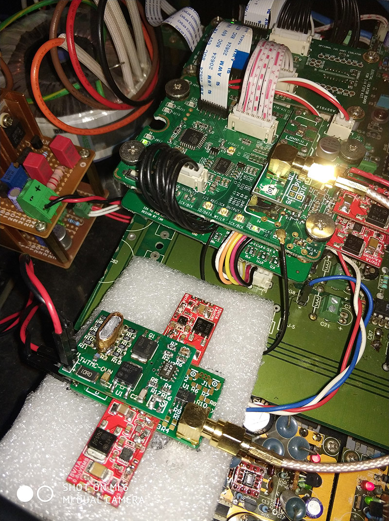

Hi clsidxxl,
Well, this is it. It ain't pretty. The red ones are the LT3042 regulators. I got another 2 to power Ian's clock & PCM boards. From the spec, I bet Acko uses the same LDO.
