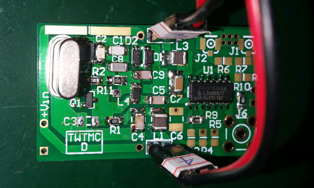

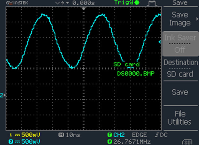

Hi Andrea,
I finally got all the parts and built the 24.576Mhz SC-Cut Driscoll. First, I got a problem of incorrect "start-up" frequency. When it powers up the first time, it will always be 26.7671Mhz. Restart the board, it will become normal (24.576Mhz). I soldered the 12pf C3 and there is no waveform (stop oscillating)! So, the C3 trick doesn't work for me. When I soldered the 74LVC04, here comes the second problem (perhaps they are related). It won't oscillate unless the probe or my finger touches the circuit, especially the XO case or the input trace before 74LVC04 (like 47k R9). Any ideas?
PS. Q1 is MMBT5179 as suggested from previous post. All part values are from BOM, except 100nf ceramic which is C0G. R11 is 68k instead of trim pot. C3 was measured 1/2 VCC (3V).

Hi Poting,
C3 capacitor is needed to suppres the unwanted B-mode, without C3 the oscillator starts at 26 MHz instead of 24 MHz.
Seems the MMBT has not enough gain, try replacing with BFR182 or NE85633-R25.
Andrea

With C3, it won't start. As you mentioned in the previous post, MMBT should be fine without selection (?). I guess I have to try BFR182 or NE85633 this time.
I know I said that MMBT should be fine without selection, I tried several parts and the oscillator did start always at the right frequency. Also, I used the MMBT for the finished boards I have shipped without any problem.
Seems the hfe of the MMBT varies a bit from a batch to another.
As soon as I find the time I will try other BJT.
