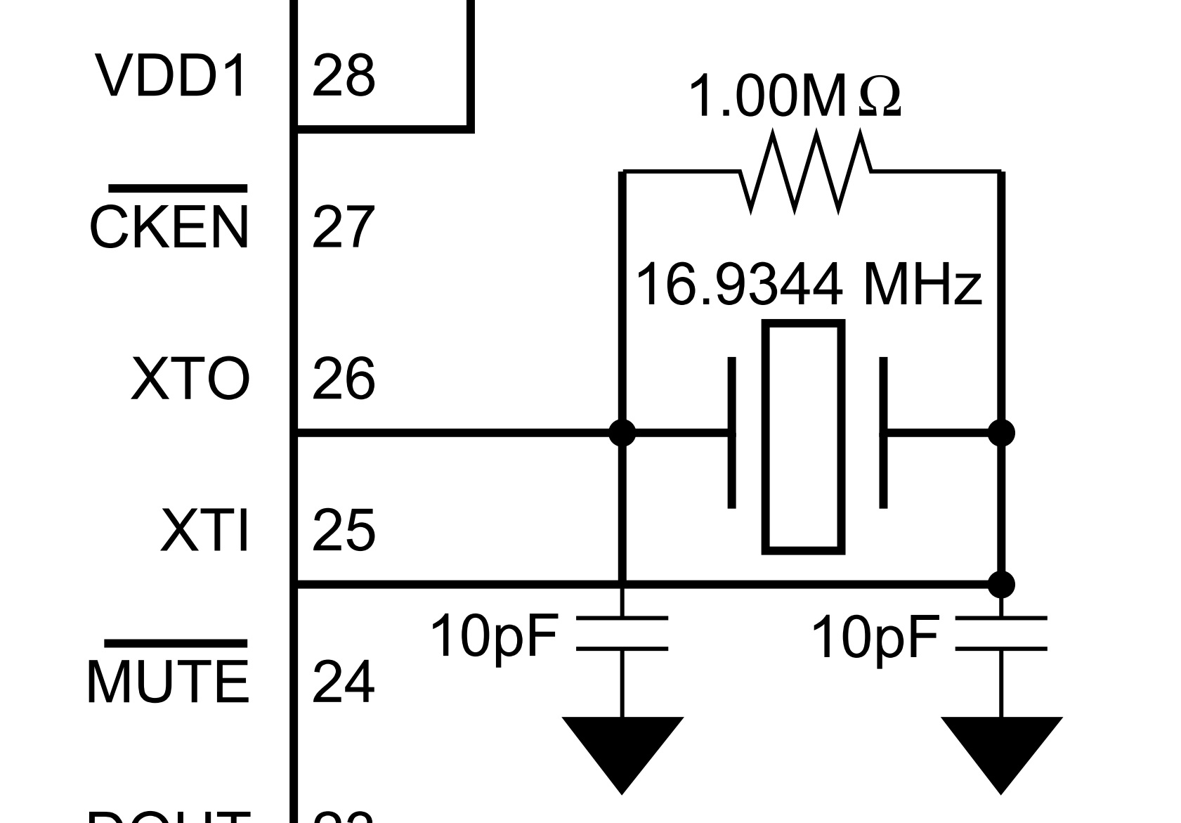

I just realized that the decimation filter of the ADC allows to be set to accept a 256fs input, which translates to 11.2896 MHz.
Currently there is an oscillator installed, but either an external clock (applied to Pin XTI) or crystal oscillator (Pins XTI and XTO) can be employed. AC coupling is required for an external clock.
What would be the best solution in this case? I think for this value a group buy oscillator is availible, right?
Sorry for the basic questions and thanks again.

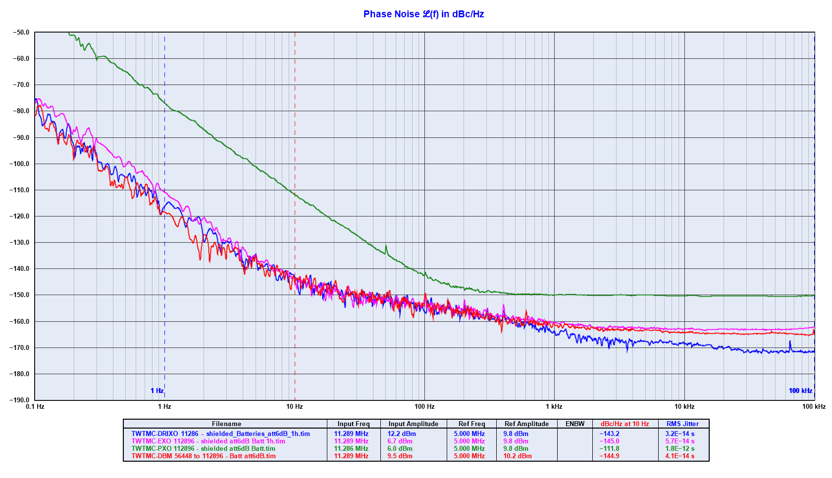

Well, at 11.2896 MHz you have 4 options, I attach the phase noise comparison:
- the TWTMC-PXO is the worst performer and the cheaper option
- the other 3 options have similar state of the art performance (almost -145 dBc at 10Hz and almost -120 dBc at 1Hz from the carrier), so I suggest the TWTMC-DRIXO with SC-Cut crystal at 11.2896 MHz

So I need a TWTMC-DRIXO-SF, the crystal, the parts from the mouser BOM and well-regulated 12-16V DC power?
How does it connect to the input of my converter's decimation filter (see attached drawing)? I want to put the device right next to the DAC PCB (in the same box).
According to the manual "an external clock (applied to Pin XTI) or crystal oscillator (Pins XTI and XTO) can be employed. AC coupling is required for an external clock."
I guess a sinewave is still an oscillator but the squarewave makes it a clock? So do I need the squarewave board? And for AC coupling - what would be the recommended capacitor?
