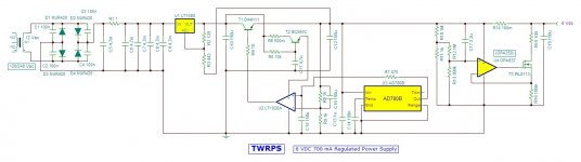

The starting point
After several simulation with different topologies of regulator the following schematic is the starting point to build a prototype.
First stage, rectification and filtering, use a CRC filter to well decoupling regulator from AC.
Second stage is an op amp based series regulator with preregulation using a monolithic IC LT1085. The reference of preregulator is the clean regulated output of the stage, such as in the Jung super regulator. Follows a conventional series regulation implemented by an LT1028 low noise high speed op amp and a classic D44H11. Voltage reference of feedback circuit is an AD780, very low drift 3ppm/°C. Op amp is decoupled from power supply with a 0.5 ohm resistor and a capacitance multiplier.
Last stage is a feed-forward shunt section, consisting of an op amp, a mosfet, a capacitor and a few resistors. This stage reduce the noise about 30 db and improve transient response. Based on a Maxim application note, it can cancel noise up to 1.3 mV. Best choise for op amp should be OPA350, but I'm note sure it can tolerate 6V power supply; data sheet indicates 7V as absolute maximum supply voltage and 5.5V max operating voltage.
I'm still working with simulation, then I'll order components to buld a prototype and test its real performances.
Any suggestions are wellcome.

I'm going to write some "Cardinal Rules" for regulators:
1) Regulate the clock Vcc/regulator separately from analog circuitry regulation.
2) Load the regulator for as much current as the pass transistor can handle (heat sinked of course.) If you have to, add a ballast resistor to accomplish this.
3) Don't skimp on trace width.
4) where you think you can use a 1/4 watt resistor use a 1/2 watt resistor.
I would take a look at the layout which Jan did for Jung's regulator and go from there.
