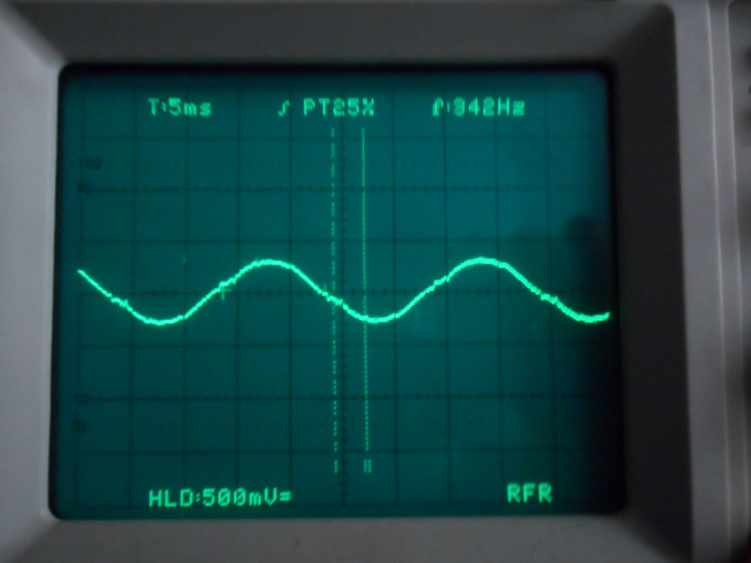

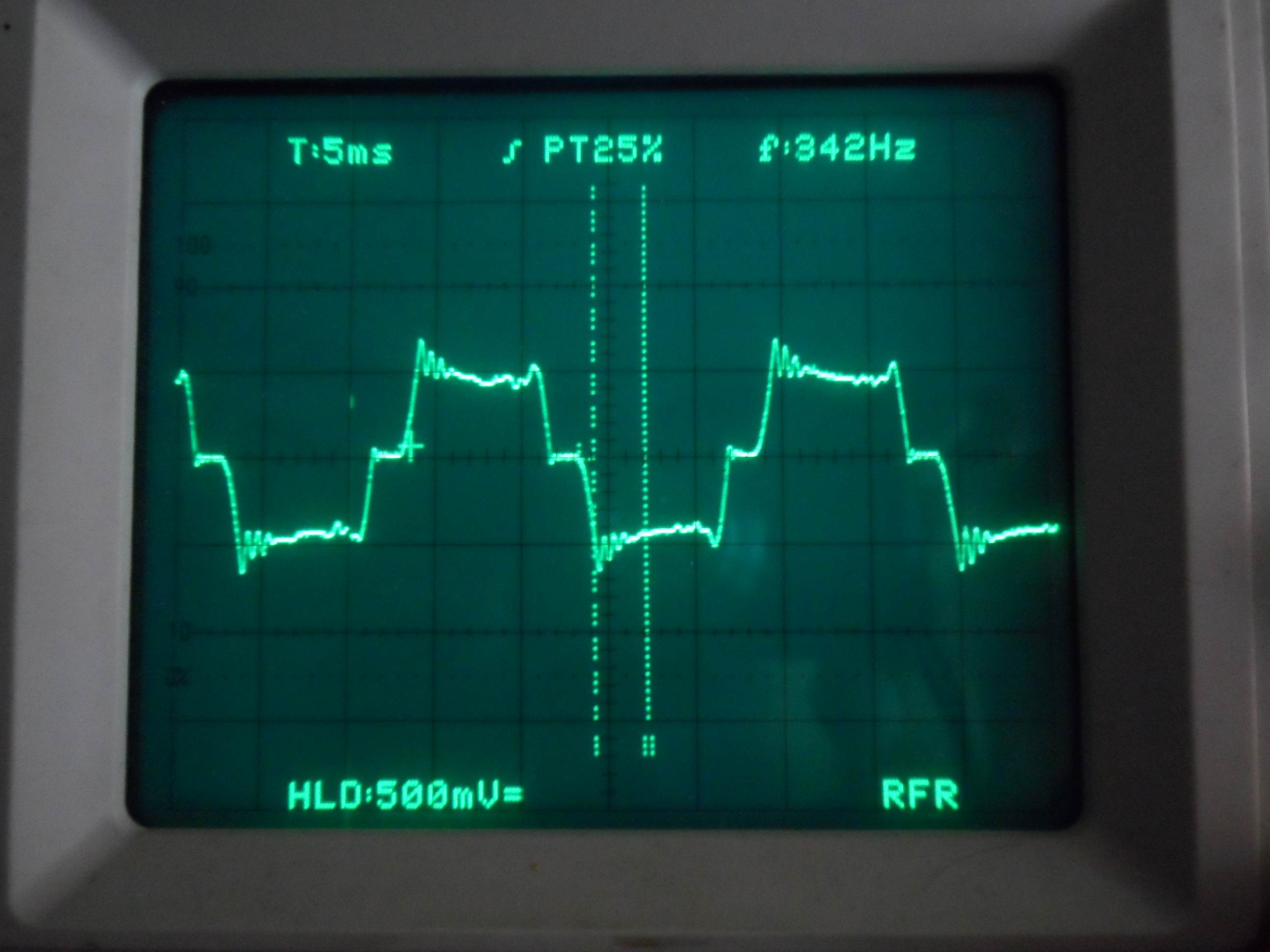

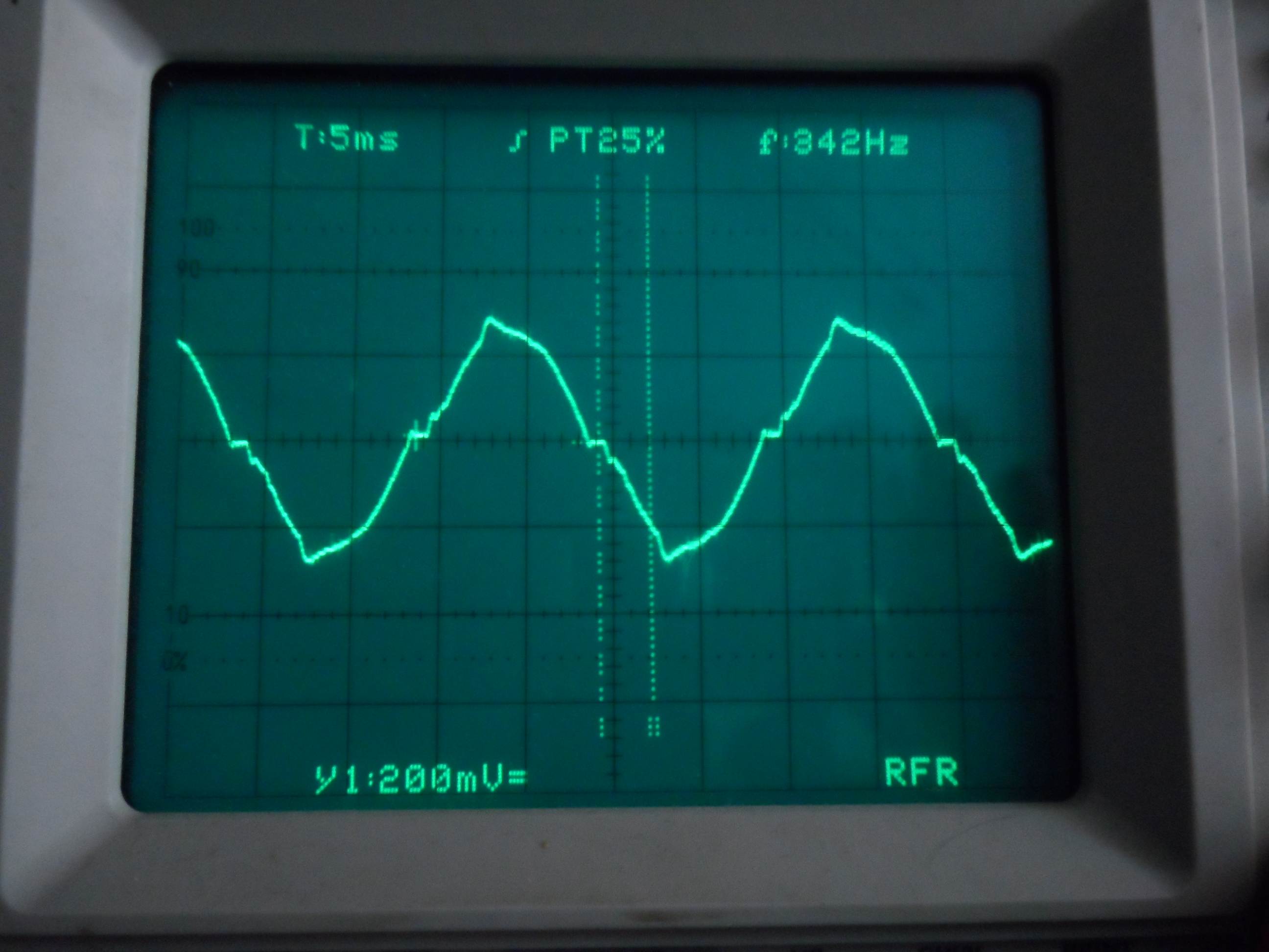

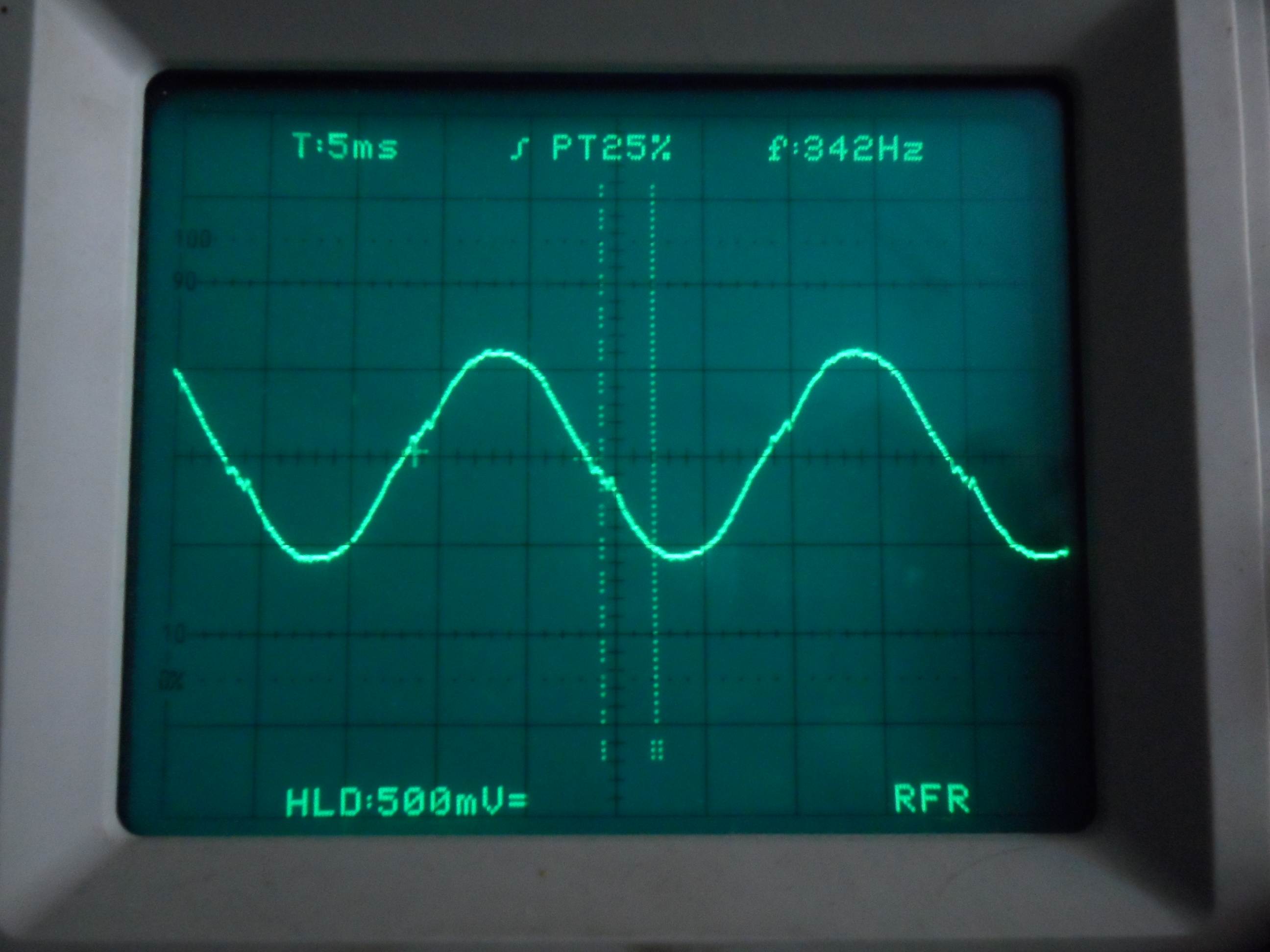

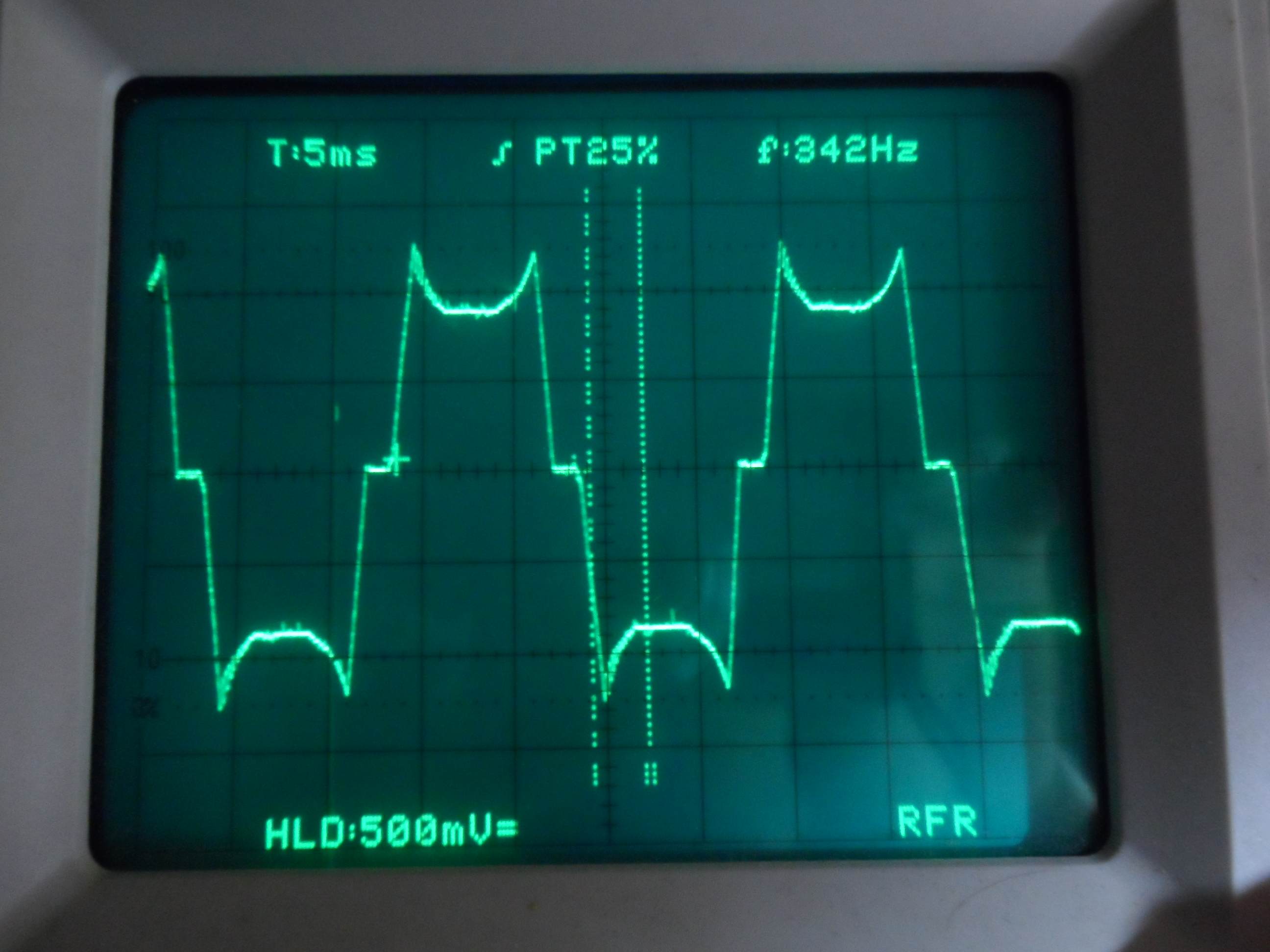

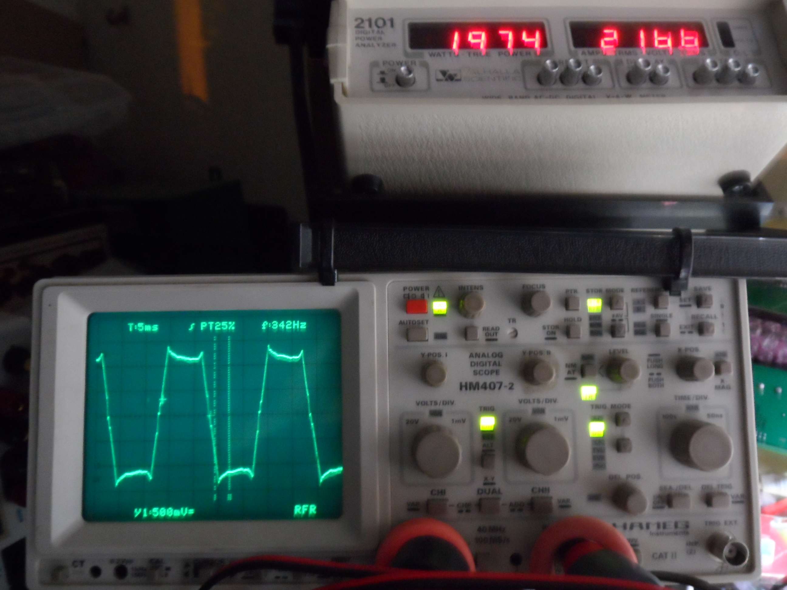

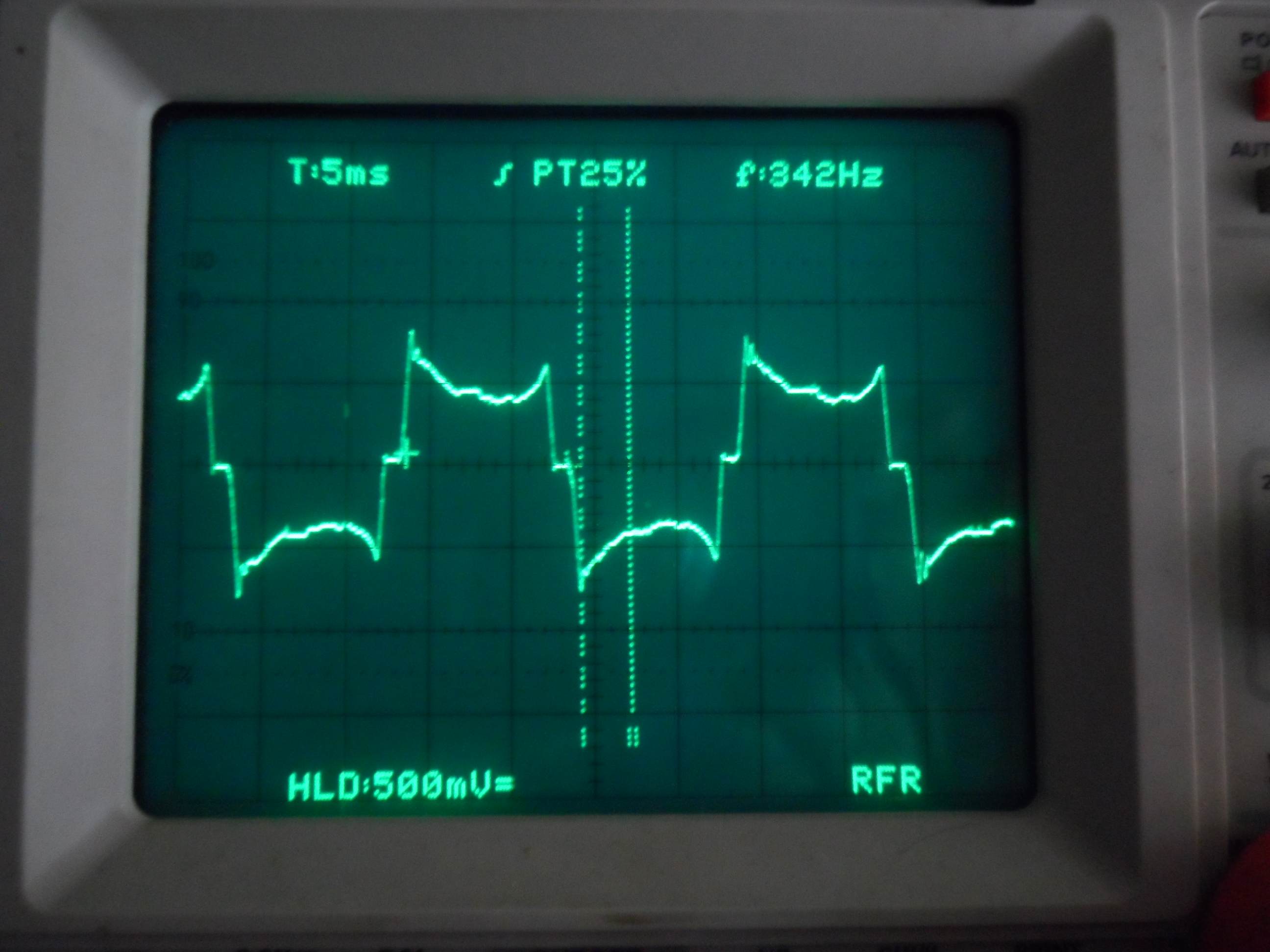

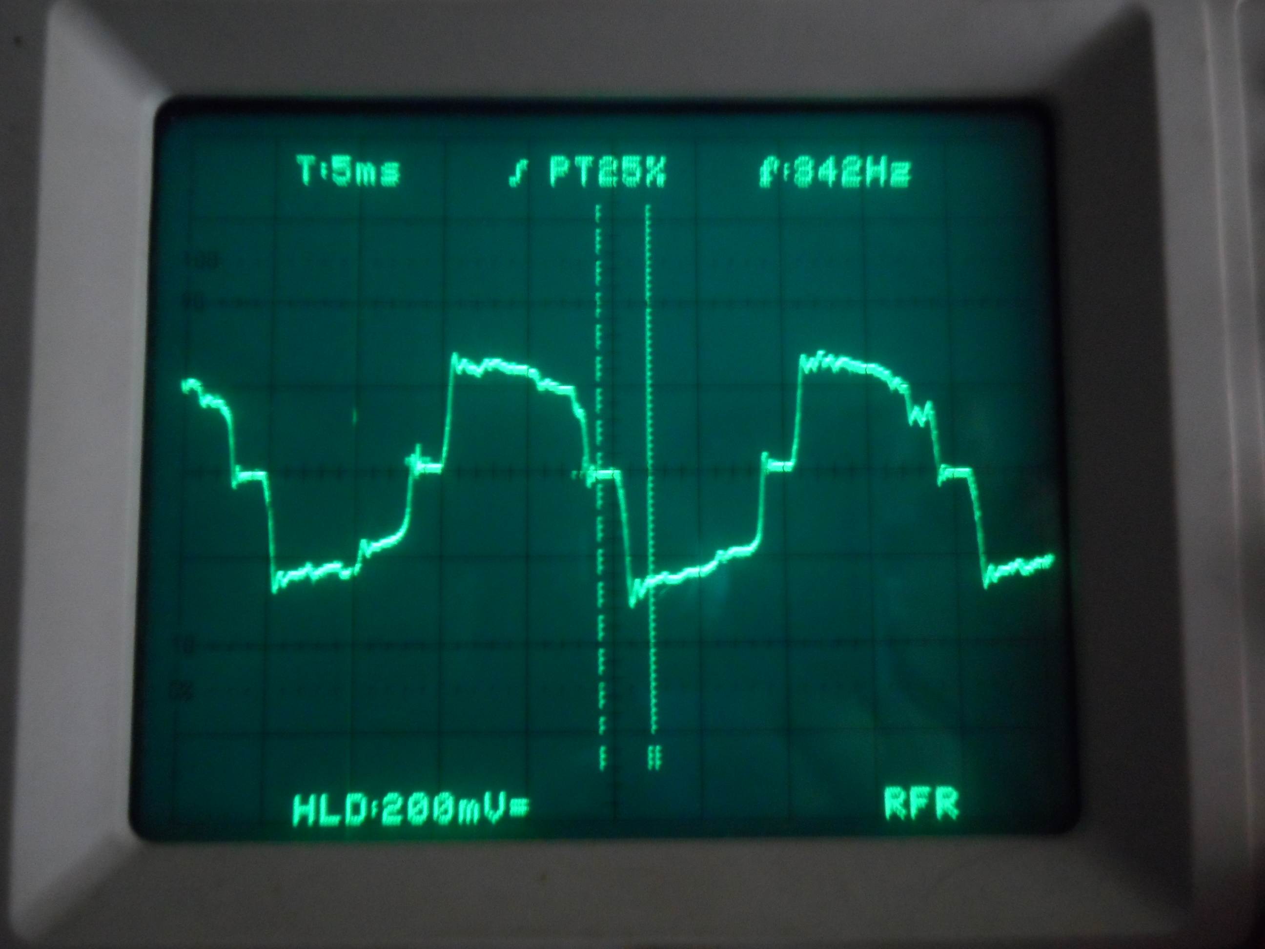

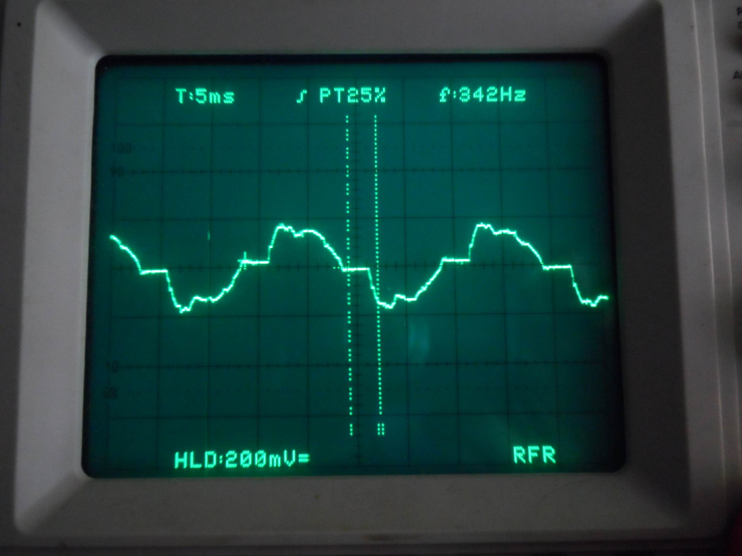

Low quality 120V mains was simulated by stepping 230V to 120V with variac before feeding 1:1 isolation transformers. Mid quality 120V mains was obtained with a setting close to 1:1 in variac and doing the 2:1 step-down with isolation transformers. Mid quality 230V mains was obtained with close to 1:1 setting in variac and 1:1 in isolation transformers.
This is what other brand calls "a PFC power supply". It's just a single stage rectifier with isolated output and wide input voltage range, implemented with a UCC2891/2/3/4 control IC not intended for PFC (fixed freq peak current control), waveform distortion is high as hell, harmonics are strong, worse than old diode bridge and caps, and instability arises at low quality mains. Steps in current waveform are observed at high-line high-load, maybe from a control loop with maybe only 16 discrete power levels possible. This is *cheap* design/copy (as Behringer) but a bit more rugged.
Pictures in order:
- line current @ 200W @ 120V low quality mains, onset of PFC regulations
- line current @ 350W @ 120V low quality mains falling to 115V
- line current @ 740W @ 120V low quality mains falling to 110V
- line current @ 860W @ 120V mid quality mains falling to 114V, stable overload
- line current @ 200W @ 230V mid quality mains, onset of PFC regulations
- line current @ 400W @ 230V mid quality mains falling to 226V
- line current @ 800W @ 230V mid quality mains falling to 221V
- line current @ 1100W @ 230V mid quality mains falling to 219V, hiccup in response to overload

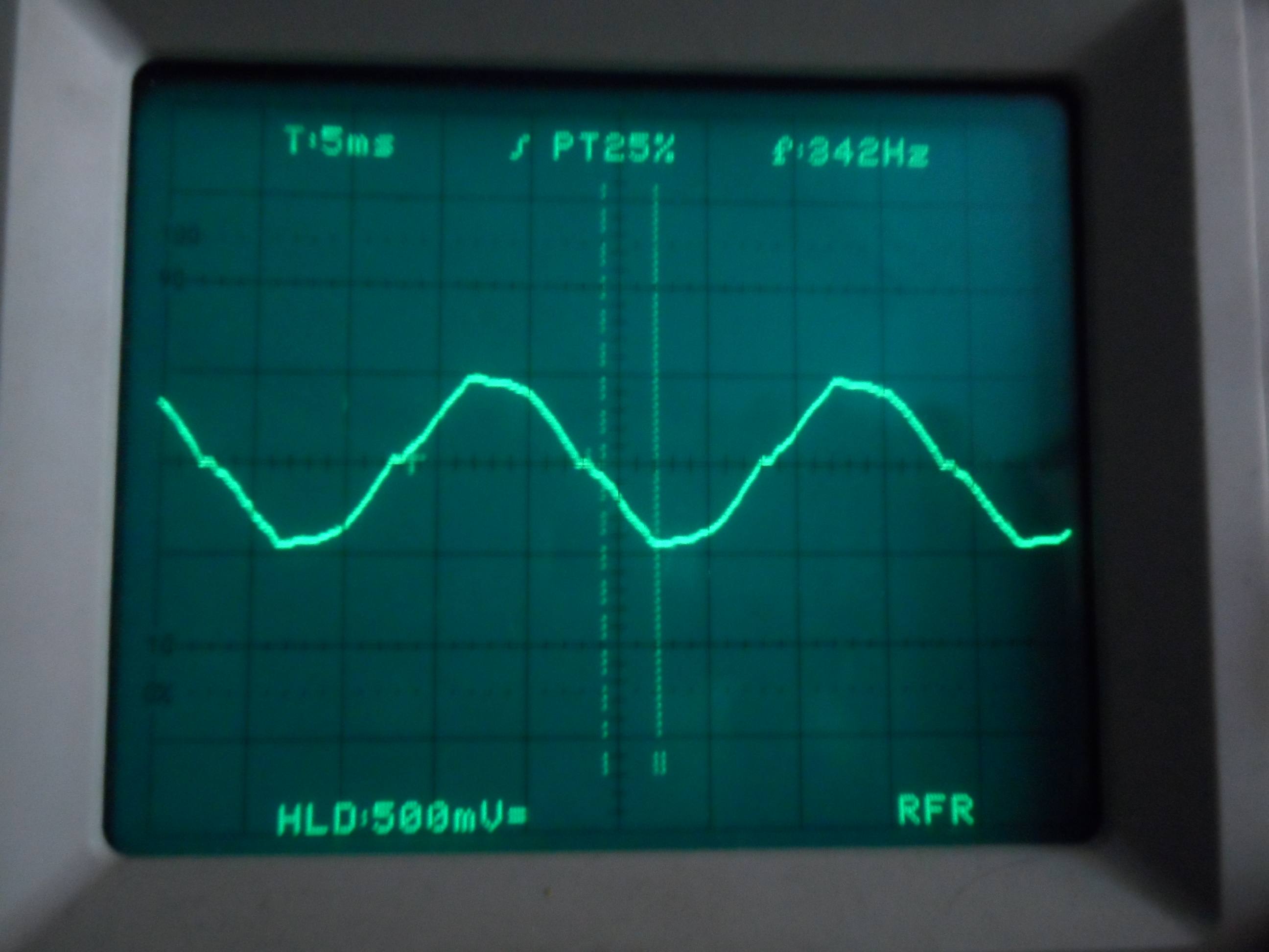

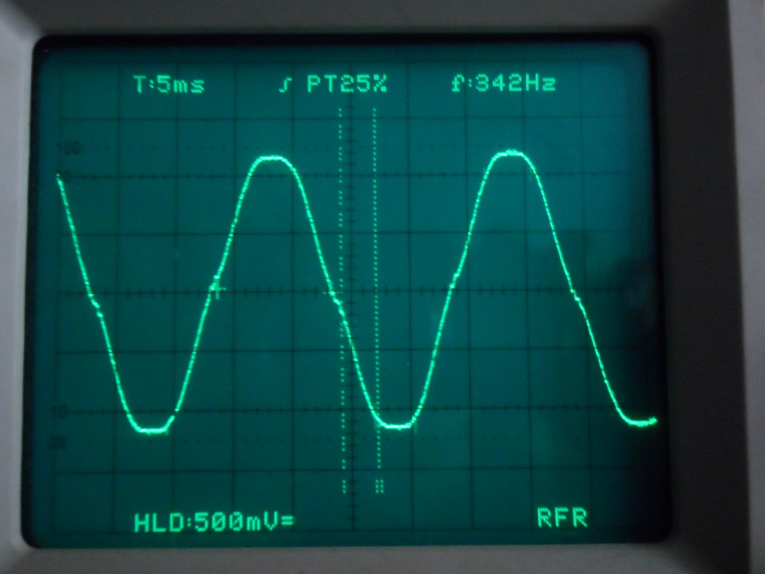

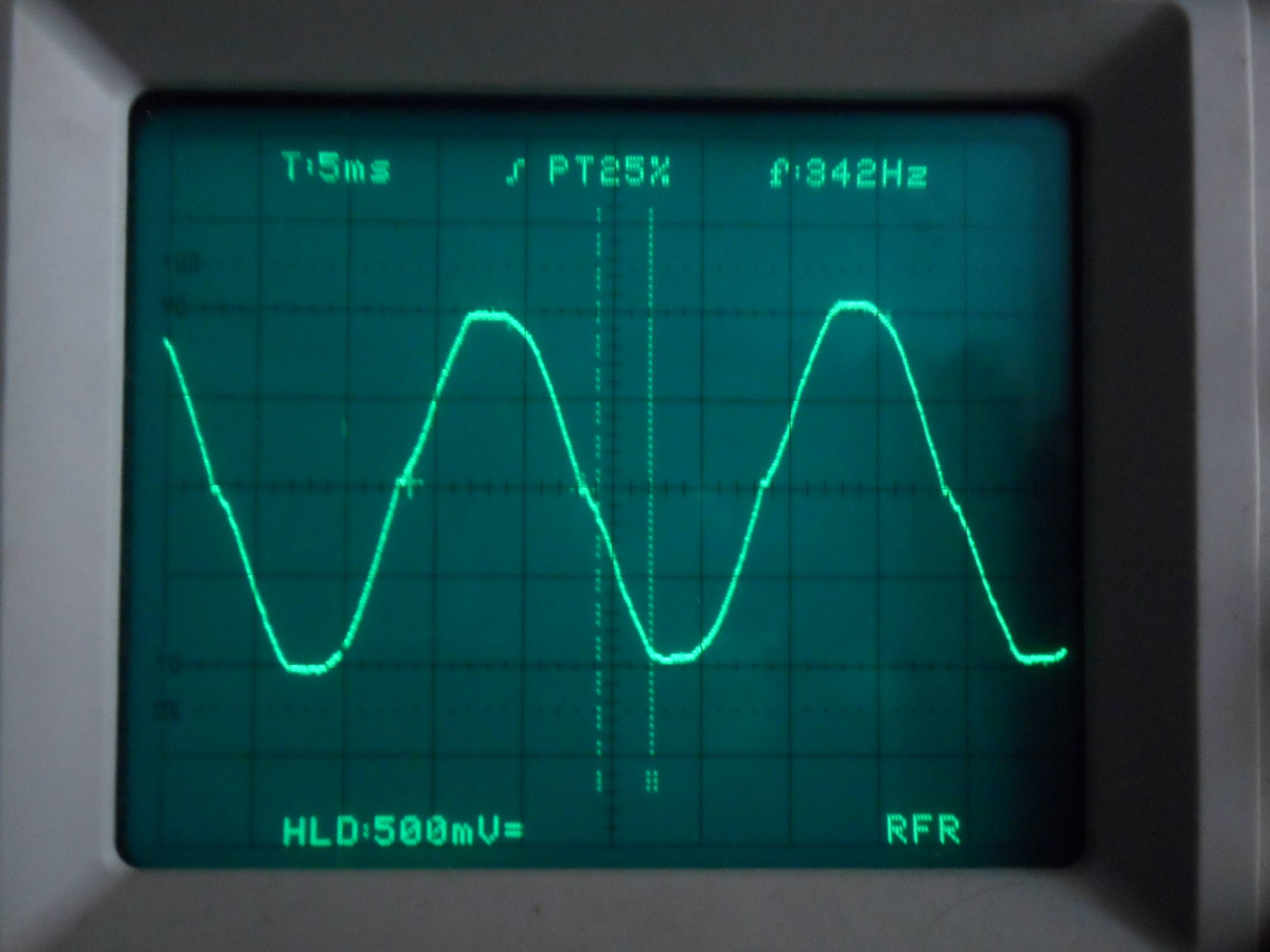

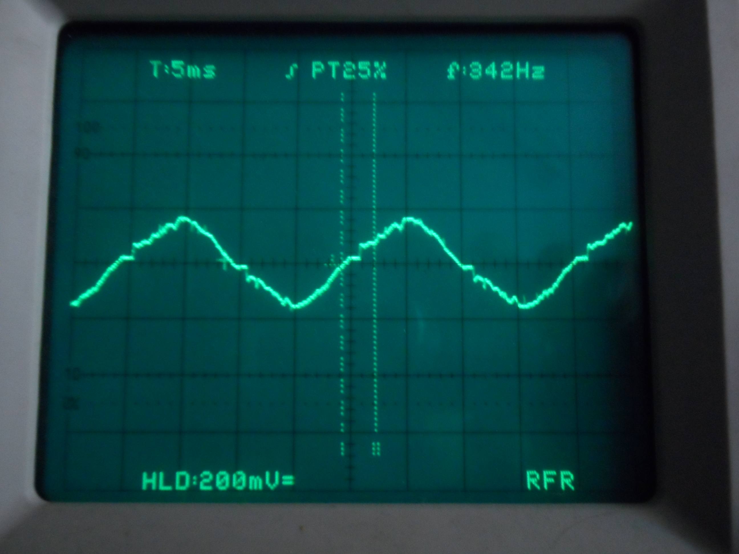

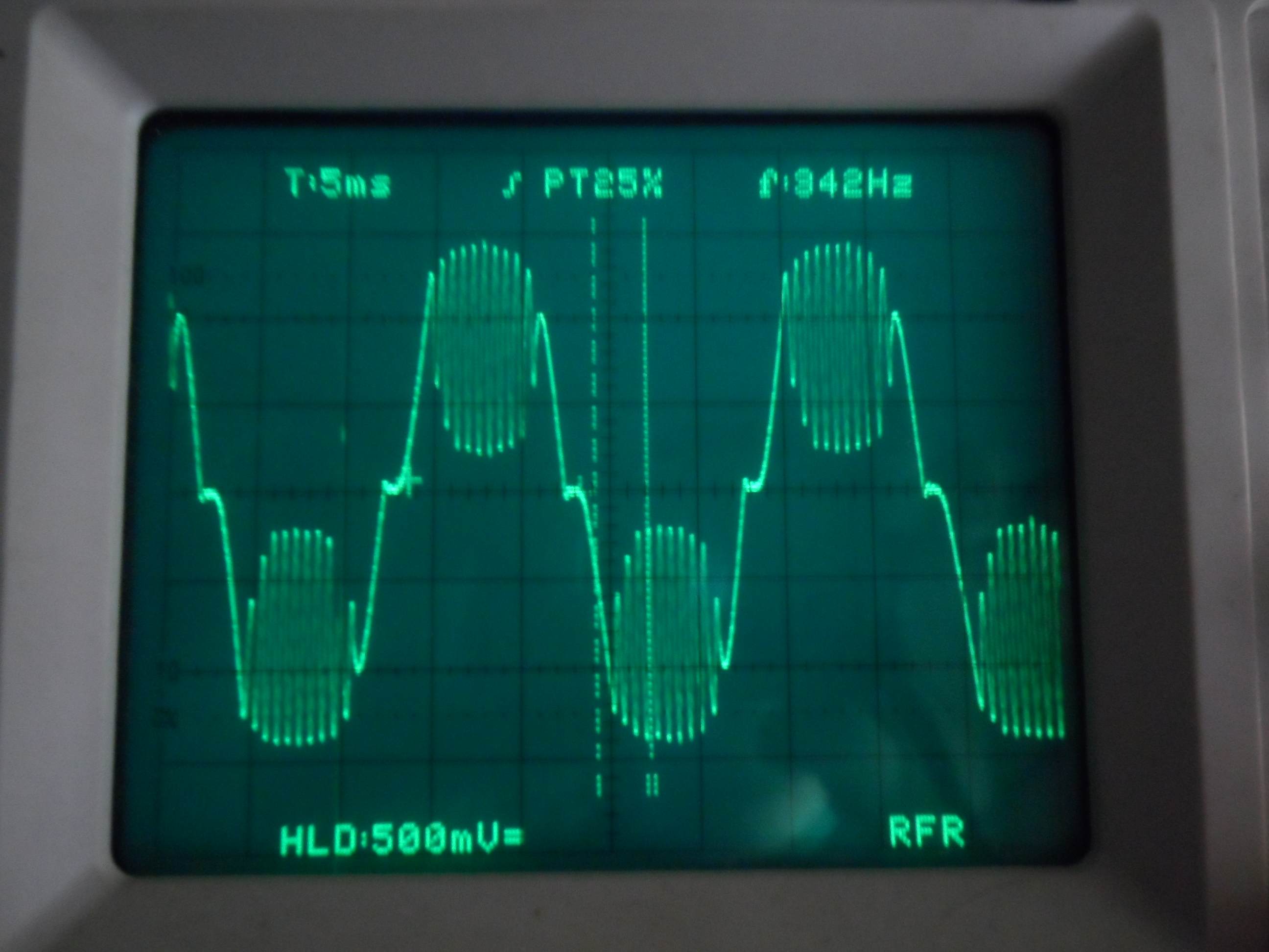

Thats very nice clean, low harmonics and nice overload behavior Shame not all PFC's are this goodThese images were obtained from a prototype of the circuit and control approach explained at the beginning of the thread. The result is very low harmonics and phase shift, nearly sine current waveform at all conditions, also on low quality line. Incidentally my implementation uses same size power stage as "other brand", but optimized with the help of hundreds of hours of engineering and a custom control technique I developed. This results in 2x the part count, being the difference mostly in the amount of small parts.

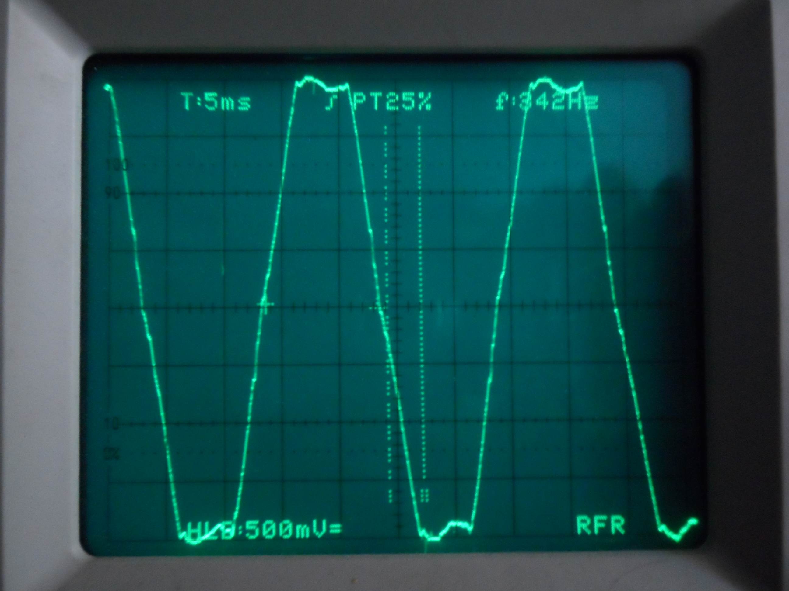

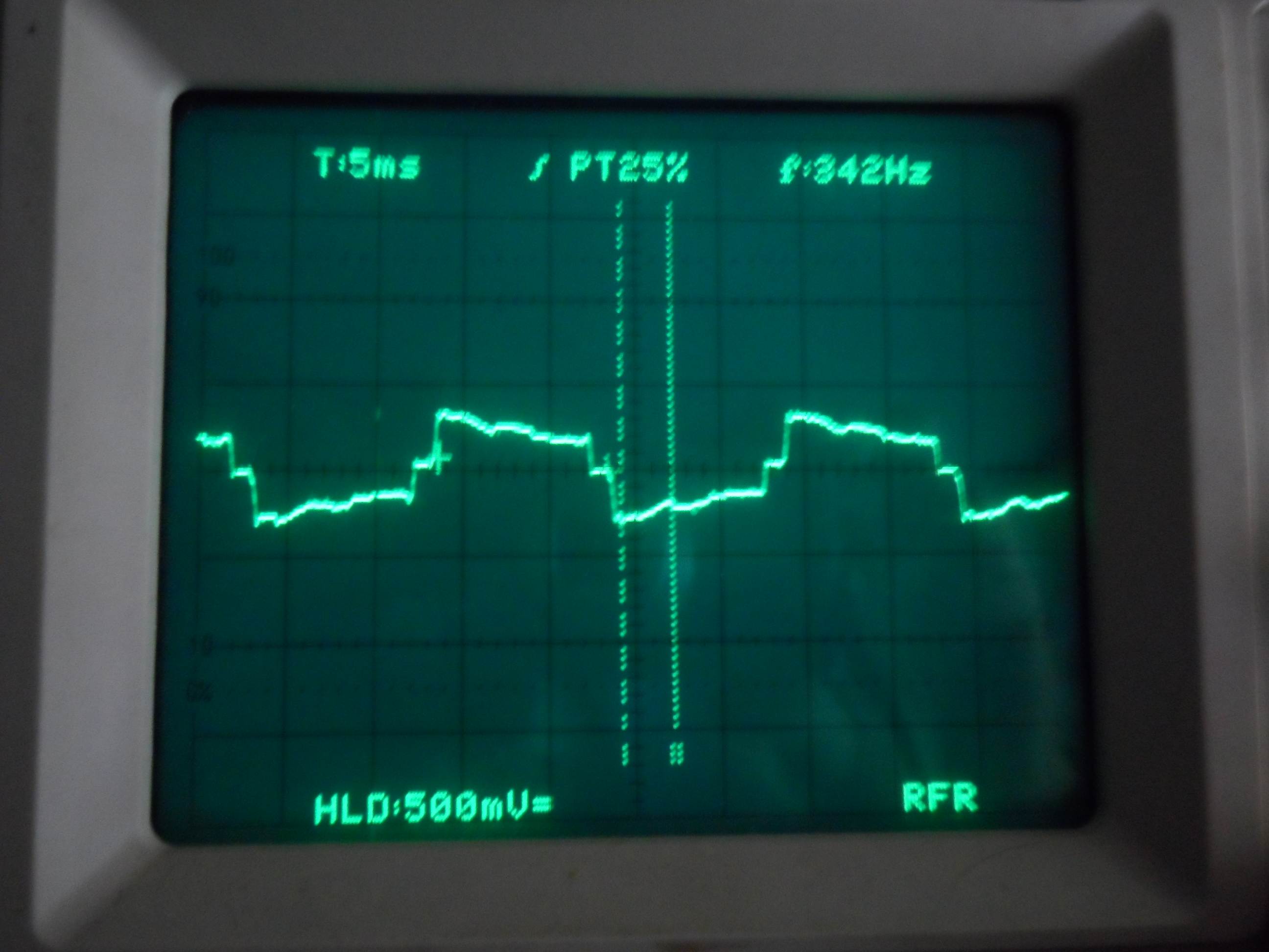

Pictures in order:
- line current @ 700W @ 120V low quality mains falling to 110V
- line current @ 1400W @ 120V low quality mains falling to 100V, stable overload (PSU)
- line current @ 1600W @ 230V mid quality mains falling to 213V, stable overload (amplifier)
- line current @ 2KW @ 235V mid quality mains falling to 215V, had to reduce amplifier dummy load impedance to overload power supply at 230V

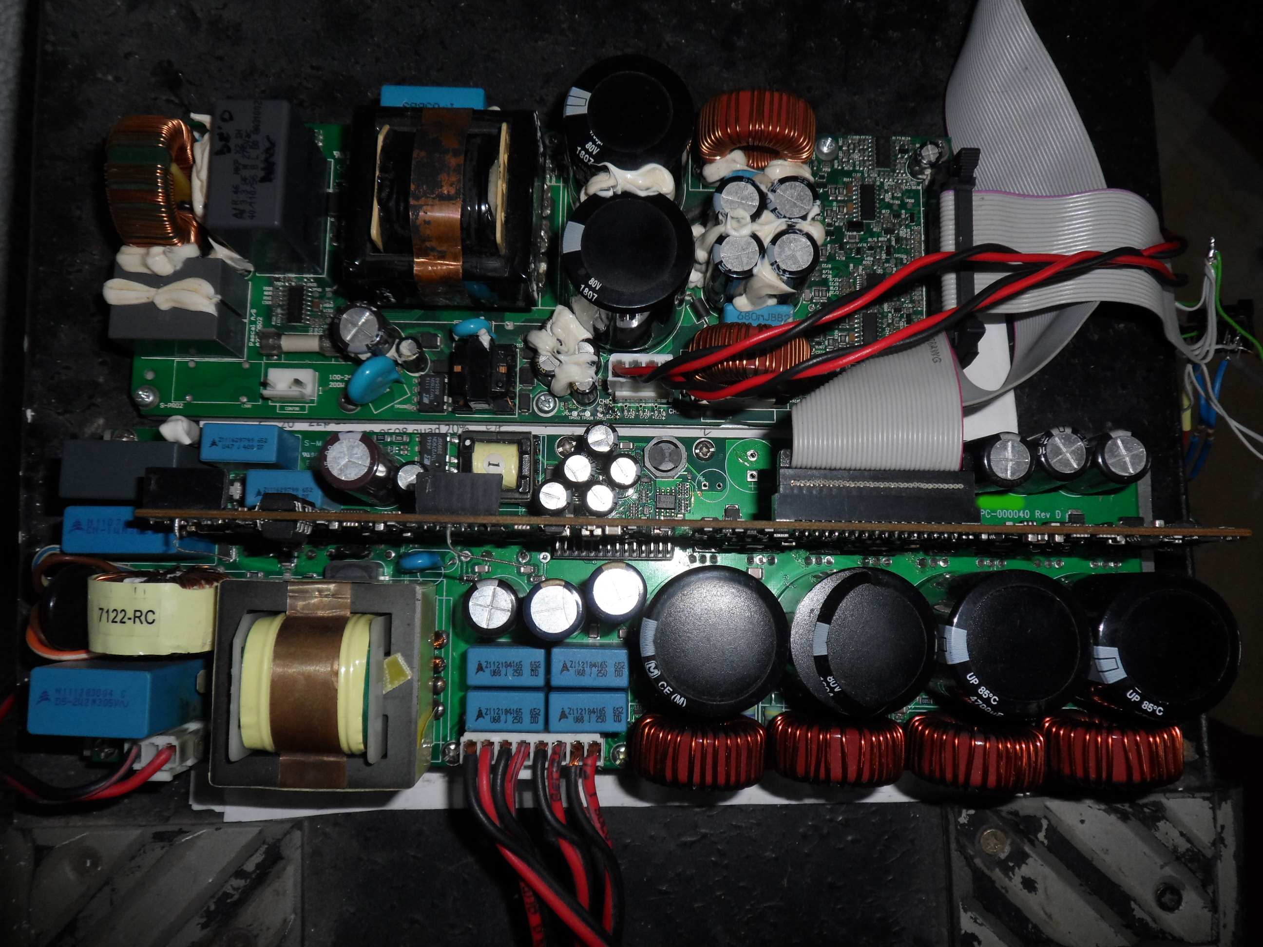

Yuks that's revolting, harmonic distortion terrible and they got CE for that ? well I guess it's self certified, perhaps you should report them!
The module has a "200W" comment in PCB near power connector, close to its long term power handling without fan, and also the usual threshold for PFC requirement. If the module passed that regulation it was probably due to complying as a <200W device, 1KW max. power, as audio equipment can be tested at 1/8 power. A module capable of 2KW no longer matches that criteria, 2KW/8=250W. So what the hell, lets do a reference design of audio PFC, that others would find difficult to improve, I thought.
Ahh thank you for explaining the audio wayleave, I knew it had one from years ago but could not remember the details, I have just been amazed that so much band gear I repair for friends doesn't have PFC. I was a little confused by your two modules side by side photo, is that altogether one power supply or does it include a classD amp ? Apart from the PSMC modules in the 16F178x I managed to use all the op-amps and comparators, good way to mop up some more chips but makes juggling the pins fun. I write all my code in assembler for these chips, like you say when you are doing lots of calculations/second you need speed and also very well defined short and consistent interrupt latency. I have considered doing these things in an FPGA in VHDL/Verilog however then it becomes harder to do the system level stuff but I think if I got into Mhz switchers with fast transient response requirements that's the route I would use. I hope you have put your innovative psu to good useThe module has a "200W" comment in PCB near power connector, close to its long term power handling without fan, and also the usual threshold for PFC requirement. If the module passed that regulation it was probably due to complying as a <200W device, 1KW max. power, as audio equipment can be tested at 1/8 power. A module capable of 2KW no longer matches that criteria, 2KW/8=250W. So what the hell, lets do a reference design of audio PFC, that others would find difficult to improve, I thought.

These modules are multi-channel class D amplifiers with power supply, another set of nice quizzes to solve in secondary side. So you say you have already used Microchip MCUs with PSMC? There is a new PIC16 flavor which includes remappable pins as in PIC32. Not much problem with the pins in the other parts as 4~6 layer PCB is used, and there were combinations possible to get optimum pinout (like current comparator IN+ and IN-, or GND, not very far one from another). Some inputs required external circuits for blanking, as the PSMC do not include enough options in this field.Ahh thank you for explaining the audio wayleave, I knew it had one from years ago but could not remember the details, I have just been amazed that so much band gear I repair for friends doesn't have PFC. I was a little confused by your two modules side by side photo, is that altogether one power supply or does it include a classD amp ? Apart from the PSMC modules in the 16F178x I managed to use all the op-amps and comparators, good way to mop up some more chips but makes juggling the pins fun. I write all my code in assembler for these chips, like you say when you are doing lots of calculations/second you need speed and also very well defined short and consistent interrupt latency. I have considered doing these things in an FPGA in VHDL/Verilog however then it becomes harder to do the system level stuff but I think if I got into Mhz switchers with fast transient response requirements that's the route I would use. I hope you have put your innovative psu to good use

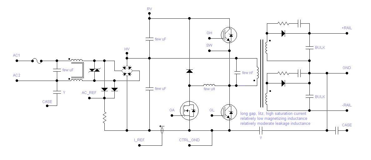

below a sim showing the drive voltage. at duty=0.5 it is a standard LLC drive. you need a 3rd switch that can handle bidirectional voltages.

The single stage isolated PFC problem can only be solved by flyback, or a more complex mix of boost inductor and transformer-capacitor coupling for higher powers, in other words, non-linear converters and non-linear control.
The LLC was introduced due to lower EMI and the need to market new control ICs and power supply designs, not because it shines in any other field.
