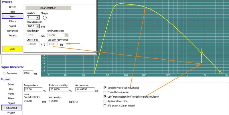

ok now im really confused. been reading a bit more and discovered that winisd calculates the 1st port resonance of your design. i says mine (with the 1.21m port) should be at 142.08 hz.
is that not the same thing as the 1/4 wavelength pipe resonance we are discussing?
why is it not at 70hz then?
and actually why can i not see its effect on the spl / transfer function graph?
if its really at 142 hz then im not concerned as i will be crossing over way below that.
Originally Posted by robinlawrie
Is this already simulated in winisd
YES See my screenies
If you havn't already, you should update the program http://www.linearteam.org/download/winisd-07x.exe
owww. i only downloaded winisd a week or two ago, this version is very new?
and what the heck is that "use transmission line model for port simulation" tickbox? it changes my box response completely.
It's the latest version, yours is a LOT older !
If you look Closely, i've merged 2 screenies that show the effect of Port Resonances, which you asked about
