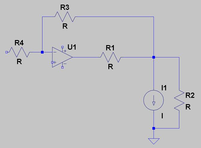

Mike, it looks like I was wrong. I did some simulations and it turns out loading the output with a current source will indead put one transistor into class a: conducting 360 degrees, under one important condition: there got to be a emitter resistor.
I used a modified Citation 12 (T-driver stage, complementary output stage) loaded with a 1amp CCS to the negative rail. The base for the upper driver / output device went up by a little bit, just enough to generate the needed current on the emitter resistor to satisfy the CCS. As such, there will not be any DC voltage offset: the increase in base voltage will be fully absorbed by the added voltage drop on the emitter resistor.
so two lessons:
1) there has got to be an emitter resistor;
2) the CCS should be bigger than the peak current generated on the load to the opamp. For example, if you are looking for 1v peak swings on a 1k load, the CCS should be at least 1ma. That way, you will completely avoid any switching and only one of the two output transistors will be conducting.

1) No...if there is no emitter resistor, the result , will be the some ,as the CCS have forced one of the output transistor to supply more current ( in your case 1mA) and he only left class A for more than 1 mA peak output current..
2)Yes...you got it!! ;)

intuitively, the unused transistor will turn off, unless the original bias is so huge.
one way I thought about is to tie a small resistor to the output before the feedback pick up. like the schematic below. R1 is selected so that its voltage drop (I1*R1) is about 50% of the peak voltage swing of the opamp.

janneman said:
Millwood, what do you want to accomplish with this? I don't understand the reason.
Jan Didden
the resistor is there so that even if the opamp doesn't have emitter resistors, you will still not get a DC offset at the output.
it will not, unless the feedback pick up is before the resistor.
Sorry Milwood, I don't follow you on the first point. I cannot see that this does anything on the offset, except make it worse (the feedback being less effective). How do you calculate that the resistor should exactly drop half the output voltage?
On the second point, Jorge is right. The feedback will try to get more output voltage, but with say 12v supply, and 6 v across the resistor, that only leaves 6 v on the load. In fact, the feedback will try so hard that you probably end up with hard clipping.
Jan Didden
essentially, you raise the "true opamp output" (the output pin on the opamp, just before the resistor) to half of its full output. After the bias current going through that added resistor, the output after the resistor is exactly zero, as it should be.
Say that you have an opamp that goes from -12v to +12v, and CCS at 1ma. You drop in a resistor of 6k in there. The voltage drop on the resistor will be 6v, and the output of the opamp will be at 6v, and the feedback will see 6v - 6v = 0v.
The maximum swing this particular setup is able to achieve is +6v and -6v (from +12v to 0v at the opamp output pin).
By comparison, say you used a 9k resistor. The opamp output pin will idle at 9v. Its maximum swing is from 3v (12v-9v) to -9v (0v-9v). or +/- 3v assuming music is symmetric on average.
as you can see, as far as the feedback is concerned, it is dealing exactly with the same amp. Albeit the amp's swing is reduced because you want it to work in class A, thus only one of the two transistors will be conducting.
In this point you are correct!!
In this second case the resistor don't do any change!!
