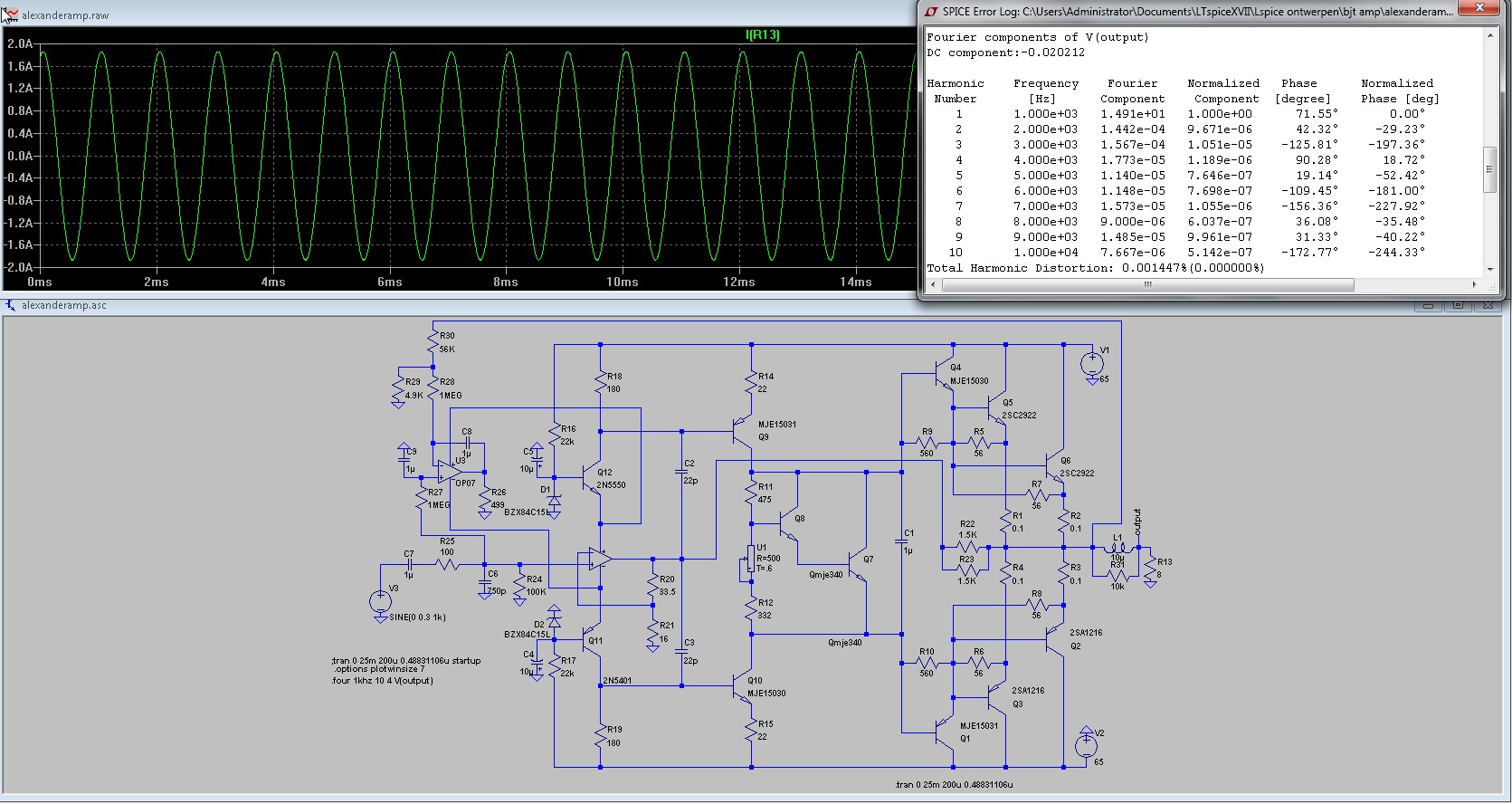

I did use these in the alexander like amp I did make some years ago, the sound was as the seller of the high end store states, 3D like.
Yes I had also that idea, the amp with super emittor follower driver and a opa627 opamp did very wel with the sanken transitors, I still have a pair, the amp is current feedbacked, I do like that most, lowest IM.
It has incredible speed and control because if the super emittor follower, puch bass, was punching.

I did use it that time, I think 9 years ago, and did sound almost 3D stage sound, and very pleasant, and this for a bjt amp, I did not expect, but use a very good opamp, opa627 is expensive but very good sounding, there are more but need to be unity stable.
