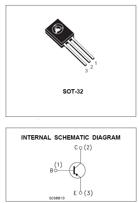

Why don't you listen to it first and then make the change so to compare subjectively too? Just use 1 LED instead of three and a sinked BD140, emitter towards R1. Only make R1 3R3 or lower to maintain over 150mA in the CCS. Measure the drop across it to determine its value for the current you like. Keep it at double your audio circuit steady state need.
