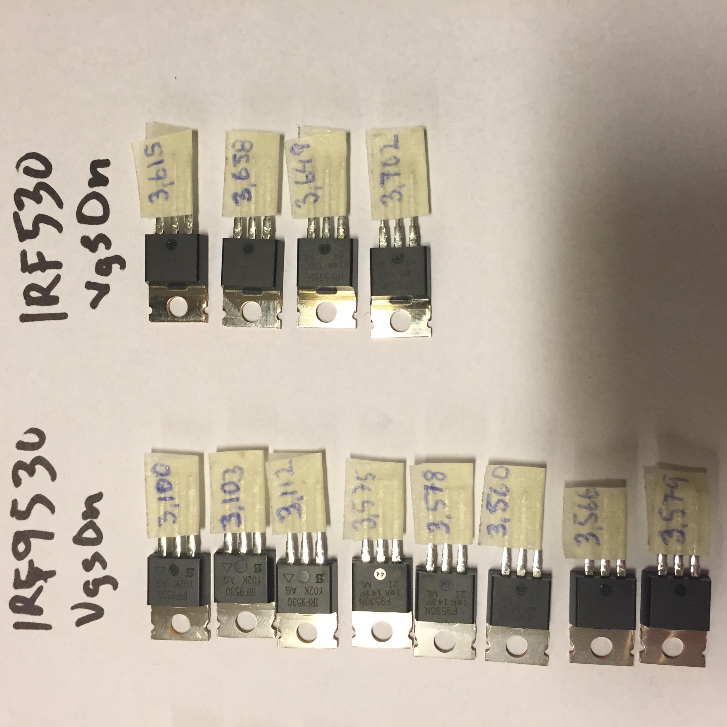

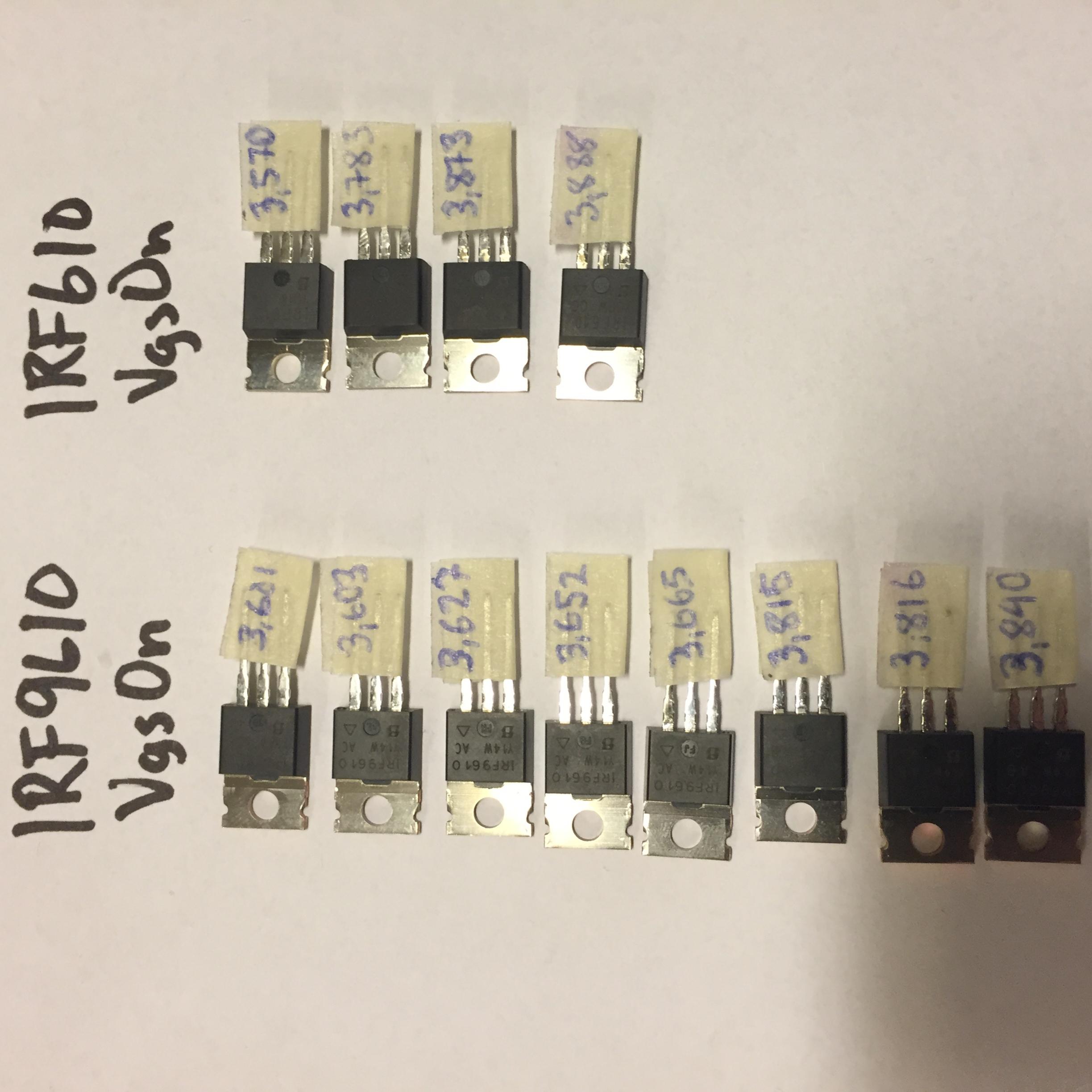

You can't say from Vgs(ON) what will be the Vgs at working drain current in your configuration, but you can use close Vgs(ON) samples that will tend to show close Vgs at other higher Id too. The exact LEDS VF is a matter of predicting the Rset value exactly which is of little practical use. Just have same VF total with ~same Vgs(ON) semis so to have same CCS current.

Must have an old print in my hand. Mine says Dont obsess over matching and selecting LEDS and JFETS.
There is a Rev2 uploaded for looong time now. About the don't obsess advice, well I should have put an asterisk *skip that line if you can't help it
