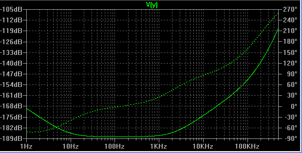

Hi Ikoflexer,
Indeed this is an impressive PSSR you achieve.
How much of this 190dB is due to the input current source and how much is due to the sub 0.1mOhm shunt impedance?
If you stick a 1 Ohm resistor between the drain of M2 (the input series PMOS) and the shunt, what is the PSRR at the drain of M2? The intention would be to limit the shunt impedance to 1 Ohm, to test a more 'real life' situation with cables and all.
In practice it would probably be easier to achieve a high current source output impedance then a super low shunt impedance...

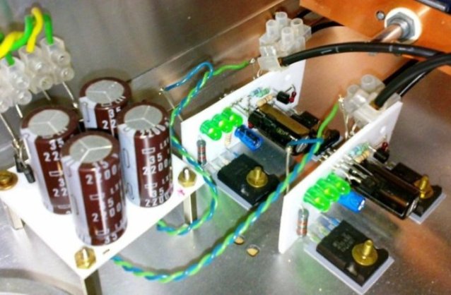

This photo is a long due promise to salas. ;)
It's a +-16V Salas shunt powering an OPA627 line stage. It replaced a battery supply with glory. It is powered continuously for one and a half month now without any problem. It keeps astounding me with it's sound that's why I don't bother to rework the wiring and close the box..As salas mentioned at the beginning of this thread I have used 2Ns and still haven't find the time to replace them with 2Sks. Who knows perhaps it will get better sonically...

I'm not saying it's not possible, but the things I tried didn't work. You can easily play with the circuit using the free ltspice simulator. I can provide you with all the models and whatever needed. Very easy to use. The offer is valid for anyone who would like to do it.
Anyway with these super numbers you achieve we're deep in the 'learning for fun'/academic debate realm. It's great that you also build these circuits and try them out!
We are, I agree. I don't think it's wrong, as long as we try to also make it real.

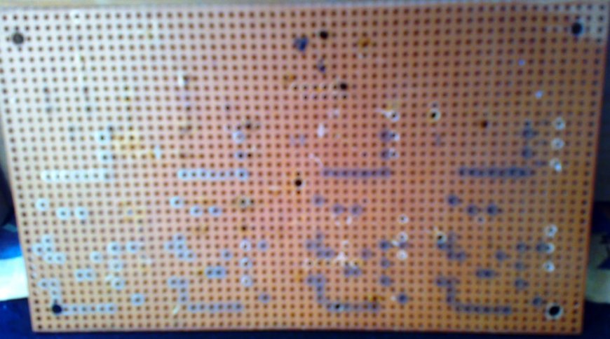

I use teflon for years now. Very easy to work with. I use those standard brown predrilled boards that you use to make the layout. I mark the holes with a pencil, attach the teflon sheet underneath and drill. The photo shows a guide for 4 shunts board ;)
