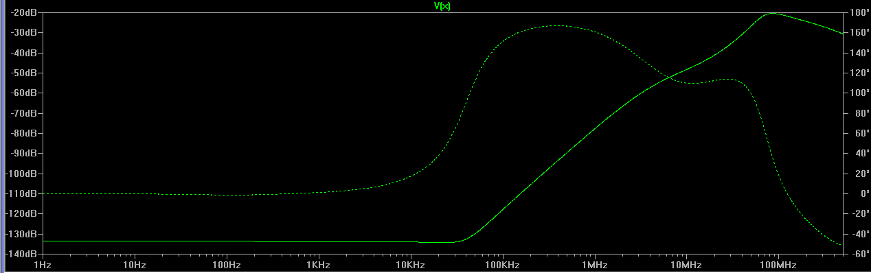

I would like to try your shunt regs with some digital ICs requiring very low voltages, such as 3.3V and 1.8V. I can rely on Vin 12V. Current will be set at 200mA, roughly twice the load.
My idea is to use an IRF9610 for the CCS and a BD140 (with 10 Ohm base stopper) for the shunt device. You recently addressed other members asking for a 5V version to the latest V1.2R (post #3200), but unfortunately I don’t have space enough for a couple of huge 4.7uF PP, thus I was thinking to implement the V1.0 schematic with remote sensing, eventually using the latest cascoded jfet CCS rather than the old one with leds.
For Vref I’m planning to use a 2SK170 instead of 2N5457 as, if I recall correctly, you stated it performs better with digital.
Any suggestion?
diyAudio Chief Moderator
Joined 2002
The K170 instead of the 5457 is suitable active load for under 5Vout because it has lower pinch off and works better under those low margins between Vo-Vbe. 2N5457 has better bandwidth where the voltage margin suffices but this is not in question here since the BJT output necessary for under 5Vout is lower open loop gain and bandwidth by much VS the Mosfet. See also for MJE15031 if for TO-220 in output. Although the BD140 will hold fine for dissipation, circa 100mA region is going to be curvier for hfe. Better if you got a grey plastic original Philips. Much more fT than from other manufacture but more rugged ones. Lastly as you don't have to battle high voltages so for the cascode to double as a higher Vmax and dissipation element, I would recommend you keep it simple with Leds and 2N5457 at their tale (25VmaxDS) or BF245A which are both high frequency. See the simulated PSRR curve.

Thank you Salas.
BD140: I've got some NOS grey plastic TFK... not Philips, but similar
So you recommend the simple CCS with 9610, grid stopper 220 ohms, 3 green leds Vf 1.8, 2N5457 (got some old Motorola's) with GS tied togheter and 100 ohms to gnd, right? No "zobel" RC across the leds.
Value for Vref cap: 100-200uF? Vout cap: 47-100uF (I have some OsCon 100uF)? Possibly bypassed with 0.01-0.1 uF MKP the first, no bypass on the second one, correct?
I forgot to mention that the digital board has some LC filter close to each IC: smd inductor + bypass cap 0.1uF (now ceramic, but I can replace them with very tiny MKS 2.5 mm pitch). Do they hurt?
I can eventually remove the inductor as the new supply should be clean enough and "dedicated" (one PS for each IC), but probably is safer to keep the cap very close the VDD pin as suggested in every datasheets.
Or I can even remove this cap and place Vout cap on the digital board. At that point the cap will be 5 cm, maybe less from the shunt device. Too far from it?
Yes, that graph was from that scenario. No 100R.
Correct.
Output cap should be very near to reg's output BD140 across the force lines. Inductance, what value that SMD coil can be? We can simulate its impact.
Joined 2002
See if it oscillates with or without it in the power path on the oscilloscope by checking the power line when you will apply the reg. Jumper it or not. If its stable always, then listen if it makes any preference to you with or without. Normally the shunts don't like inductance. But there is a chance those chips like it.
