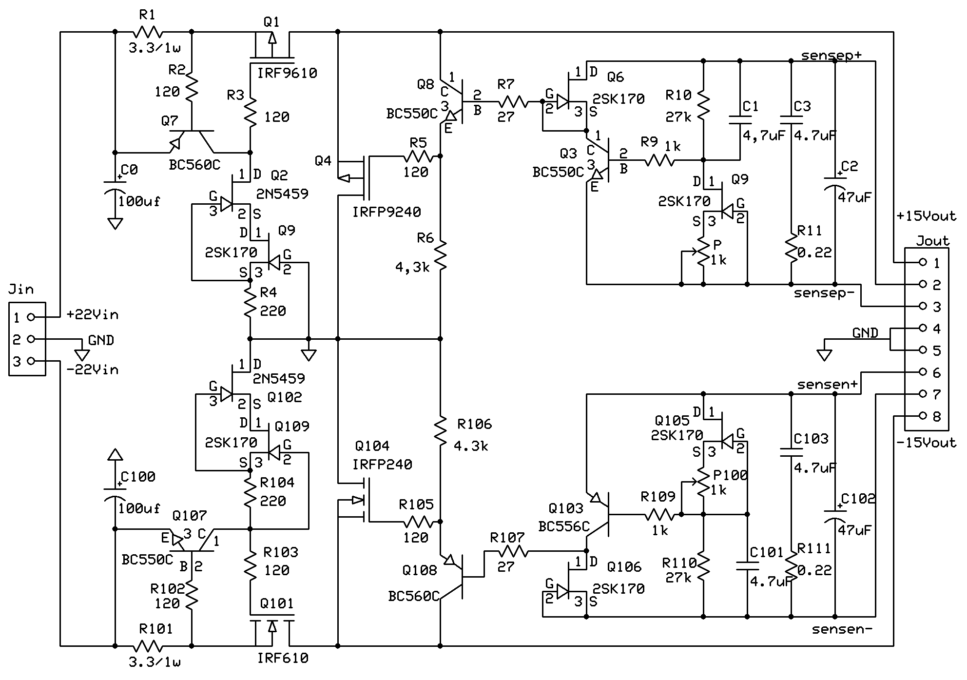

V1.2R minus for -45Vout
If I understood well can I use this schematic for -45Vout only changing Vin for -52V & R12 1k Trimmer for 500R trimmer, right?

Thanks Nick, I suspect that the sound of the V1.2R will be perfect to reg the Owen I/V DAC (A New Take for the Classic Pass Labs D1 with an ESS Dac) that's the reason I asked the minus schematic because that IV needs +- reg, BTW V1.2R sounds fantastic with my balanced Simplistic NJFET Phono RIAA but do not sounds so good in my unbalanced Simplistic NJFET Phono RIAA....

I find both 1.2 and 1.2R giving more resolution in my non balanced Riaa than 1.0 RS you use. 1.2 I find open and detailed, and 1.2R even better fleshed out. Different systems. But all 3 types are very useful and synergise better in different ways as it proves. I suspect most of all has to do with loudspeakers and rooms and the balance that suites them best.

Having such a dramatic feel of HF loss like there is a filter as you say, it will be more worrying there is a problem than it is a passive part's characeristic. Bypass with a small teflon or use another type like Rifa or Vishay box cap in any case, so to address that scenario too.
