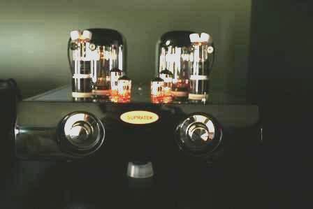

The ultimate 6SN7 for me wasn't a 6SN7 at all. I replaced the 6SN7s in my Supratek Chenin preamp with CCS loaded 2C22 single triodes, biased to 3.4V using (4) Cree SiC Schottky Diodes on the cathode. To say they were MUCH MUCH better is an understatement. The 2C22 is roughly equivalent to 1/2 of a 6SN7, but the anode and grid are taken out via top caps.
Bass is clearer and more defined, mids are to die for, treble is sparkling without being grating. Using the CCS I am able to replace both sections of the 6SN7 with a single 2C22 and still have plenty of gain.
Picture #1 is of the cascoded IXYS 10M45S CCS, #2 is of the (4) SiC diodes for bias, #3 is of the Preamp with the 2C22 tubes installed. I used a socket adapter initially due to the different tube pinouts, but I have since made the install permanent by punching holes in the top plate for the wires to pass through, so the adapters shown in photo #3 are no longer there.
