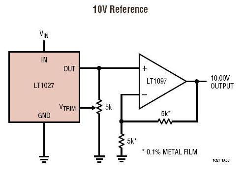

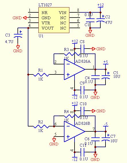

I guess the schematic like this
But without R1.

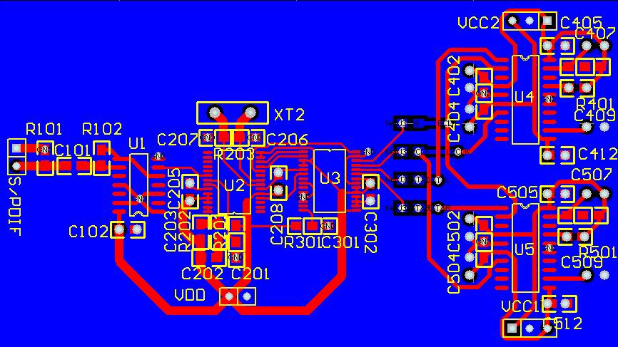

The PCM1704 PCB has complete
DIR1703+DF1706+PCM1704.
Power supply and bjt I/V are on another board. May be next week i can complete all of the work and give you evaluation.
To Peter, the resistors are 2k or 10k? I can't distinguish them.
