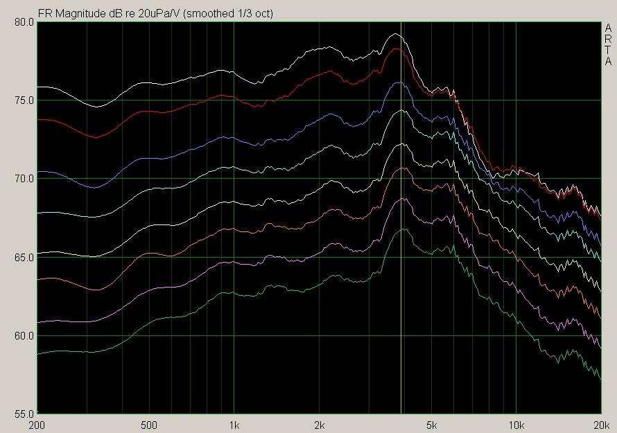

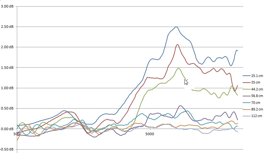

OK, so I decided to do a very rough experiment. I measured a loudspeaker in an enclosure at varying distances and calculated the anticipated drop from each distance to the next if we were to be in the farfield (20*LOG(Distance a/Distance b)). I compared this to the actual drop measured. This was done with a calibrated mic and data below about 350 hz is windowed out but there are some visible patterns. In addition, the measurement distance has an innate error as it is measured to the baffle and not to the acoustic center (wherever that truly is). Additional information includes: The diameter of the woofer including the surround: 15.1 cm; without the surround; 12 cm; The enclosure is 20.7 cm by 34 cm; The tweeter is 2.3 cm in diameter to the outside of the surround and 1.9 cm on the inside of the surround though it is behind a waveguide. Both drivers are centered on the baffle with the top of the tweeter 6 cm and the top of the woofer 12.7 cm from the top of the baffle.
Admittedly, this is a crude experiment and I did not measure beyond 112 cm. In addition, this is a two driver system with a crossover in place so it will also impact things (I did not take the time this morning to disconnect one driver, that will be my next experiment)...but this does show some interesting information, regardless. Certainly, the degree of error is minimal by the time one gets to a meter away.
Attached are the actual measurement curves and then a graph of the error at each measurement distance.
For some reason, I can only upload one file at a time. I will upload the measurement error in the next reply.

Your curve progression looks exactly as we would expect. The LF varies because the farther curves include the 4pi to 2pi transition, the nearer curves simply show the 2pi response (see Keele) Plus the nearest curves start to show the high ka effects at high frequencies.
Science works!
Where is the acoustic center? As a circular arguement you could define it as the depth location that makes the nearfield draw away curve follow the ideal. (As you get closer, every 6.02dB rise must be cutting the distance to somewhere in half.

The original curves were done when I started thinking this through. I have been building and measuring speakers for about a decade now and had just blindly followed the 1 meter rule but never really understood it. As I began to look into it, I found that there were many definitions of farfield and that there seem to be many approximations (that are often promoted as definitions). As an ex-Medical researcher and now clinician, I am generally hesitent to accept research that I do not or cannot understand how they got from point A to point B. I am hoping that others who might see this thread will also ask questions and learn as I have along the way. It is evident that there is more to understanding farfield than meets the eye; Earl's take on it suggests that there are inaccuracies in our estimations and perhaps his method is more exacting (only time and scrutiny will tell) but for now, I think that some guidance can be found in this thread.
Hello JMB,
Thanks for posting your measurements. What type of woofer was used?
You might also consider trying a metal cone unit where the cone motion remains pistonic to a higher frequency.
It would probably require a more distant measuring position to minimize measurement errors.
Can you clarify how you calculated the data shown in your error plot?
Were the 7 curves in the error plot calculated from the 8 curves in the measurement plot?
Any chance you can repost the error plot with LOG frequency scale.

I am attaching the log scale of the errors. The 7 error curves are based upon the 8 measurement plots. This was made by graphing relative frd measurements and then subtracting each progressively further measurement. This dB difference was then compared to 20*LOG(one distance/the 2nd distance). The woofer is Polypropylene.

As I re-read some of the posts, it became apparent to me that the AES requirement #2 (see my first post) did not take into account beaming. In addition, as I looked at my tests, it seemed as though they underestimated the error in mid frequencies. I used a Bessel function to calculate off axis energy and found that a decreasing portion of the energy would actually be reflected by the baffle as frequencies increase due to beaming. I then calculated a relative baffle contribution based upon the pct of energy going to the baffle. The equiv baffle is then calculated based upon this vs. the driver source size regarding degree of contribution.
When I compare this new spreadsheet to my findings and to those of Joe D'Appolito's example of farfield (I think page 61) in his book, it seems to be more in line. Please play with this spreadsheet, test it against real world examples, and see what you think. This is a learning endeavor and I welcome comments and guidance.
