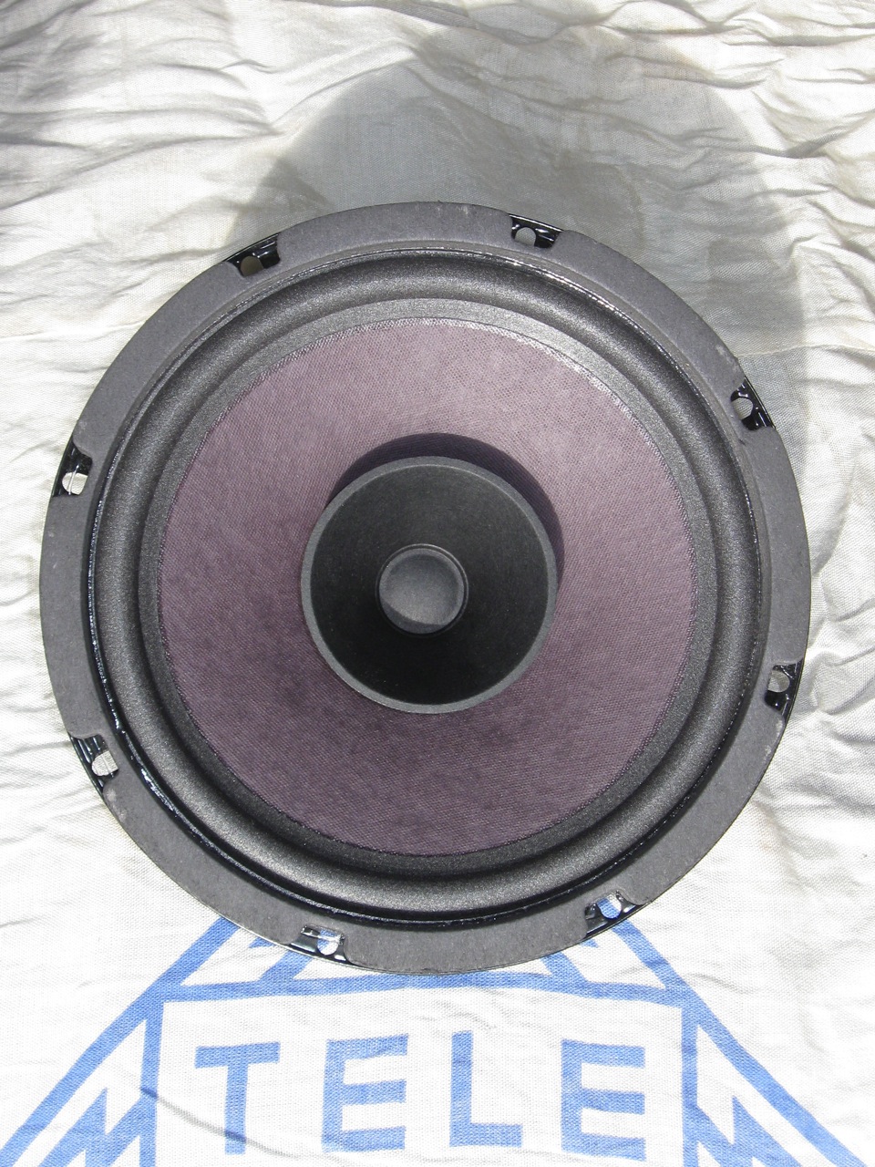

I'm excited to introduce a brand new, one time offering from Wild Burro Audio, The Purple Speaker. These are brand new speakers from my normal US factory, made to the same standards as the Betsy and BetsyK. They have a paper cone, foam surround, steel basket and a 10oz magnet. The Qts is high enough to work on an OB, but due to the different suspension, the compliance is low enough that boxes can be reasonably sized! These specs are about as close as you can get to an all-around fullranger.
In addition, I thought I'd add another interesting wrinkle. As they are, no whizzer or dustcap is installed. I have noticed that folks often like to mess with the whizzer and/or bottom of the cone, be it the 99 cent tweak or the fancy stuff that Rethm does to Lowthers. So, with each speaker you get three different whizzers! The smallest is the same one used on the Betsy. The other two might look familiar to followers of other US made fullrangers. It only takes a minute to glue them on, but having them uninstalled makes it very easy to modify them prior to installation. The large whizzer begs to be cut to a more interesting profile. Think of the possibilities for ENaBLing! Of course, you can also cut one down to make only a dustcap and have a widebander.
Of course, the best news is the price! I got 'em cheap, so you do too. The intro price is $18 each, $36 for a pair. I've already spent quite a few hours listening to them in my open baffle test mules, and I think you'll be as pleased as I am!

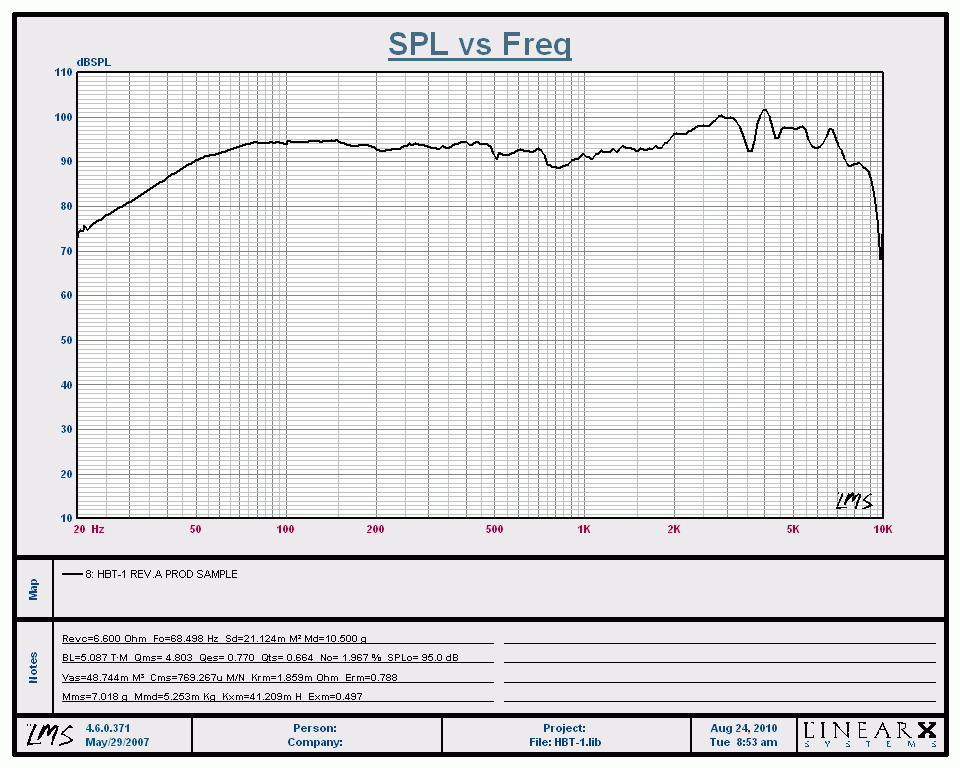

The curve shows the speaker as it comes: no whizzer installed. The other pic is the smallest whizzer, the one that is standard on the Betsy/BetsyK. Obviously, this is the one I'm listening to now!
As they are hard to read, here are the T/S specs in print:
Re 6.6 Ohm, Fs 68.5 Hz, Sd 211.2, Md 10.5g
Bl 5.08, Qms, 4.80, Qes .770, Qts .664, Spl 95db
Vas 48.744L, Mms 7.02g

I have been mulling a OB dipole experiment, I think this could possibly work wonderfully. The graph shows excellent low frequency response, but an Fs of only 68. Is the graph based on a particular baffle. How many pairs do you have?
Don't pay any attention to the low frequency performance in basic driver response graphs! (For the record, this is a standard test baffle at the factory). People email me and say, "I was thinking of getting the BetsyK, but the Betsy appears to have much better bass on the graphs". Drives me nuts! Plug the numbers into a simulation. Download a spreadsheet to simulate open baffles. It won't be perfect, but it'll give you an idea. Don't forget to think about your amplifier's output impedance. There is a reason JE could get away with some lower Qts drivers than one would assume work on an OB. . .
(On a related note, don't judge the bass of a driver meant for a box if that driver isn't in a box!)
FWIW, another pet peeve is folks focusing on the Fs. For some reason, low Fs sells speakers. I'd consider using a stiffer suspension in the Betsy/BetsyK so the boxes could be smaller, but I'm afraid nobody would buy them as the Fs would be higher. Simulate this speaker and the BetsyK in a 2 cu ft (reasonably sized) sealed box. What does that low Fs get you?
Finally, as I am also prone to repeating, single 8" fullrangers in an open baffle are no recipe for big bass. Build a large baffle and you can get into the 60's. Listen near field, and don't pump a bunch of watts through them unless you are running some sort of high pass. I think single driver OB's are wonderful, and what they do well is hard to duplicate any other way. But they certainly aren't the ideal speaker for rocking out in a big room.

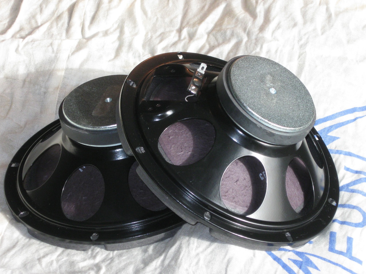

Interested in knowing what the X max. and power handling of the driver is, if it is close to the Betsy I might be interested. Not so thrilled with the steel basket not having enough opening for the back wave to pass through there might be to much bounce back thru the cone under high power application. Certainly like the idea of not having the whizzer and dustcap installed, at one point I was going to inquire whether it was possible to get the Betsyk without the wizzer and dustcap.
The Purple Speaker is not a Betsy at a lower price. The Betsy and BetsyK are flat-out better. Granted, I haven't spent tons of time with the Purple, and there are probably ways one can minimize the differences. But Betsy is darn cheap in her own right, so those looking for the highest performance best go with her!
Power handling should be very similar. But, the Purple Speaker does have a lower Xmax at around 1.5mm. Notice that this is still more than some others give you! In addition, it has plenty of Xmech, and with the stiffer suspension, should be plenty physically tough.
As far as the basket goes, if you want to trade any of the speakers in the pic for the Purple and its considerably more open basket, let me know. I'll even pay shipping!

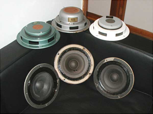

Seriously, I understand that more open baskets are ideal. But I also suspect it is something that will net you that last few percent of performance, often at a high price. But look at the Fostex 206. Or some of the smaller diameter Lowthers. Or especially the Altec! I don't think the basket will make or break you. The idea with Wild Burro Audio in general is to exploit the law of diminishing returns. For those that want the ultimate, they best be prepared to go elsewhere and pay a much higher price!
