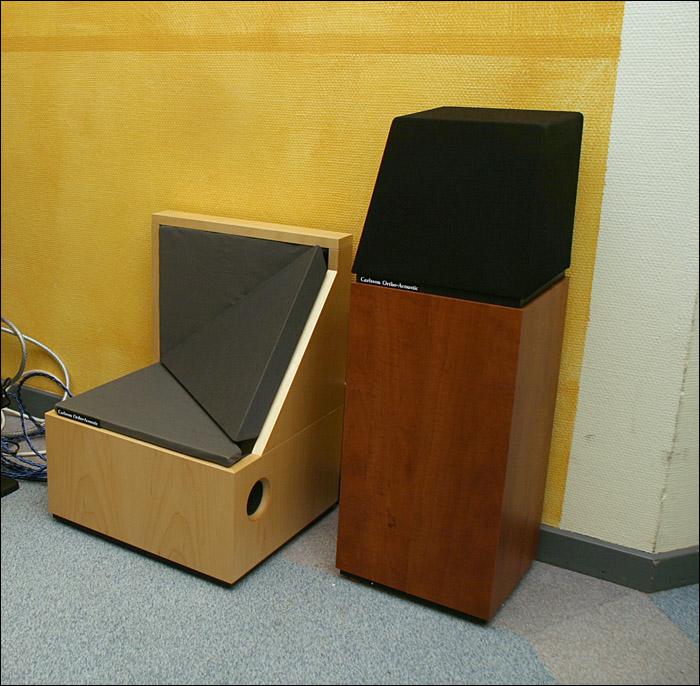

My loudspeakers are somewhat similar to Stig Carlsson designs such as OA-52 (image attached, the shorter one). These are also very short (midbass driver is about 25 cm above the floor level) and designed to be positioned against the wall.
And all this "to reduce harmful early room reflections" (sic!)
Nevertheless the Carlssons use some acoustic absorbers to reduce the amount of VER coming from the wall. We can imply from that that their designer was aware of the problem. But He considered that it is sufficient to reduce the amount of VER.
In case of my loudspeakers the situation is a bit different because the wide range driver is certainly beaming which certainly affects the frequency content of VER.
Additionally, with this beaming and signifficant rounding up of all of the cabinet edges I have probably no audible problem with enclosure diffraction.
Moreover there is no crossover with its inherent group delay problems.
But how are all this factors affecting the situation with regards of audibility of VER distortions I really don’t know.
I only know that adding absorbers (going the Carlsson suggested way) doesn’t change it. With or without the absorbers I can’t really hear any kind of particular sound degrading distortion which I could attribute to VER.
Can it be that in my particular case VER are effetively masked?
Taking into account:
- unusual loudspeakers with no diffraction and crossover-related group delay problems (although the driver itself certainly has group delay problems on frequency extremes)
- verticality of the VER
- the beaming of the driver affecting spectral content of the VER (which are obviously "low passed")
- very short time of delay <1 ms

Thats too many questions to answer one by one, but the gist of them are questions regarding the thresholds and audibility of a myriad of small facets of the VER. The basic answer is that we just don't know. The experiments that have been down were very simplistic and tend to lead to areas of further research rather than complete answers.
What is know is this. The group delay effect is dominate above about 1 kHz and tails off above about 6 kHz. At low frequencies there is virtually no effect. It is very dependent on the delay time and the level of the effect as well as the level of the playback. So in all likelyhood it is dependent on all those aspects that you asked about.
So what I must conclude from this is that above 1 kHz it would be wise to minimize these VER as much as possible - simply because I don't have enough information to determine tradeoffs. As they are minimized it appears that sound quality just gets better - but this is subjective without strong objective support except for the simple experiments that have been done.
What is pretty conclusive, after a multitude of experiments by myself and other, is that THD and IMD have absolutely nothing to do with sound quality and it is probably best just to ignore these numbers even if we don't necesarily ignore nonlinearity altogether. For example, I use bandpass subs because they acoustically low pass the output. This reduces the higher harmonic content. Whether this lowers the THD or IMD I have no idea - I've never measured it - there would be no point. So while I don't ignore nonlinearity altogether, I do not waste my time measuring or talking about THD.
As to your specific example, there is no way that I can comment on a single subjective experince, especially one that is derived from ones own designs and or setups. There is far too much potential for bad data in a case like this. From what you described there would likely be very few VERs above 1 kHz. in that setup. Thats about all I can say.
