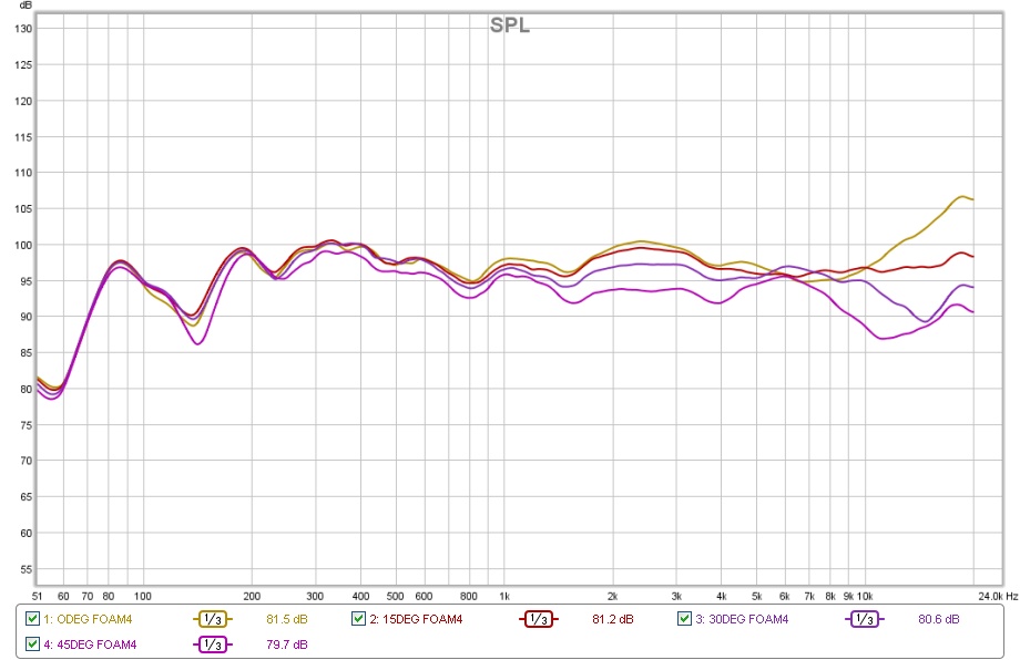

Not sure you can believe the graph.
First are you sure this freq 'accidents' are possible to correct using eq? What i mean is that there will be diffraction effects caused by the transition from horn to membrane and then by suspension and frame/ gasket.
Not sure if an eq can solve that and not even if it really matters ( for the transition horn/membrane sure it does matter!)?
This is one of the compromise to be made with a coax but from my experience this isn't as awfull to hear that than it looks on a graph ( with Tannoy's and some Beyma drivers i've heard at least).

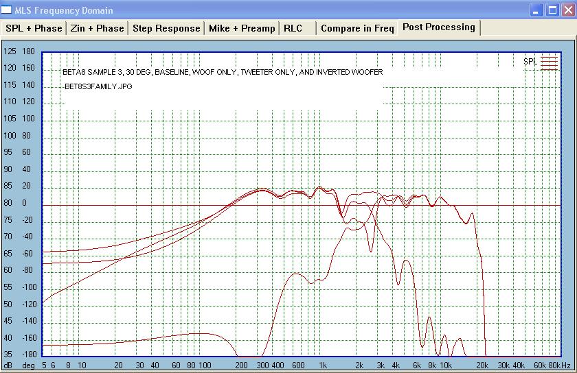

FWIW, when comparing different scale charts I just look at F6, F10 and both are ~4.5 kHz/9 kHz respectively, so seems like ~ 'six of one, half a dozen of the other' to me. The rest is just minor damping/tweaking to 'taste', so between me being a 'cheapskate' combined with 'poor' in the thread title, the choice seems self evident.

1 - Are these the frequency responses for that combination of drivers?
2 - How was this measured (in a cabinet, crossover, etc?) If you will...

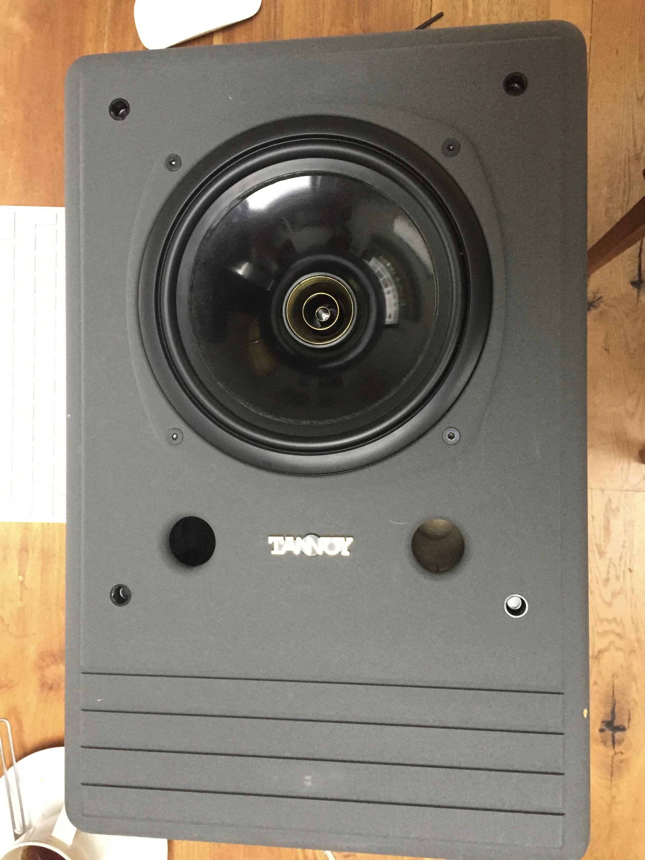

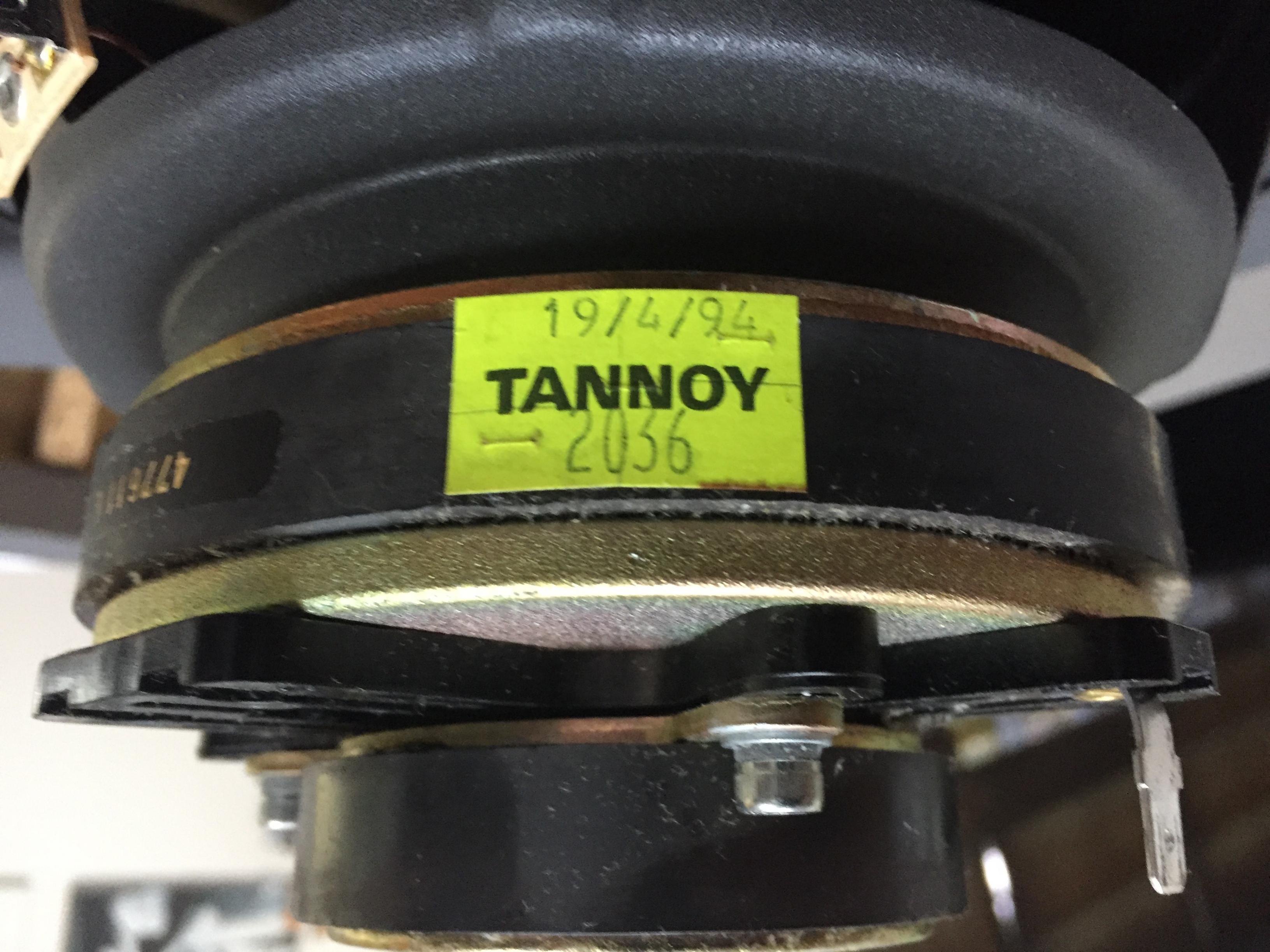

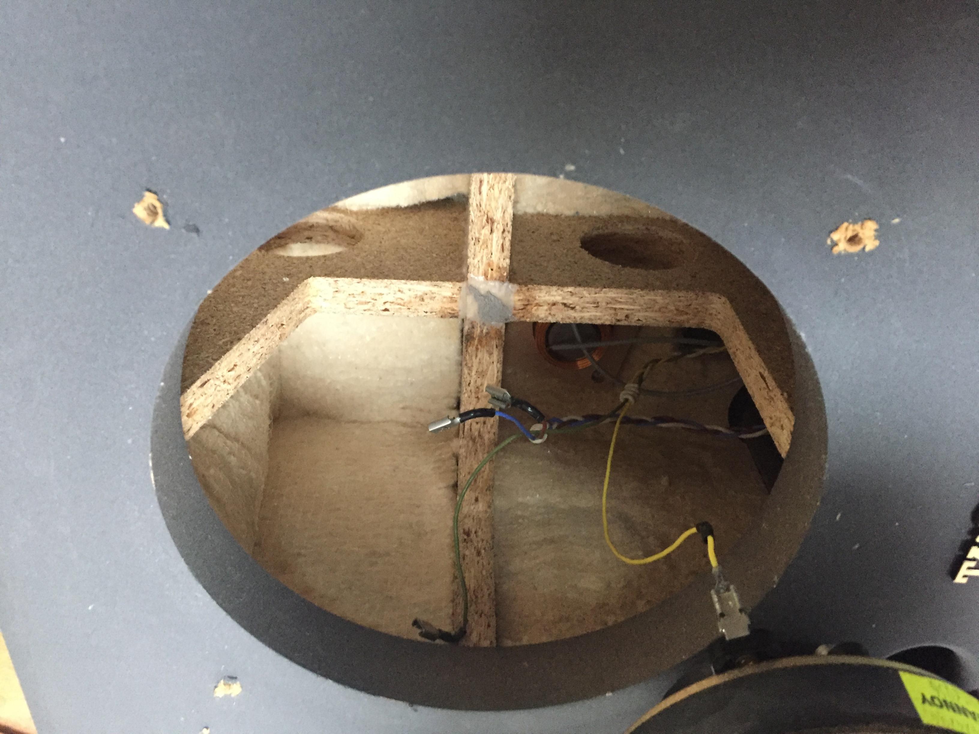

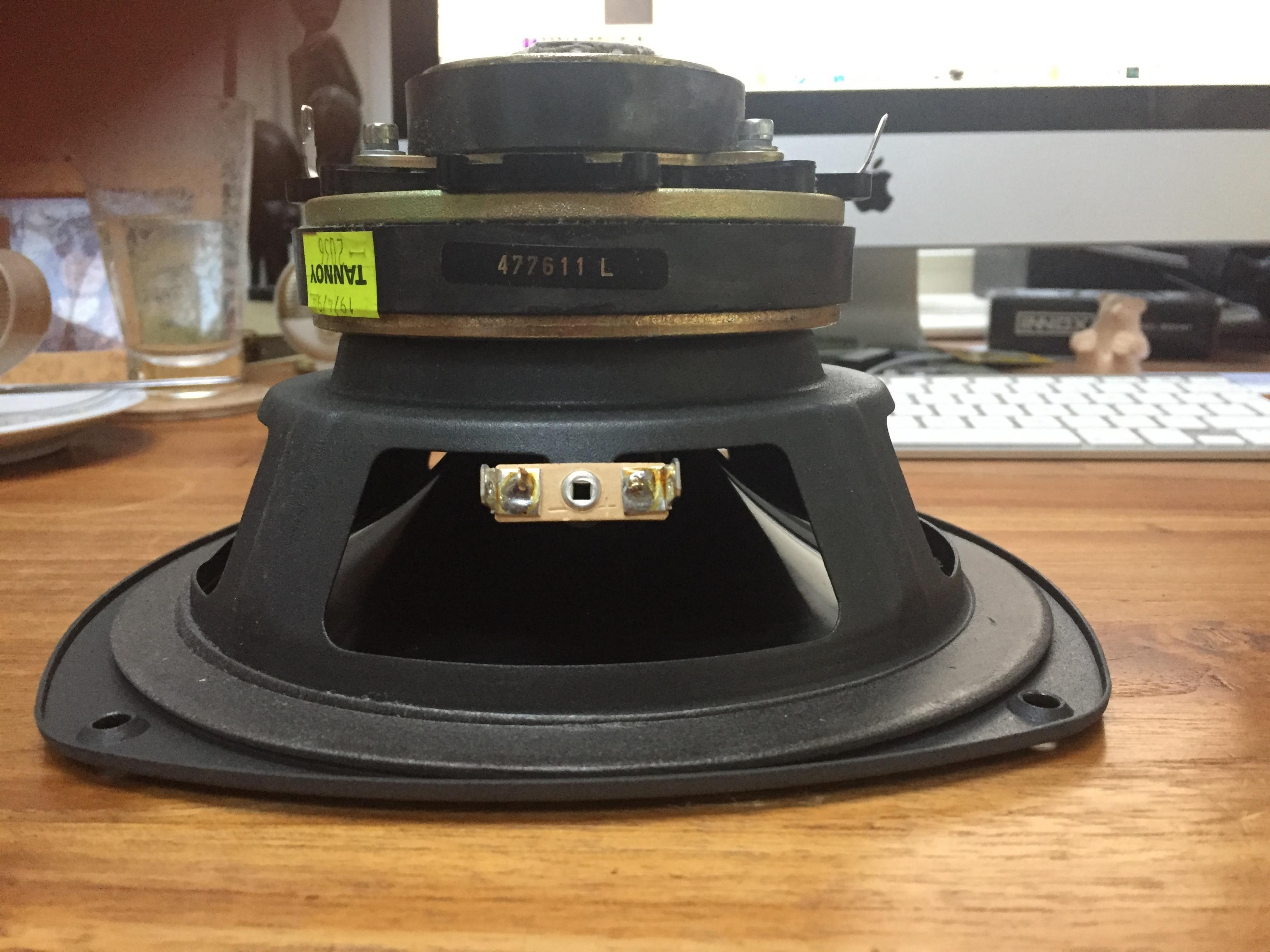

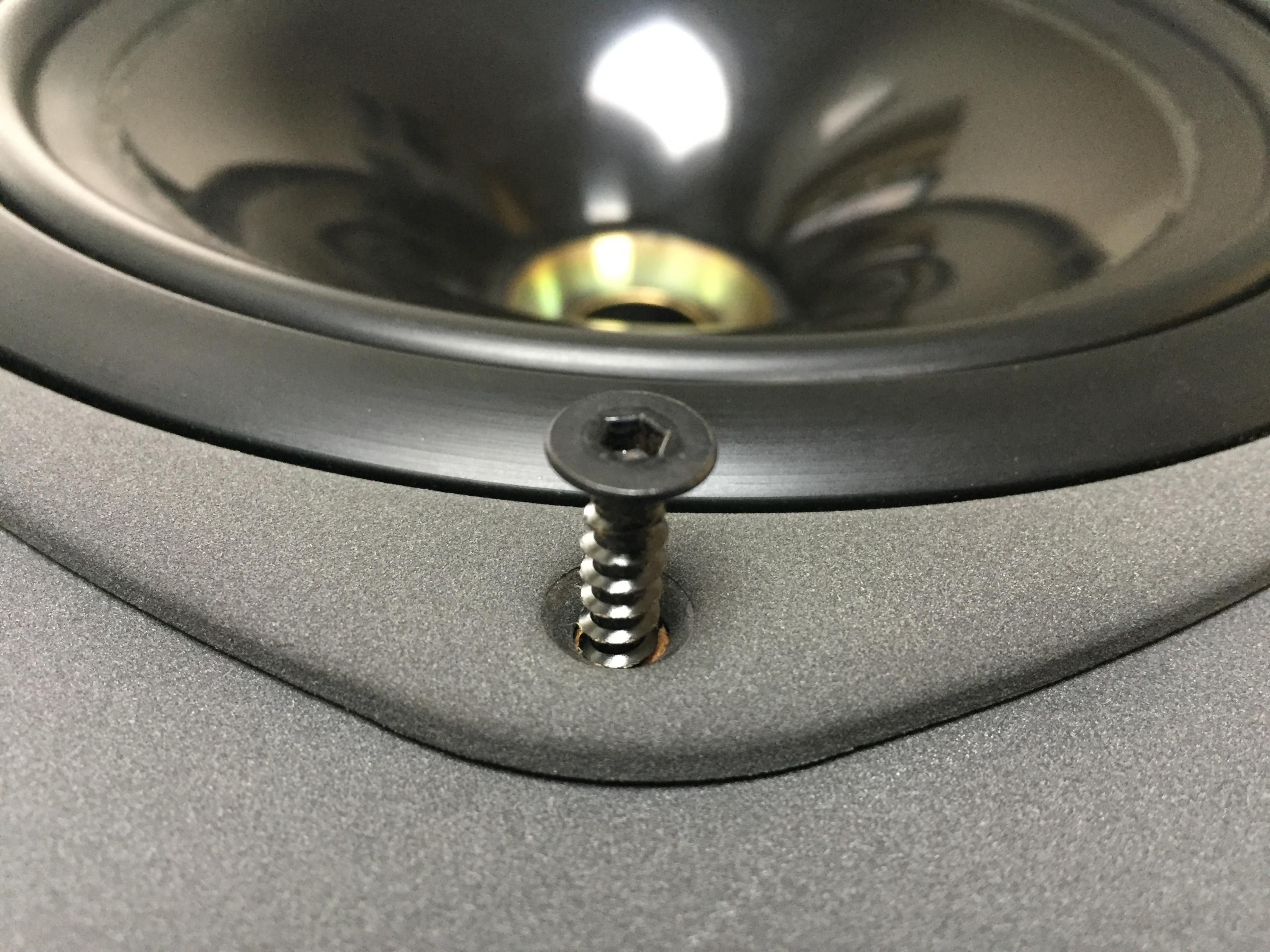

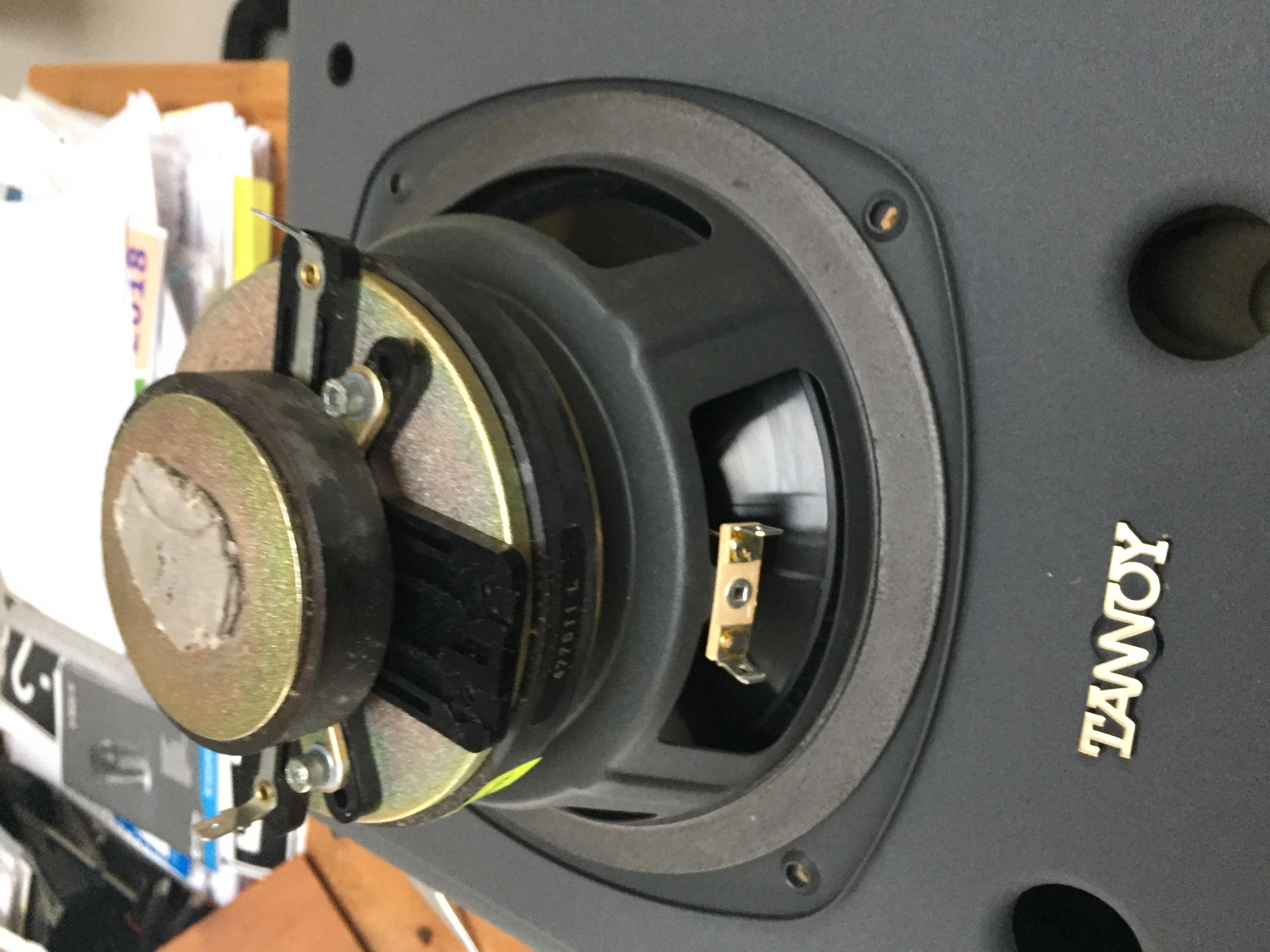

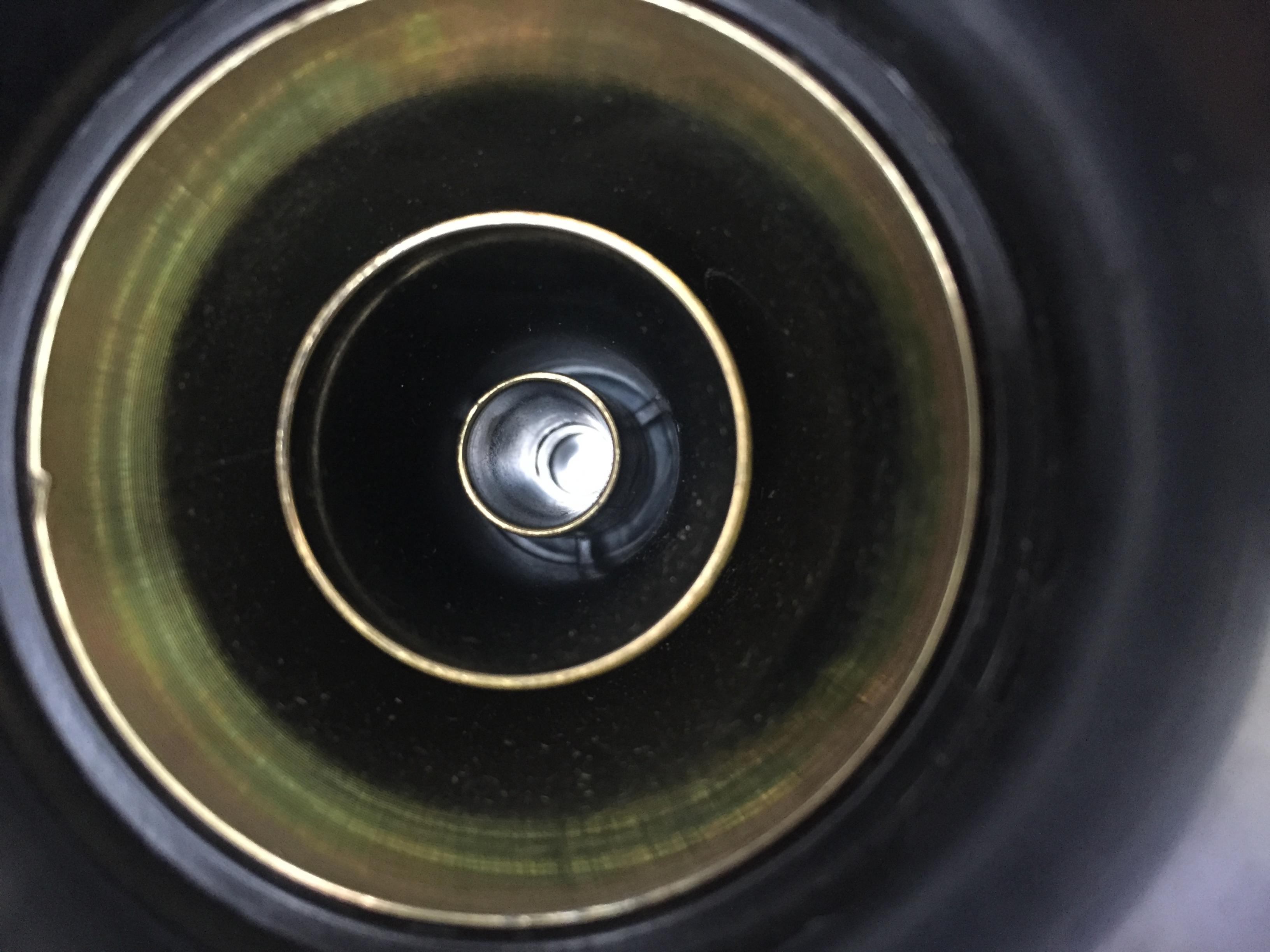

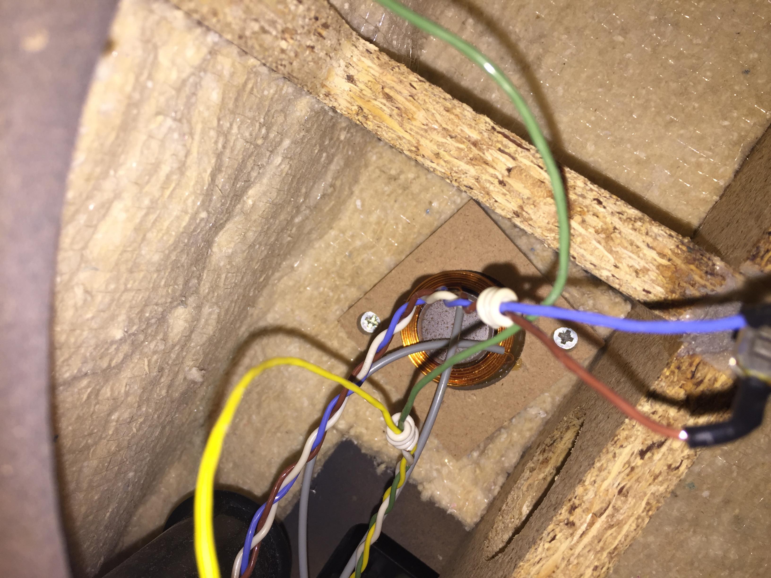

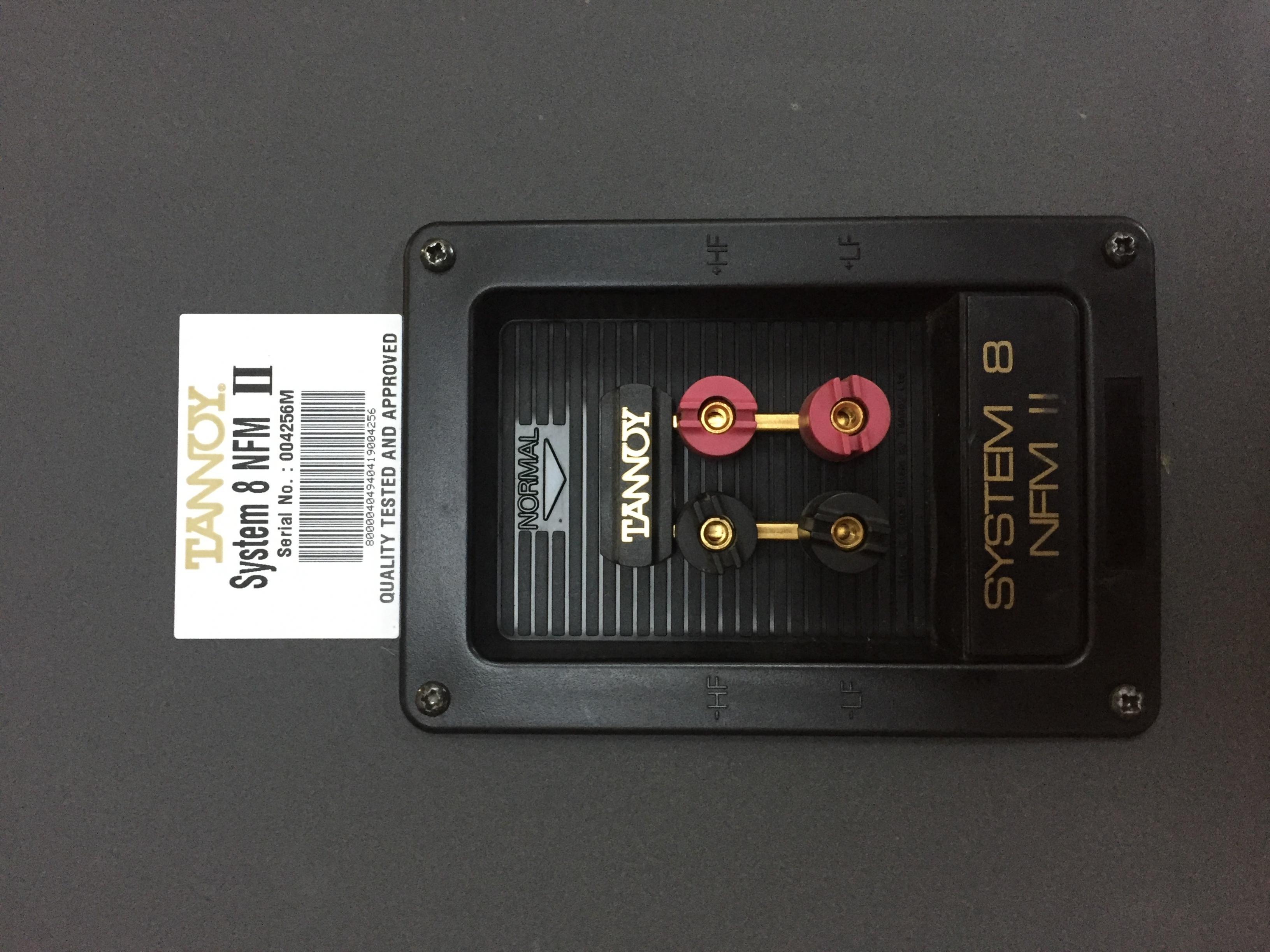

Tannoy System 8 NFM II
Taking it apart, so I can do the sizing measurement for the Tannoy 2036 driver.
Also made some pictures.
- 25mm front and back panel
- typical Tannoy bracing, but look at the type of wood used, the bracing is done with old school partical board (if that's the correct word). Did they have a warehouse full left from "the early days" or what.
- Wood screws to fix the driver
- The driver is from 19 april 1994, so the cabinet most likely is around that period as well.
There is a coil, separately mounted from the cross-over. It is as far as I have read in various articles on cross-over improvement to reduce coil vibration, which would have a negative impact on the functioning of the filter. A bit far fetched or what?
Also found that the bass-reflex ports in the cabinet are not centered, they don't match the size of the hole in the front panel (by 2 mm on one side).
See pictures for the whole story.

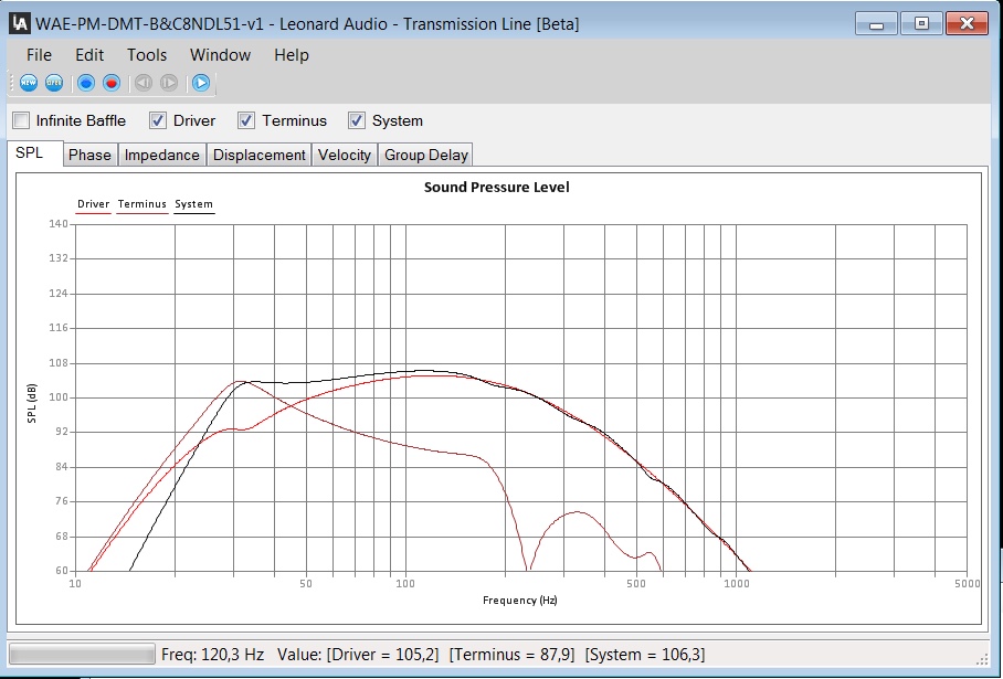

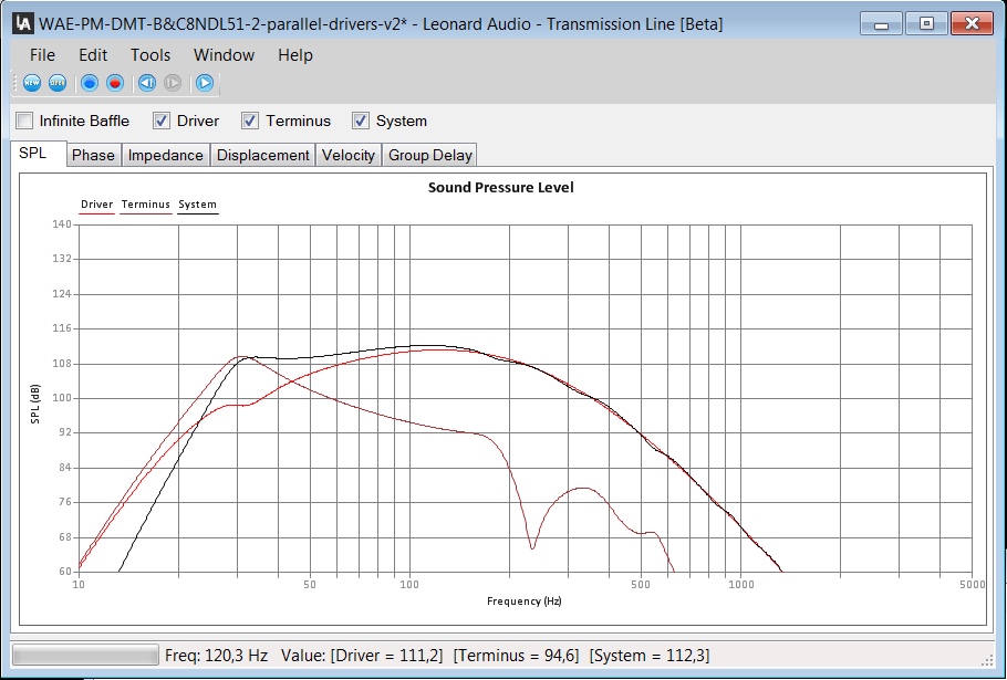

2 Driver TL design rules
Following on the previous post, as suggested by Charles, I used the driver T&S parameter rules for 2 parallel drivers in one TL.
As hoped / expected it came out very nice, just 2x the width of the TL when applying T&S parameter changes based on 2 parallel drivers.
First graph is 1 driver, second graph is 2 parallel drivers. 6dB more, TL, offset and the likes the same.
