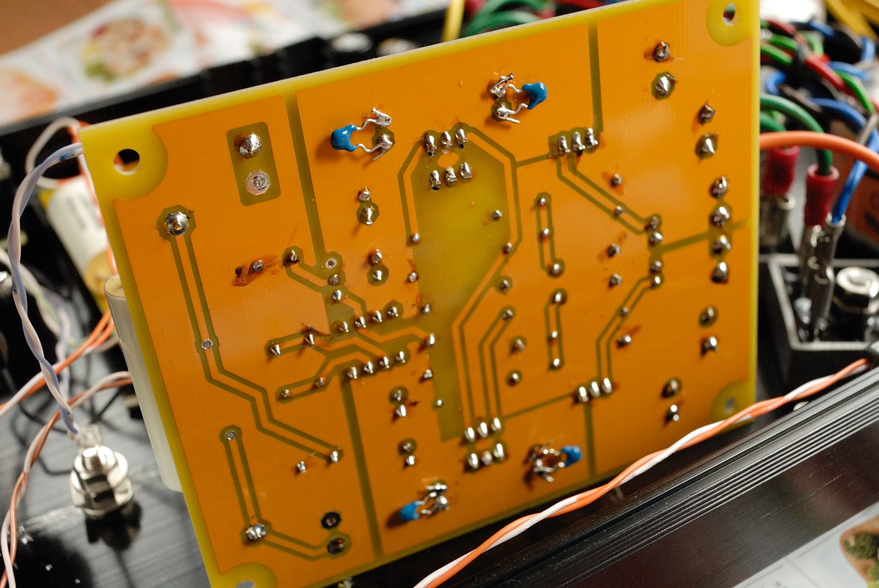

Important update to the B-board saga.
However, I could make out a difference. No B-board, the sound was slightly weaker and more distant, but at the same time more accurate in the delineation of the stereo image.
Round 2: I switched out the B-Board for a second set I made with some changes to the BOM. I also modded my Sapphire headphone amp with ceramic bypass caps. Short story: they both sound much better now, less brittle, more relaxed and musical.
Test A: as before, headphones, straight from phonoclone3 or routed through B-board based preamp. Tried both setting the B-board attenuator at 100% and using the Sapphire volume control, and setting the Sapphire at 100% and using the B-board attenuator.
Result: Must less difference than before. Through B-board, sound is richer, fuller, with more weight and width. Straight through, it's nice, but just a little less full, with more accent on the treble. Finally, I preferred the sound with the B-board, operating as a premp (i.e. using the B-board rather than the Sapphire to control the volume.) Using the Sapphire attenuator the sound was just ever so slightly more indistinct.
Test B: I modified my 47 Labs 0247 headphone amp such that the line out is taken from the output of the 50k Alps pot. It becomes a passive pre, in other words. So I could compare my 47 Labs 0347 amplifier driven by the B-board pre vs. a 50k potentiometer.
Result: B-board is just far and away better. Switching in the 0247 (passive) it's like the bottom end just deflates. Sound is weak, drained of color and vitality.
Ceramic capacitors. A small change that turns my previous judgments on their head.
Anyway I'm completely sold now both on active preamps and the B-board.

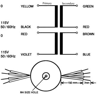

Richard, blowing fuses in my power supply. Using the suggested Amveco transformer. Saw your advice to connect connected outputs to either ~ side of the same rectifier, found green & red had continuity as did brown & blue. Data sheet instructs "for 115v operations, connect primaries in parallel by connecting yellow and red lead wires together and black and violet leads wires." so connected y/r pair to L and b/v to N. Suspect I made a mistake with primaries. Appreciate assistance.
Thanks,
Warren
