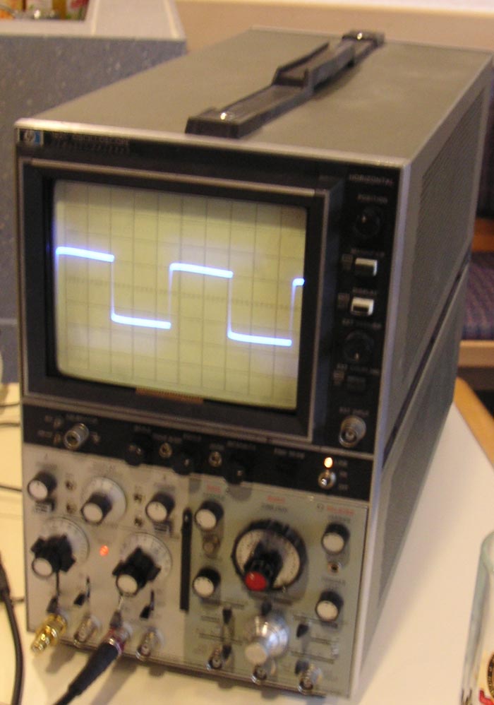

The picture is showing Allen Wright measuring my amp. He was impressed about the accuracy of the RIAA curve, not knowing the concept or beeing aware of his own "modification" inside.
You see a exactly square wave on the scope. The signal is fed through a "anti RIAA" equalizer and then through the VSPS.
