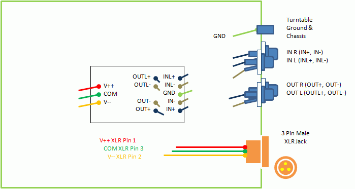

The main change in the new phonoclone boards (35b) is the addition of a dedicated GND pad, which is a special tap of "COM" that connects directly to the turntable ground and chassis. This seemed like a more sensible, foolproof way of doing it than getting people to connect COM to the chassis at the XLR jack, and makes the Phonoclone consistent with the current VSPS boards.
It's too early to tell whether the new boards have solved the RF/hum problem some of you persistently have trouble with. No such complaints so far. The changes were not intended to fix the problem however ... it was just to make things more intuitive and coherent.
The changes to the power supply are in the same vein. Using two bridge rectifiers is unlikely to reduce the hum, the main reason for making it the "official" recommendation is that this scheme is far, far harder to mess up.
What will make a phonoclone gone wrong right again? No simple answer, as far as I know.

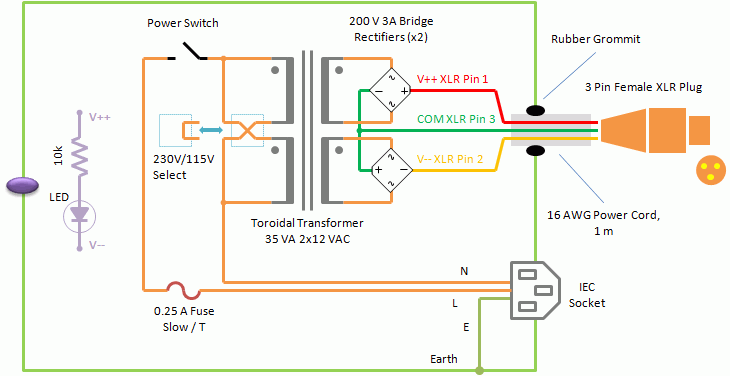

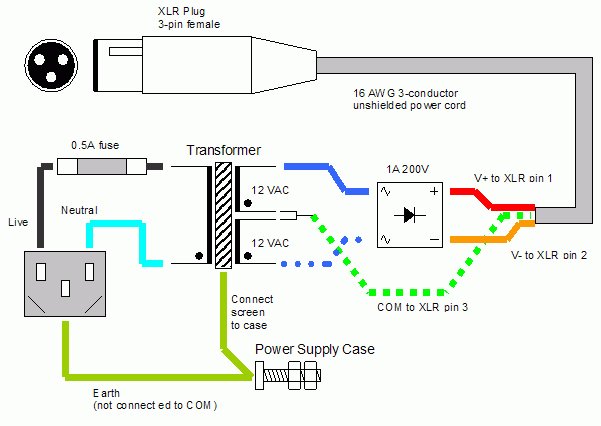

External PSU and amp case connection
Hello,
I have been working on two projects: VSPS and opamp-based headphone amplifier. For VSPS everything is clear thanks for this post and RJM website, but when I started to search the forum for more information about noise and proper grounding I have found this thread: http://www.diyaudio.com/forums/chip-amps/115698-understanding-star-grounding.html
The thread also refers to Rod Elliott website article: Earthing (Grounding) Your Hi-Fi - Tricks and Techniques.
My question is about one detail which cought my attention: the way how ground connection is made in ESP schematic and not used in RJM PSU connection (please disregard ground loop braker shown in ESP site. My question is not about it).
Let's talk about VSPS PSU: RJM Audio - Construction Guide
In the first drawing of the PSU, the earth connection from the IEC socket goes directly to the case (there is also a note to connect transformer's shield if exists). So, this is the same for both threads. Now, what is different is secondary side of the transformer. In RJM site the green common wire, COM, goes directly with V+ and V- out to the amp case. There, I guess, all signal grounds are connected together, and with added COM connection are connected to the amp's case.
The detail, which is different from VSPS PSU is connection of common wire, COM, on the secondary side of the transformer to the case in ESP PSU.
Sorry, if that question was already asked, but the thread grow up to really big one and I was not able to find an answer. Are both approaches correct in reference to different project than VSPS? As I have mentioned at the beginning I want to build headphone amplifier based on OPA134 chips with external PSU. Like VSPS, I want to put voltage regulators by each chip. Since I am a beginner I am not sure which option to use and not to have problems with hum.
My worry is also about safety. If PSU and amp's cases are not linked together, like in VSPS, will fuse be triggered if something happens in amplifier case?
Thank you for the help !!!!!

The grounding scheme of the VSPS etc. will work equally well for a headphone amplifier. Try it and see. There is no risk of electrical shock as the output voltages are isolated and low.
High voltages, the story changes. I'd use a loop breaker as described by ESP for all but the amplifier, which can be earthed directly.
