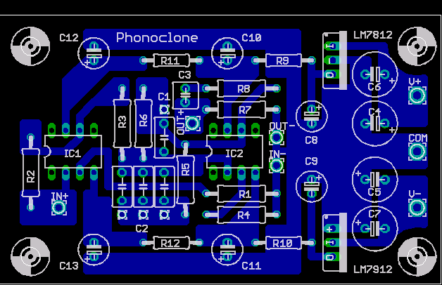

And the Eagle files, all prepped and ready for Olimex.
Single-sided boards, and small size keeps the cost down. The main reason I made this however was I wanted to see how a little bit of filtering (10 ohms / 100u perhaps) affects the sound.
Dunno when I"ll have the chance to build this though. The only reason I had the time to do up the PCBs is Im home recovering from the flu.
/R
