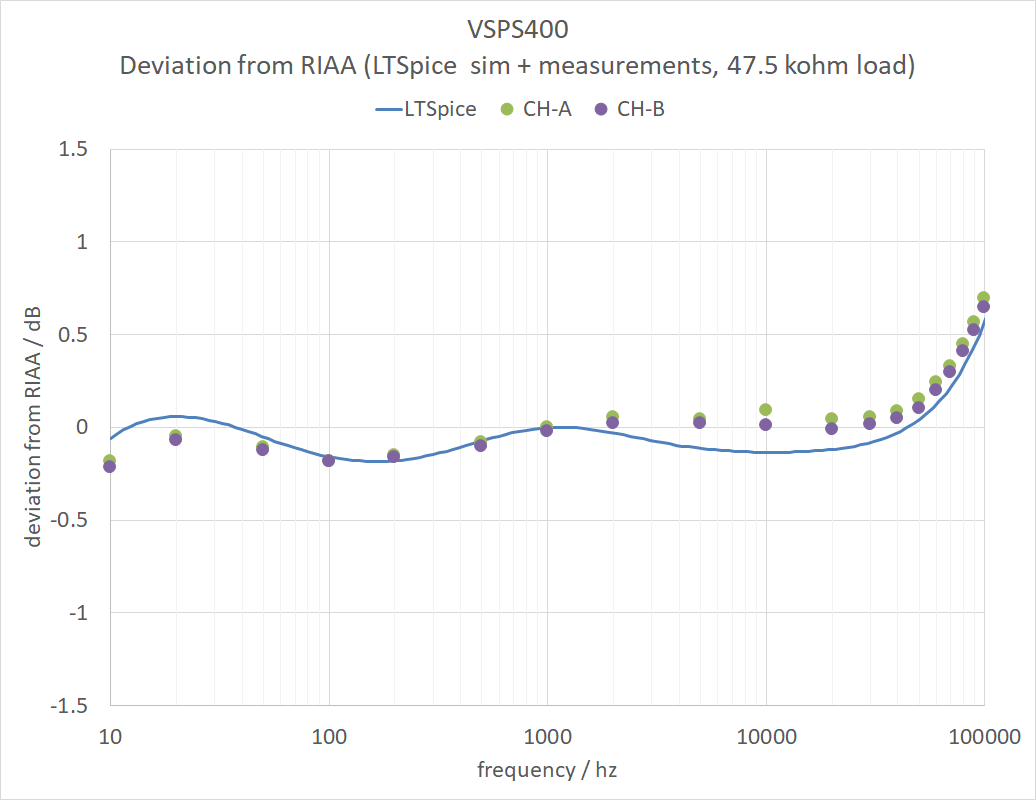

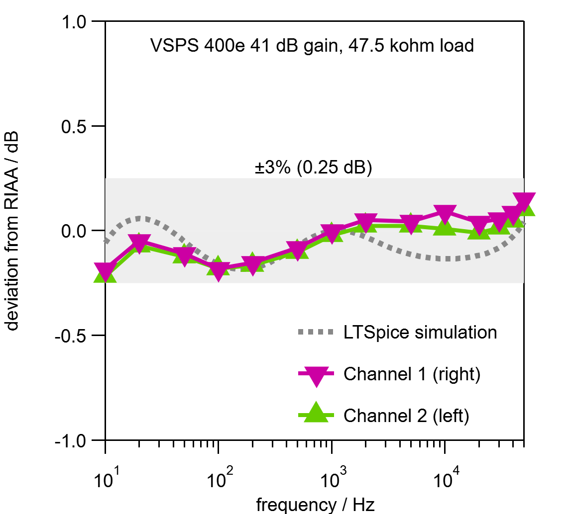

I could reduce scatter and improve accuracy by using the scope's rms voltage measurement rather than the p-p values.
Formal simulated 1 kHz gain is 40.94 dB. Measured is 41.17 / 41.15 dB.
In terms of a specification, the circuit measures within +/- 0.15 dB of RIAA 20-20 kHz. Channel imbalance is negligible.
Jose: yes, leave C1 at 1 nF. Everything was fine all along, my measurement setup was inducing strange result.

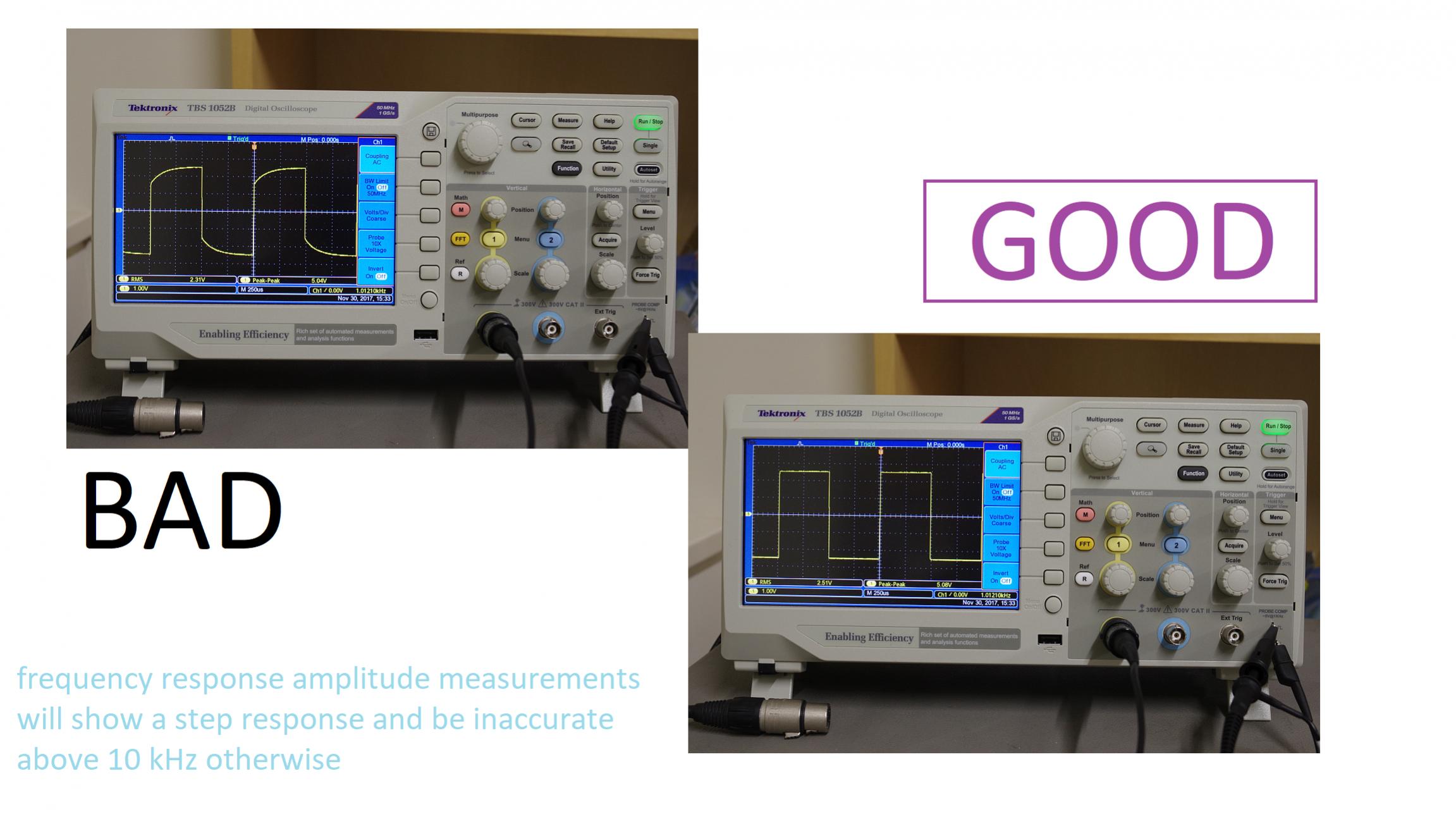

Final word on this:
PRO TIP: Calibrate your oscilloscope probes regularly.
However, for measuring signal amplitudes at audio frequency it's best to avoid 10x probes altogether. The measurement accuracy starts to depend on the compensation effectiveness at frequencies above 10 kHz, right where you most want consistent and accurate measurement. Use regular coax cable instead and you avoid the whole problem entirely.

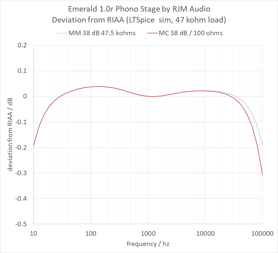

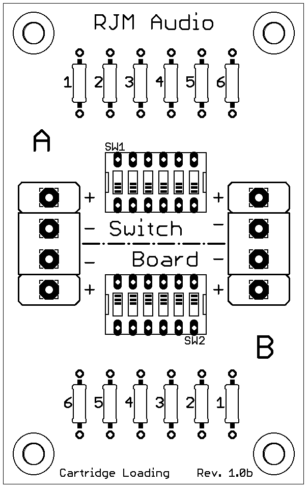

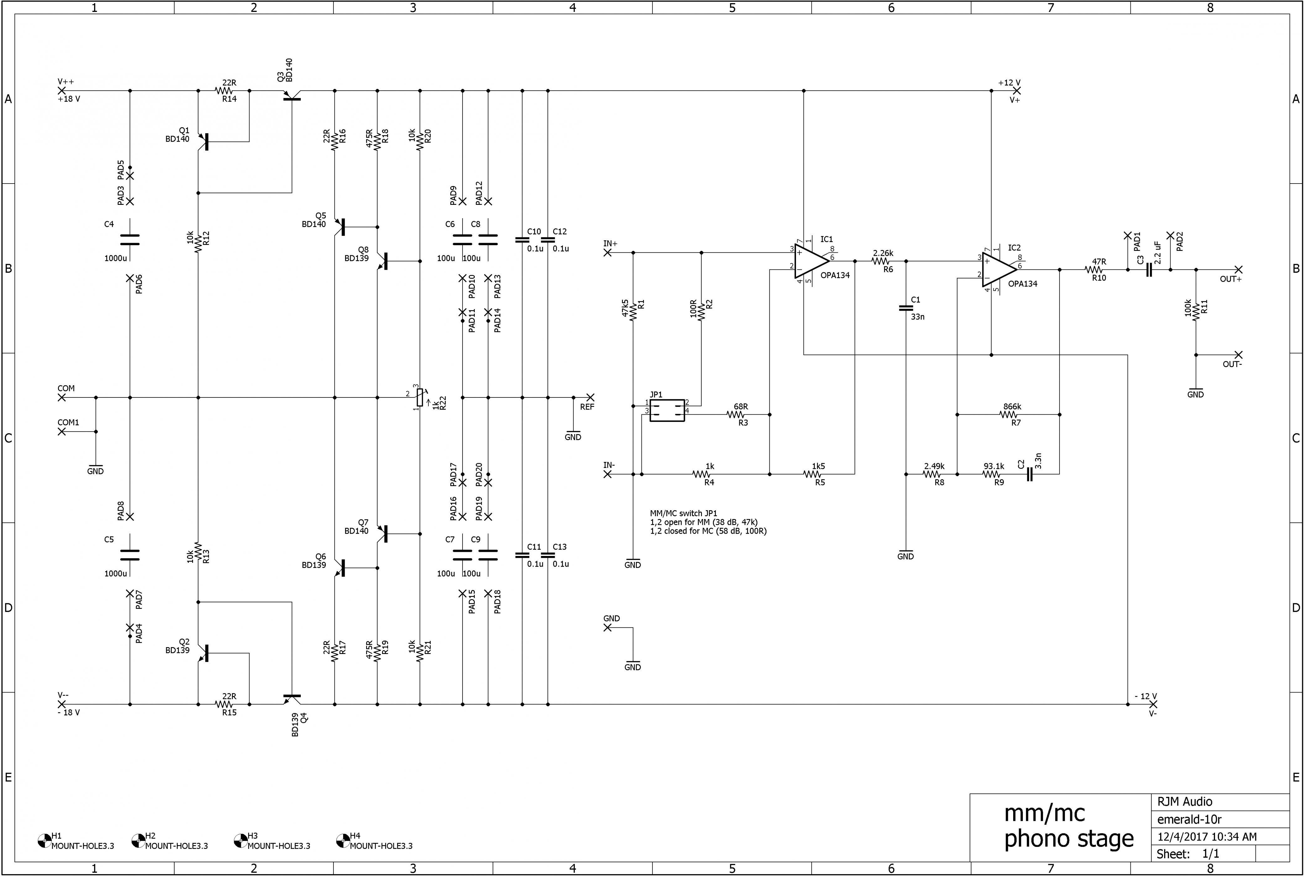

This is my yearly "where are we going with RJM Audio" post. Since the blogs aren't up yet, and it mostly pertains to the phono stages, I'm dropping it here.
The Emerald phono stage is looking good. It replaces the VSPS400 and arguably the Phonoclone4, pending some critical listening tests.
The boards have been refined since the evaluation 10c. Primary change is to add support for Nichicon FG electrolytic capacitors, though some additional efforts on the silkscreen layer make the build more logical and hopefully easier to understand (i.e. less likely to mess up).

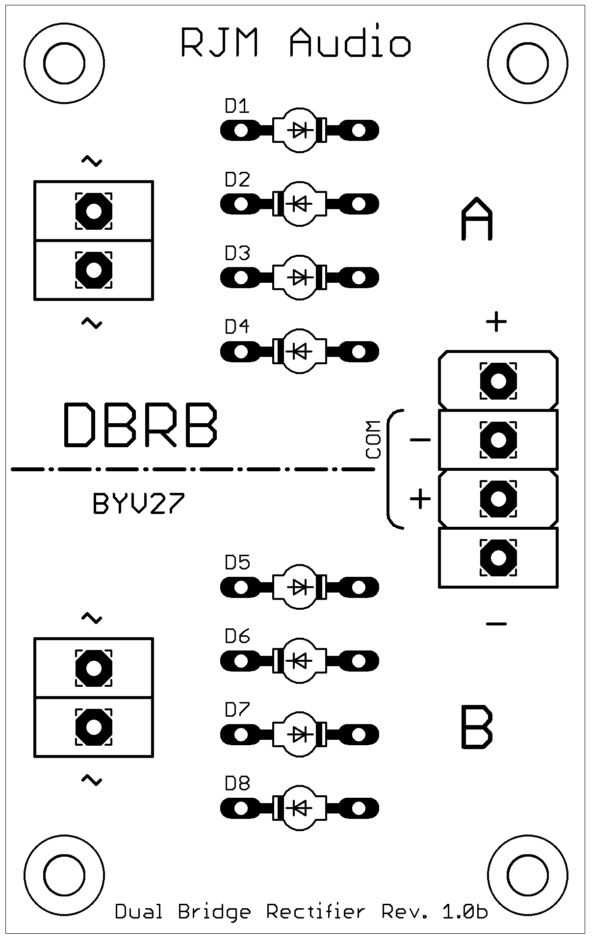

In addition - with the view to make the whole thing a "turnkey" project - two additional, optional boards are going to be linked with the phono stage. The first is the "Switchboard", which expands the cartridge loading options to up to six more resistors or capacitors, and combinations thereof. The second is the "DBRB", or Dual Bridge Rectifier Board. Nothing special with that, it's just a convenient holder for 8 BYV ultrafast recovery diodes for people who don't want to use chassis-mount bridges.
Comments and requests welcome. These are final-review stage, meaning they are ready for fabrication but I haven't sent them yet so I can still add small things.

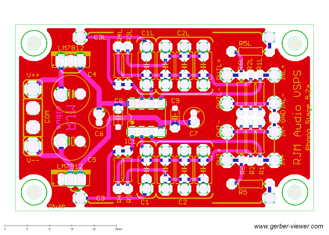

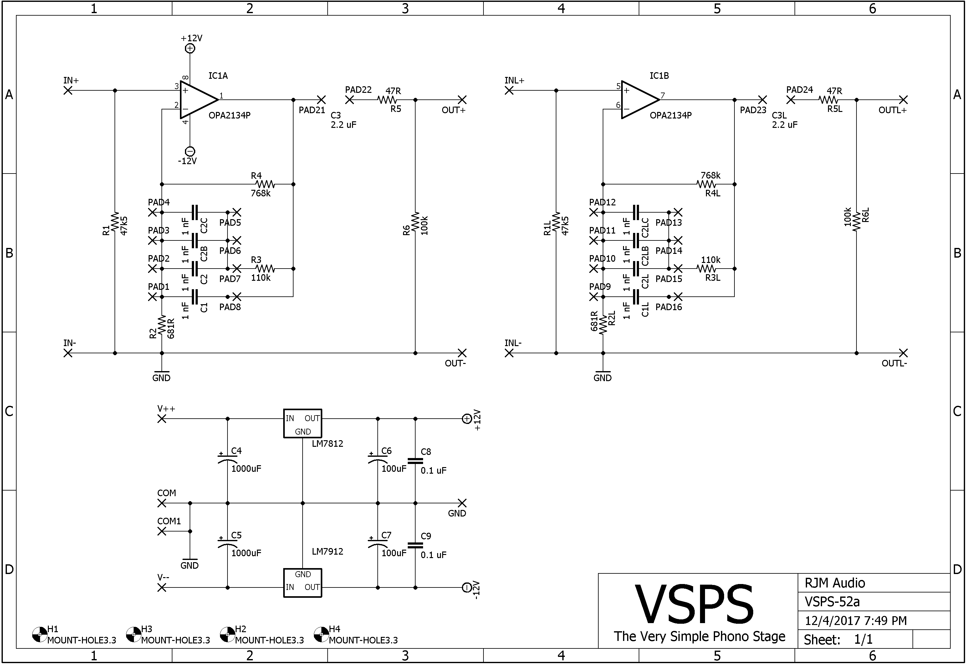

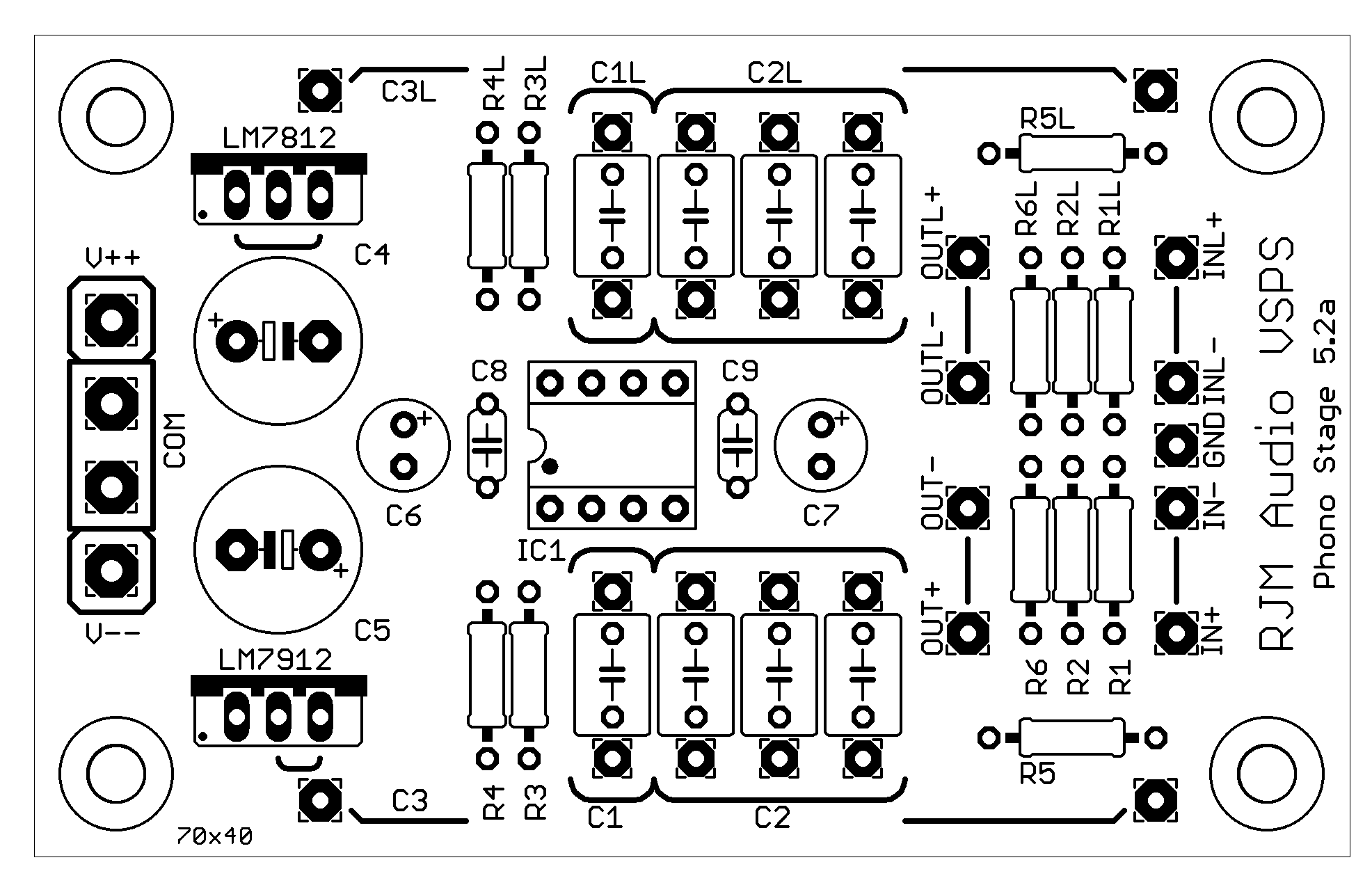

Stereo VSPS rev. 5.2a
Almost the same as the previous 5.1 update, but I fixed the board size to 80x50mm exact and standardized the mounting hole dimensions to metric likeh the rest of the recent boards.

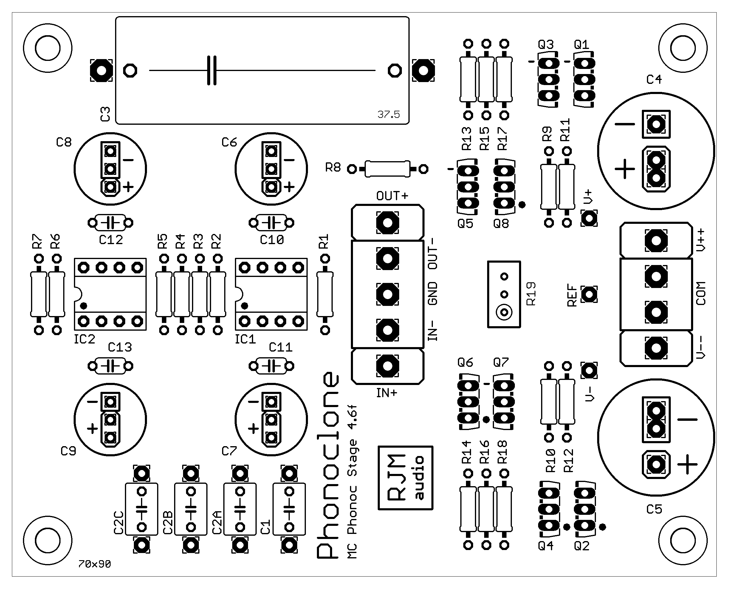

Stereo VSPS, Phonoclone, Emerald, Sapphire, S-Reg, and DBRB will be updated to the versions shown above soon. I've already placed the order for the Stereo VSPS, Phonoclone, Emerald, and DBRB boards.
Mainly because I wanted to order the Emerald, the rest were all minor revisions. The Stereo VSPS changes the RIAA to drop the 4th time constant, the new Phonoclone brings compatibility with larger capacitors. Otherwise it's just cosmetic changes from the previous versions.

I've attached the Emerald BOM here, though it's already uploaded to the website. There's a worksheet which lets you experiment with resistor values R1-5, for customized load and gain options.

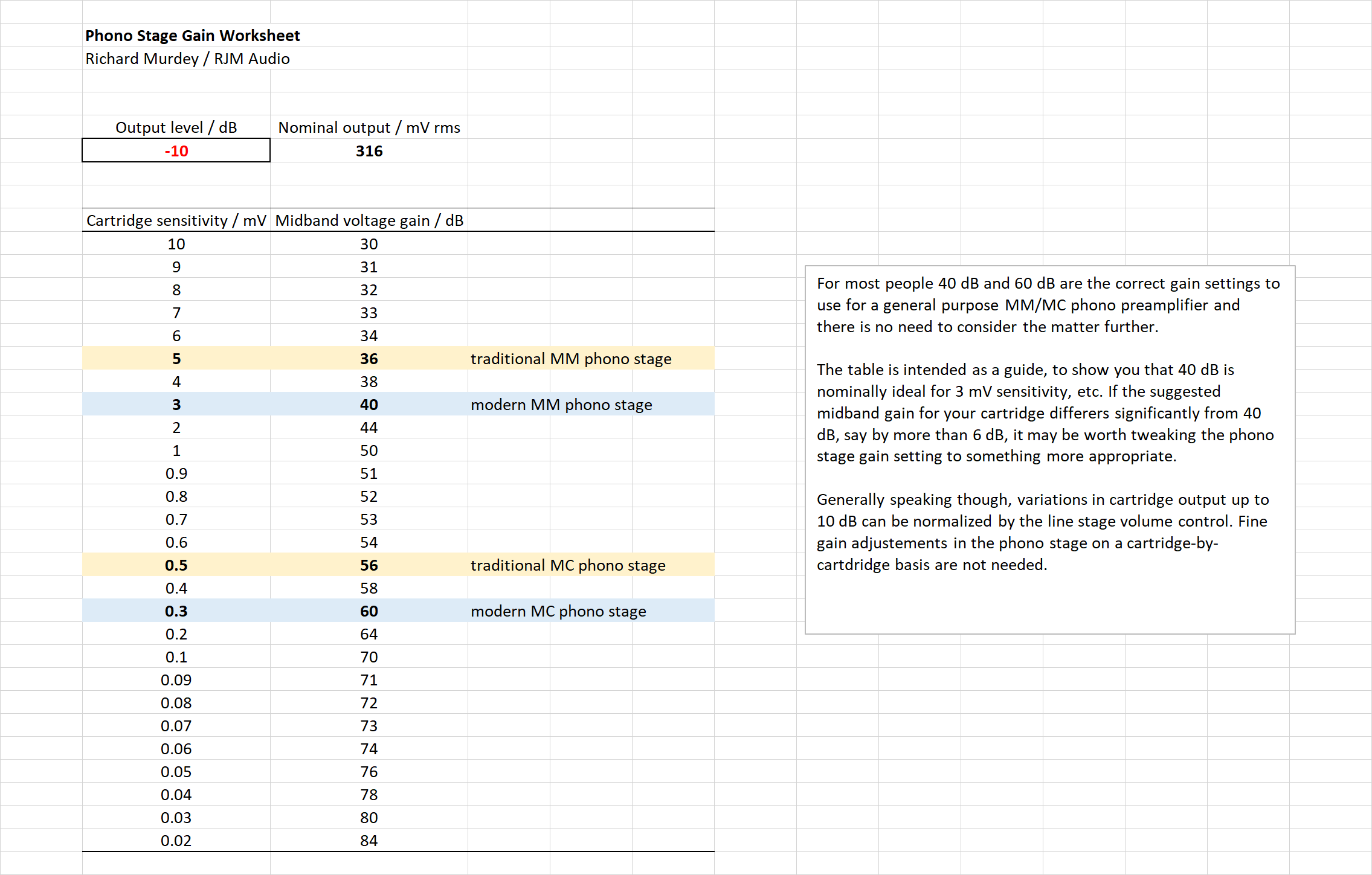

1. To keep 47.5k load, JP1-1 is left open, while closing JP1-2 will increase the gain to 60 dB in stock configuration. The high gain setting would bring a 2.2 mV cartridge to 2.2 V, which is close to your stated goal. You can change R3 to 150 to reduce the high gain output to 52 dB, giving an output closer to 1 V and leaving the low gain setting unchanged, or you can change R4 to 150 ohms to increase the low gain setting to 52 dB, leaving the high gain about 60 dB.
Actually though, what you really want is 46 dB and an output level of about 300 mV.
.deep breath.
2. The sensitivity of a cartridge in mV does not follow the same standard as the line level output of a CD player. Multiplying a cartridge with an listed sensitivity of 1 mV to 1 V rms (0 dB) line level standard doesn't mean the sound level will be the same as a CD player. Consumer audio line level is closer to -10 dB, and 300 mV is closer to the number you want to "hit" when multiplying the cartridge sensitivity by the phono stage midband gain. The traditional phono stage gains of 36 dB MM and 56 dB MC give the correct output with "typical" cartridge sensitivity of 5 mV and 0.5 mV respectively. The B&O is only 6 dB lower than typical MM. In my experience it's not worth worrying about 6 dB one way or another in a phono stage. That level of difference is easily mopped up by your preamp's volume control. To the ear the difference in signal loudness is not especially great. Indeed that's the general thinking in preamp design: 36 dB covers 2.5-10 mV range of MM sensitivities, 56 dB covers 0.25-1 mV. B&O is just in the middle ground where, if these things bothered you, you might find yourself wanting about 46 dB. If you were building the Emerald specifically for this cart, maybe set it up to have "MM-LO" 36 dB and "MM-HI" 46 dB gain positions [R3 475 ohms, R4 1.5k]]. That would give 440 mV with your B&O and a similar output level with MM carts hovering around 5 mV. As a bonus, the MM-HI setting would also be good with high output MC which often hover around 1-2 mV output.
I'd also set R2 to 1k, so the loading options were 47k5 and 1k.

This hopefully gives a better idea of the numbers involved.
People do seem to want to overthink this, making a problem out of something which really isn't one. Just build your phono stage 40 dB (MM) and 60 dB (MC) ballpark figures, and you'll be good to go.
I recommend the vinyl engine cartridge database for lookup info.
As far as I can see only a few "problem" cartridges exist in the grey area around 1.0 mV lying about mid way between MM and MC centerpoints. Examples include the Benz Micro Glider, some of the high end Grados, and one or two models from Roksan and Van den Hul. A similar number of cartridges fall into the "ultra low output" class 0.10 mV and below, where a gain higher than 60 dB could be rationalized. Audio Note, some Denon, Benz again, and Fidelity Research. Taking the grand prize is the Ortofon MC 10 mkII at 0.024 mV and few similar 0.05 mV and below which would indeed require a special setup.
The difference in gain between traditional and modern circuits is a combination of average cartridges outputs getting smaller over the years, the increased availability of cheap op amps with low noise and high voltage gain, and the increase in standard line level outputs coinciding with the introduction of digital audio.
