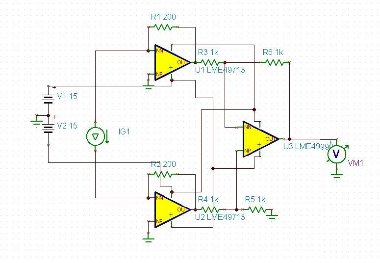

I doubt LME49713 is stable with 200 ohm Rf. It's a CFA and datasheet recommends 1.2K.
OK, thanks for that. I will investigate.

If the op amp U1 swings 21ma pp, how the -6.2ma are enough to keep it in class A?
Dont forget that U1 has to feed R4 (570ohm) plus the dac output current.

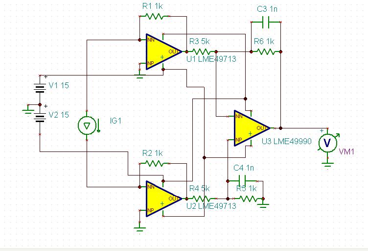

OK, this is where I'm at tonight. I found out that I can't use a bypass capacitor around the feedback resistor for the CFB opamps. Since the minimum feedback resistor is around 1.2K, there is way too much gain, so I had to make a voltage divider with the 5k/1k resistor pairs around the output opamp. This is wasteful but don't know what else to do. Distortion is not that great @ 0.001% with 2.21Vrms out put. Maybe I should just replace the output opamp with a step down transformer...
counter culture;3146337 said:I did the arithmetic
If you did the arithmetic. Can you tell us the current swing in U3 output.
I get +1.2mA to –12.3mA and this make U3 work on class b.

OK, I just did a little experiment to find out if the "virtual ground" of the TI circuit with the NE5534 was lower or higher than the same circuit with the CFB LME49713 opamp. Obviously, the value of the feedback resistor plays a big part in how close to zero the "virtual ground" really is. It turns out that with the same feedback resistor of 750 ohms, the LME49713 has half the input impedance of the NE5534 (0.004 vs 0.008 ohms). I don't know if this is a big deal.
Also, with regards to the feedback resistor limitation of the LME49713, I was wondering if it would still work ok with a much lower feedback resistor value if I included a buffer inside the feedback loop. I need to get the gain way down on that stage.

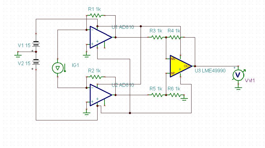

so I recommended AD810/811/812.
their datasheet have a lot of application information.
Yes you did, and I'm sorry I have not had the time to look at them yet. Thank you, I will when I have time.
OK, this one works good. It's not stellar, but it's a good performer. Since the AD810 is a video opamp, we have to be careful about layout in the real world.
Thanks for the tip!
For the real world, R3 and R5 need to be changed to 5k to reduce gain, just like the previous example. The good news is that S/N is very good (120dB+) and THD is very good too (0.0002% or so).
But, maybe this isn't any better than the TI circuit.... sigh.

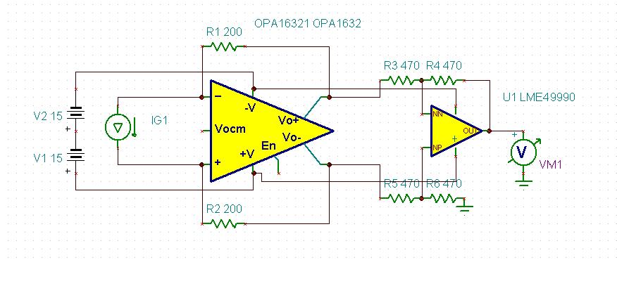

OK, this one measures very well in Tina spice. The inputs to the OPA1632 are not virtual grounds though, since they show 1.56Vrms for a source current of 7.8mA p-p. (it should be in the microvolt range)
But, if the DAC is OK with that, then distortion and noise are very low.
