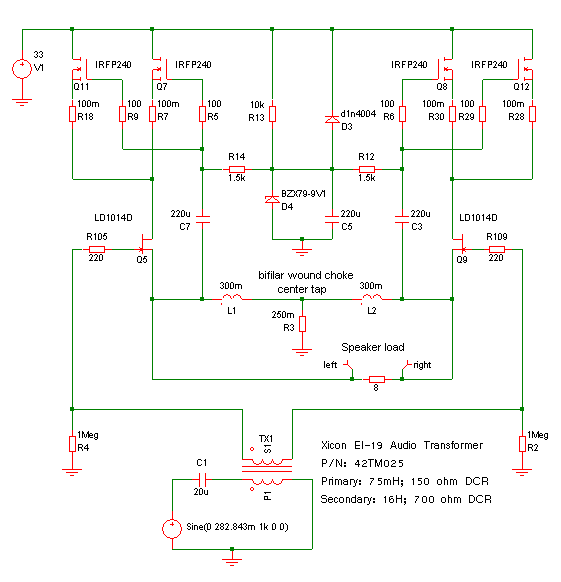

I'm playing with a super cheap input transformer on an differential source follower amp. I'm just stunned at the quality of sound I'm getting with such a simple input. The transformer gives the amp a gain of 4 (or so).
I've been in contact with Jensen Transformer and will be ordering a pair of their line stage 1 to 4 ratio transformers (listed as 4 to 1 but connected to my amp in reverse) for a greater attempt at audio nirvana.
This is such a simple experiment and one that paid off handsomely.

I'm glad that you realized distinction between balanced and symmetric , when using xformer :clown:
regarding sound ..... now you hear why I'm using xformer in stages after DAC's - great sense of continuum
( beat that explanation , if you can :rofl: )
and stunning dynamics and details , when impedances matched properly ;
regarding that - make sweep test ( varying from 20-20K ) and alter R2 and R4 to acheve flattest response

I've been in love with inductors ever since Nelson introduced us to ZV7-T. Of course, you know that, Choky. I've never forgotten to use the power inductor--but, using an input transformer, this is a first for me. Now, it seems like I'm going to stay here for a long while. I like the way the music sounds--quite lively. When you think of the cost to build a preamp, not to mention time, which I have less as the sands fall through life's hour-glass, it seems a logical path to journey. Good grief, this is fun.
I've been toying around with R2 and R4. The tech at Jensen Transformer suggested a load no greater than 1/10 of the transformer's output impedance. In the case of the little Xicon, the output impedance is 50,000 ohms, so 10 x 50,000 is 1/2 meg. I had 1 meg resistors on hand, so that's the route I went. I'll try to get a little closer to his suggestion. The sound seems pretty smooth, better than with the 10k resistors I began with. In fact, there's just no way this amp should sound good with such a cheap input transformer. I'm still scratching my head over that one. :)

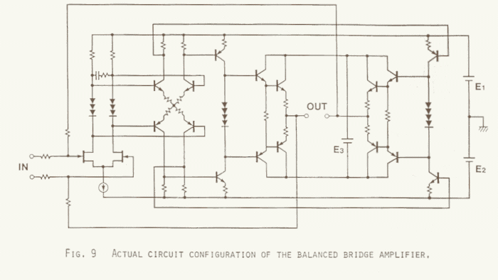

anyway - while I'm at keyboard - can anyone point me in right direction for more info about this Diamond ( I can't find it ......I remember that I saw it here , as sort of predecessor to Papa's SUSY ........ hitachi .... or someone else ? ) :
( edit : Jaccovitty is my hope - having memory as Elephant :clown: )
